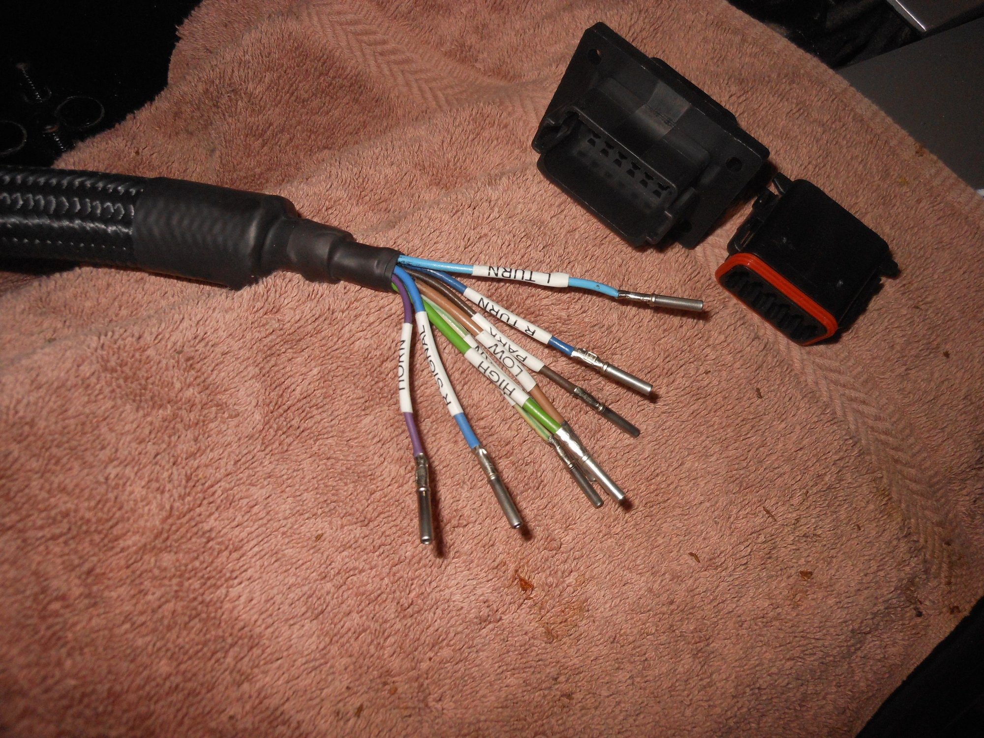

In fact this past weekend I replaced the harmonica connector with a Deutsch connectors- so I'm real familiar with those wires....

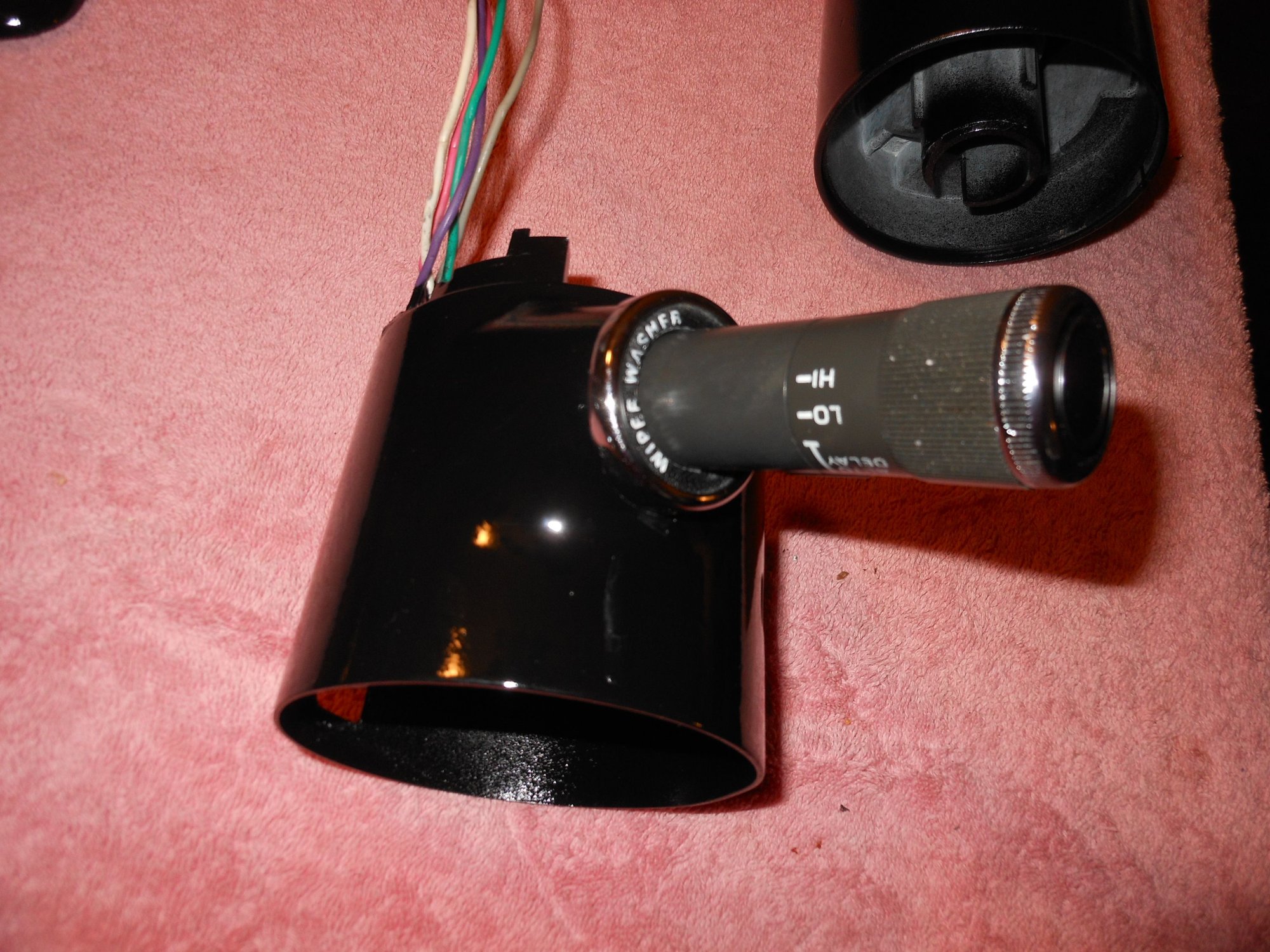

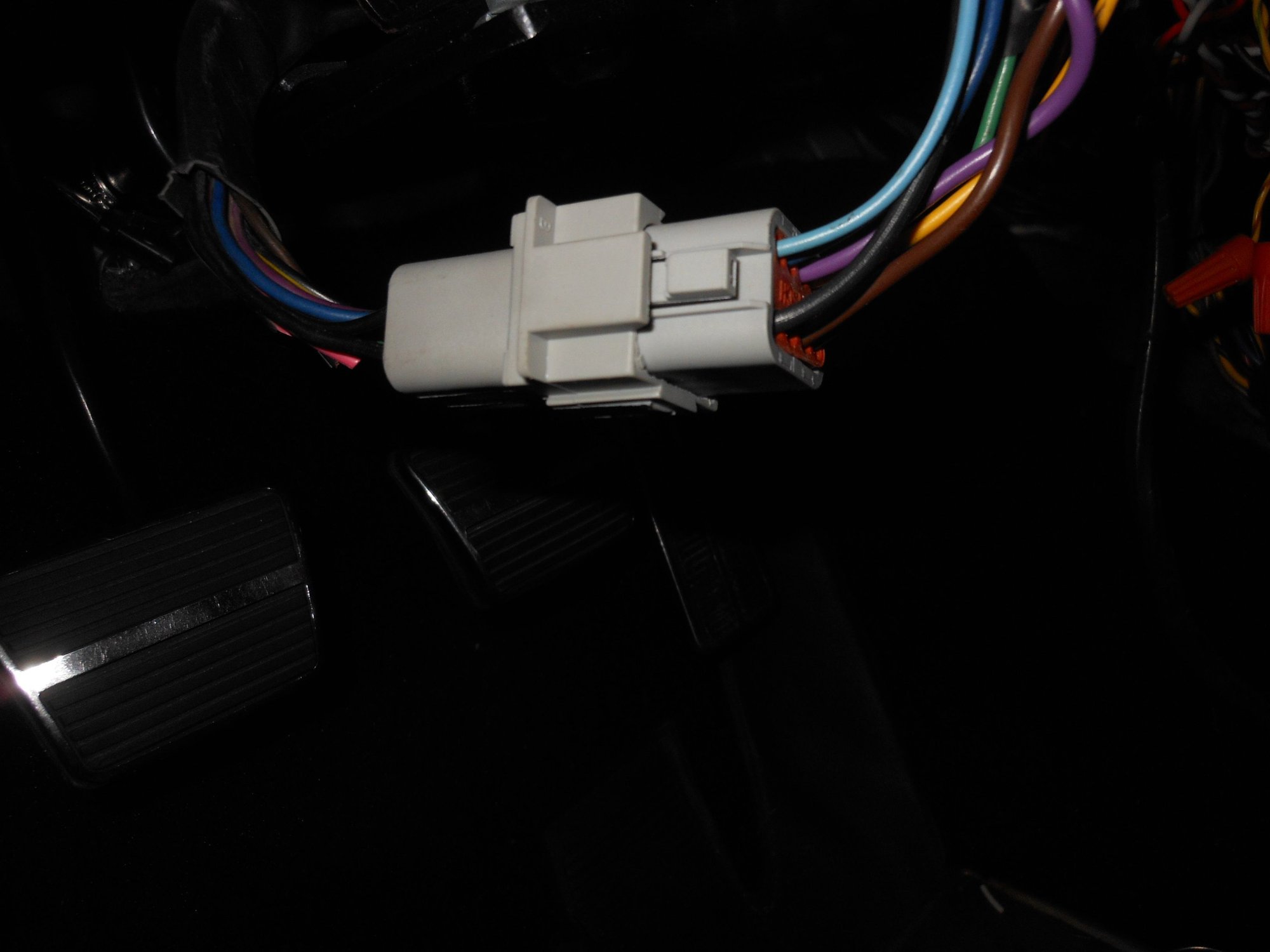

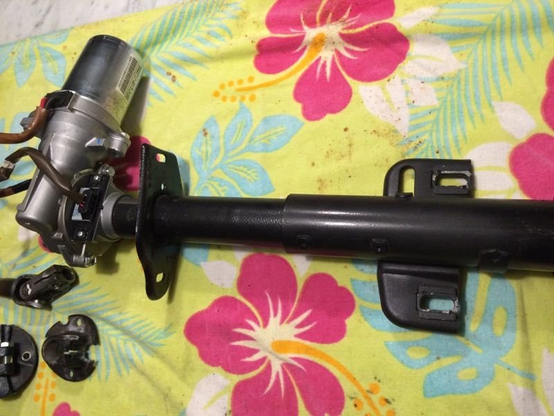

I modded the steering column quite a bit- took the ignition switch out and put the wiper controls in place- also converted it to electric power steering.
The deutsch connectors are simple to take apart- and super easy run inside the column adding the extra wires.
I'm using these through out my car-
