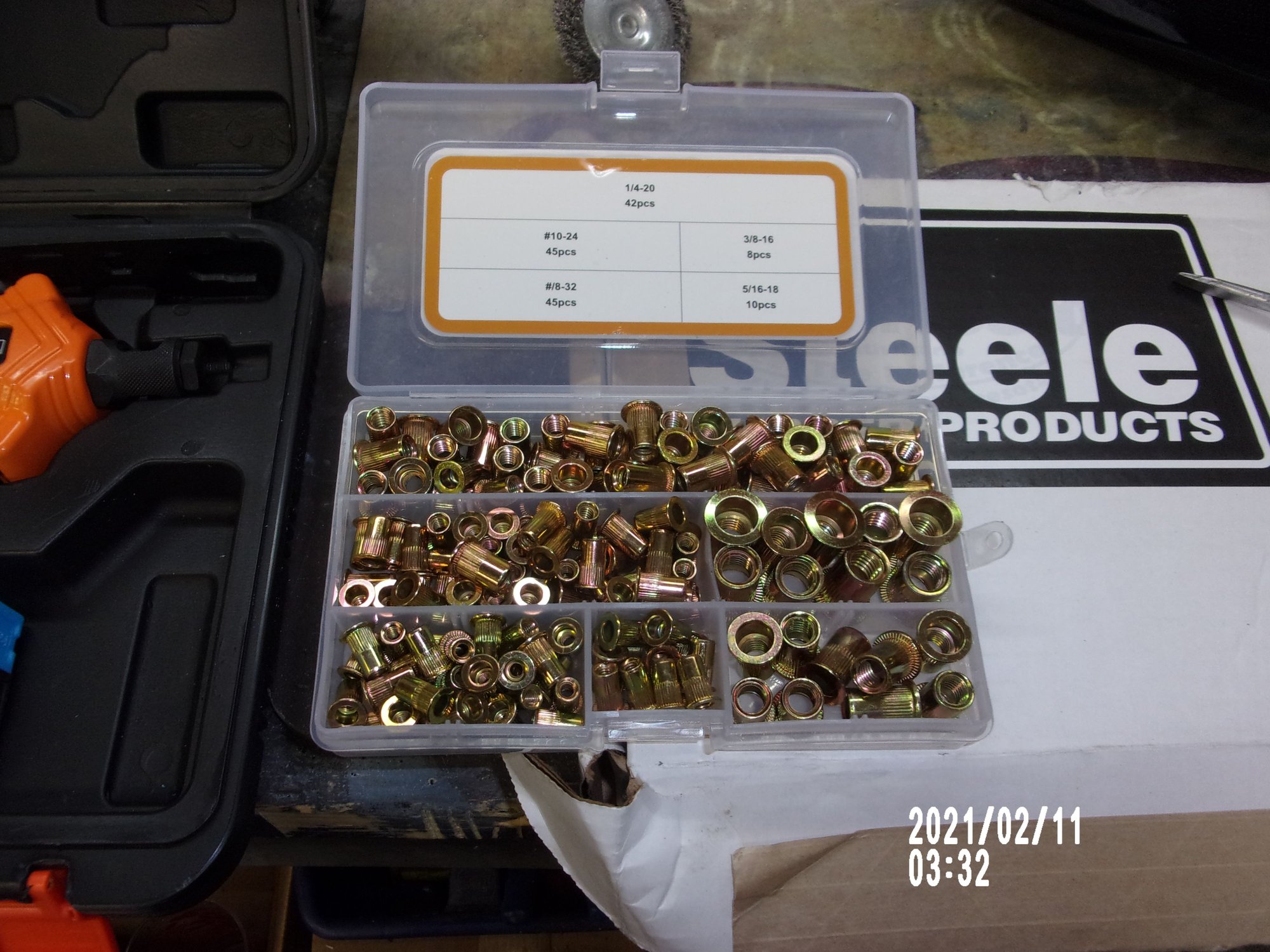

try this I just mine replaced one just drill the right size hole and works just like a rivet gun I bought this kit from amazon

I just fixed the screw holes just buy this tool at amazon and it works great

Very cool. I can think of a lot of uses for that. Thanks!
