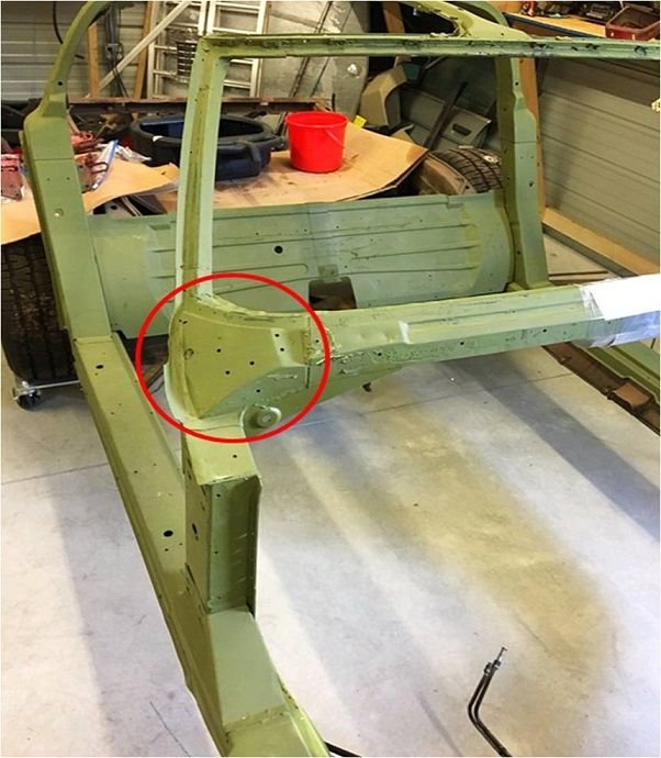

Back in the 80's & 90's it wasn't uncommon for some shops to insist on removing these corners to be able to insect the birdcage in this area. Typically when removing the windshield as part of a major repaint. I heard a few insist it was the only way to guarantee there would be no windshield leaks.
There are actually three separate layers of stamped sheet metal spot welded together in this area as part of the birdcage and I have seen rust through all three in some birdcages.
Good luck... GUSTO
