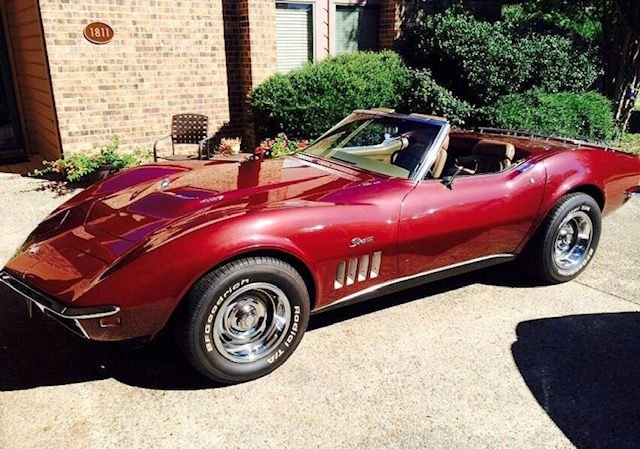

Here are a couple of pictures:

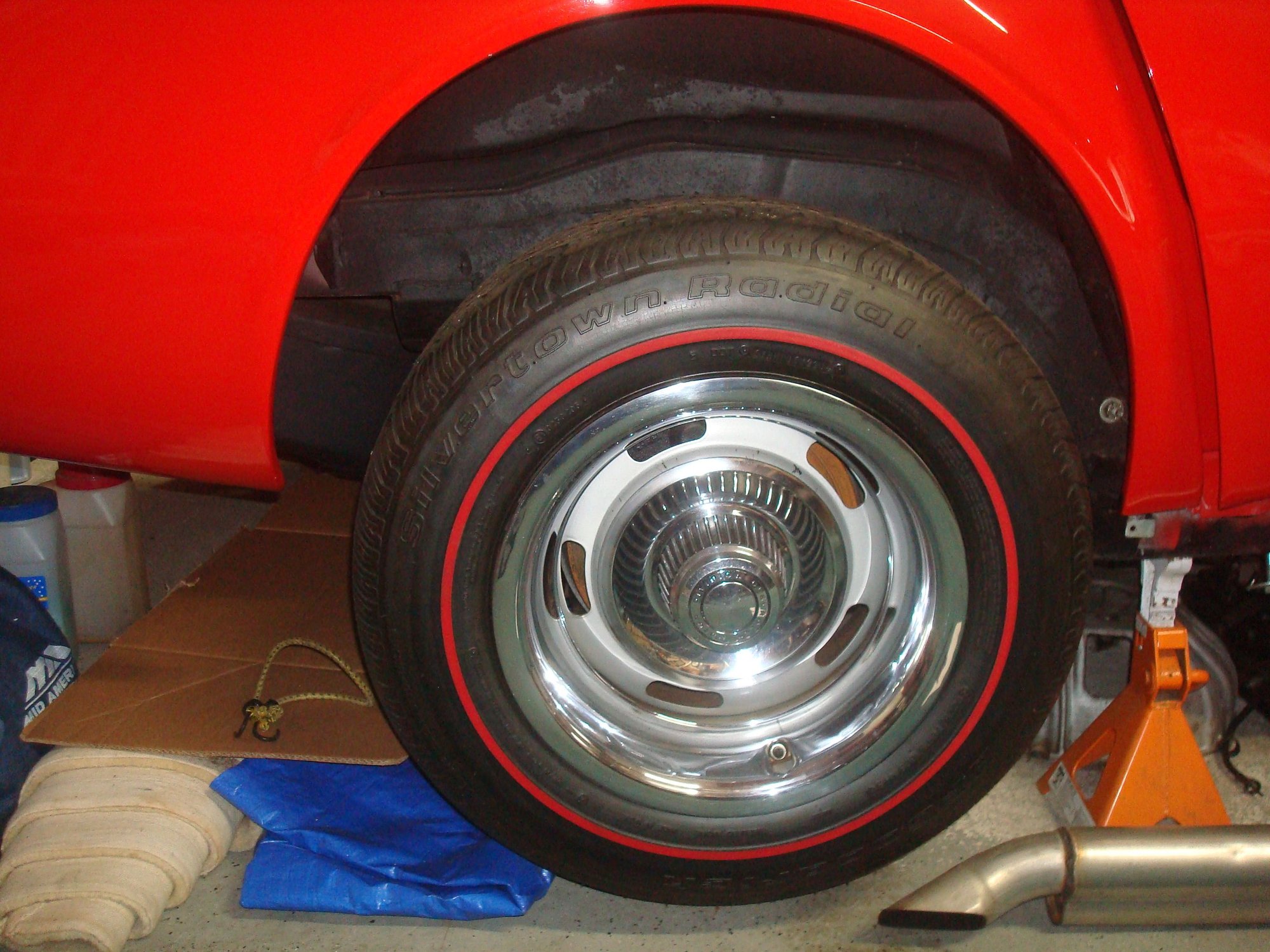

I have on BF GOODRICH SILVERTOWN 225/70R15 , you cant tell too well how they fit in wheel well , on my 69 , its up on jack stands but I think they look good .
