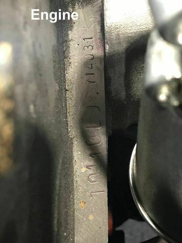

Engine stamp pad looks like an abomination on many fronts:

clone

This car has been covered a few times on this forum. The trim tag is fake also. The car is worth about $30k.

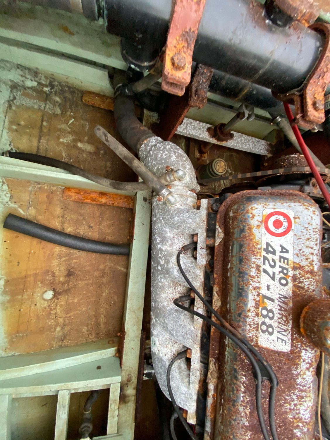

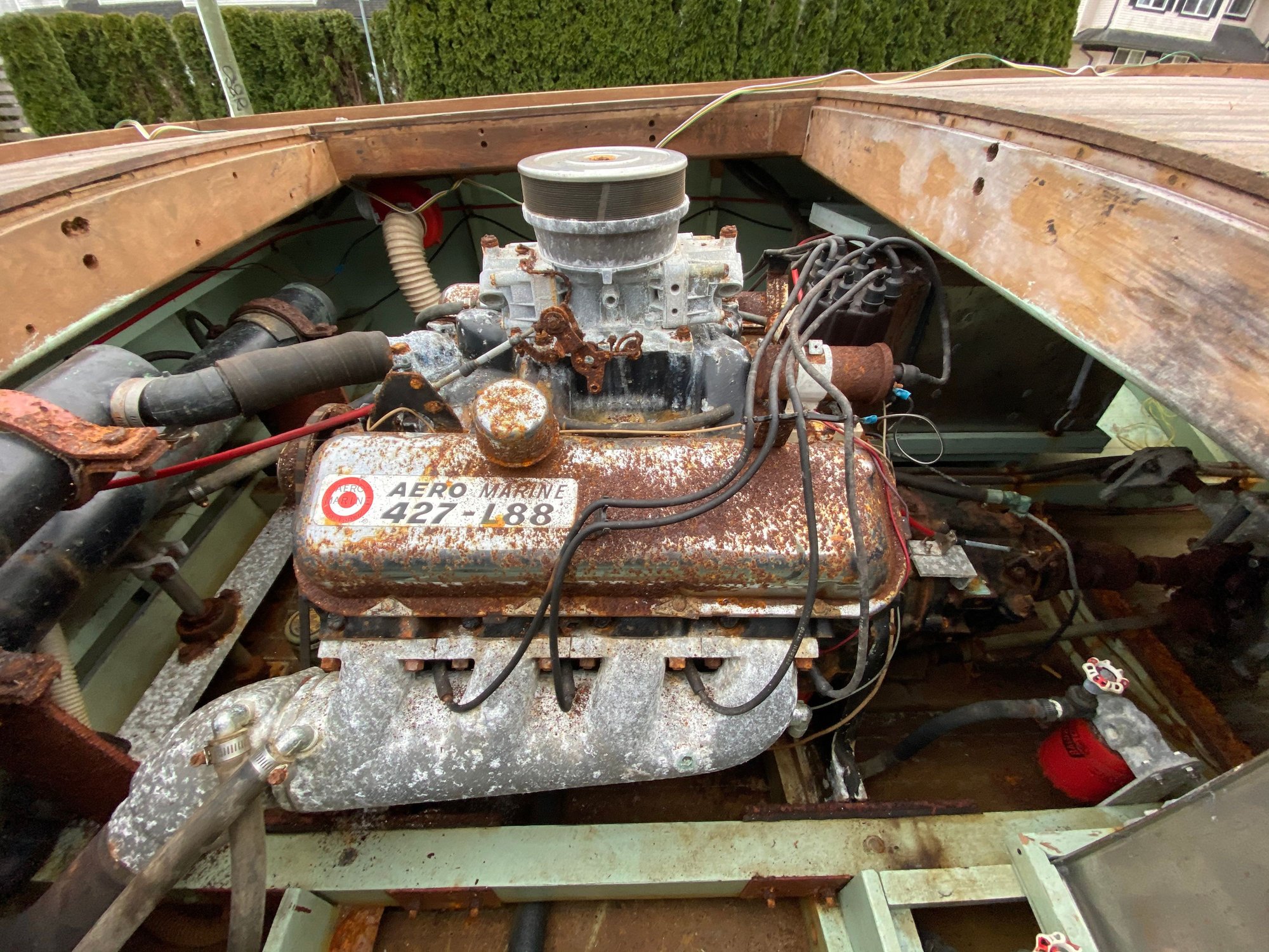

Just bought this boat from the original owner He ordered this L88 and never completed the project Been in hogs garage for over 50 years. Any thoughts. Thanks Tom
My thoughts? The L-88 is probably the worstengine you could put in a boat........way too peaky and aluminum Winters heads that will corrode worse than an anode after sitting a week.
Boats want a low torque and power peak......really no more than 5500rpm......the L-88 makes peak power at 6800 or so.....
That shutoff valve at the remote oil filter housing is special too.......wow.
Jebby

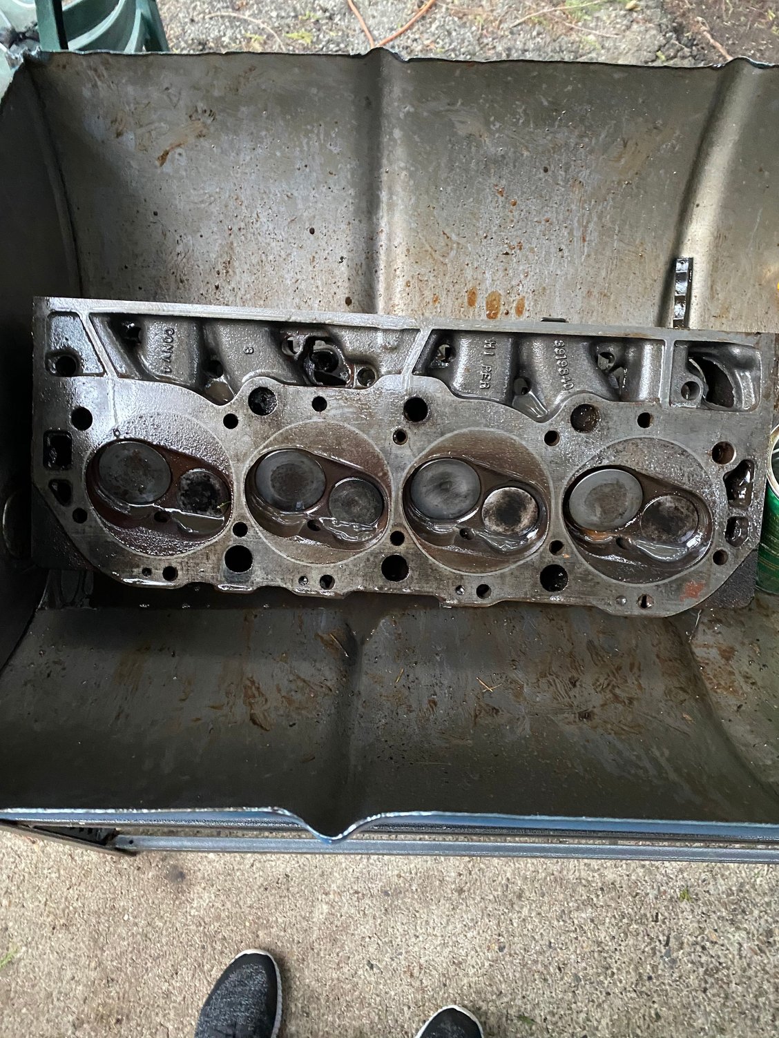

Dear Jebby before you make a smart *** comment about this motor; you might want to learn the difference between a remote fuel/ water separator filter and a “ remote oil filter” that you think it is. Wow ! Go to the library, find a nice colouring book about engines, read the words and follow the funny little drawings. Then come back to this site and give your valued option. Are you truly available”senior member” ? BTW After sitting for over 50 years ; here are some photos of the inside. I joined this site for helpful, encouraging advice. Much appreciated. Thanks.
very nice condition! Is that a drag boat? 427 would hit like ........................................ ...see ya!!
