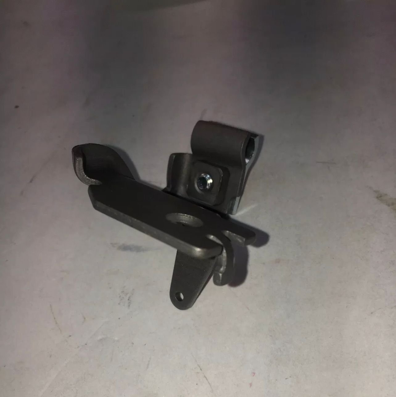

corvettemods part number 13512. It’s a repro part for all Holley carbs except the tri power.
basically if you replace your quadrajet with a Holley four barrel this bracket is the way to go. I believe they may also sell a kit with the spring included.
I had been fighting with mine and I didn’t want the larger lokar or other units that take up space under the cleaner and then I found this. It actually fits into notch on the throttle body. Easy peasy.

youre running an aftermarket throttle cable though correct? My suggestion is the least invasive option. If you’re using the stock throttle cable and want to switch to the 4150/4160 then this bracket is the easiest route.
yours is pretty though. Like it!! And it is pretty minimal compared to others I have seen.
