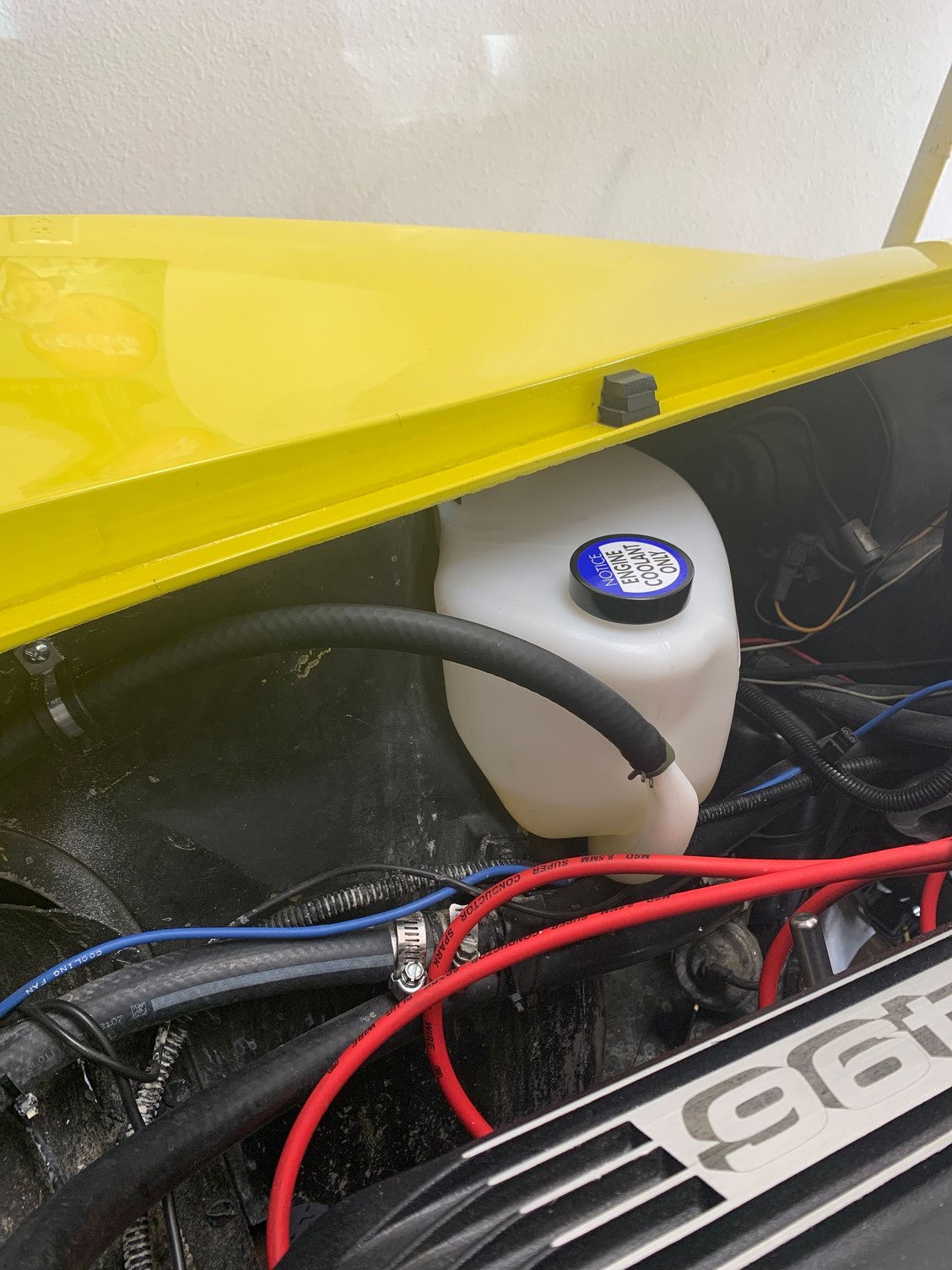

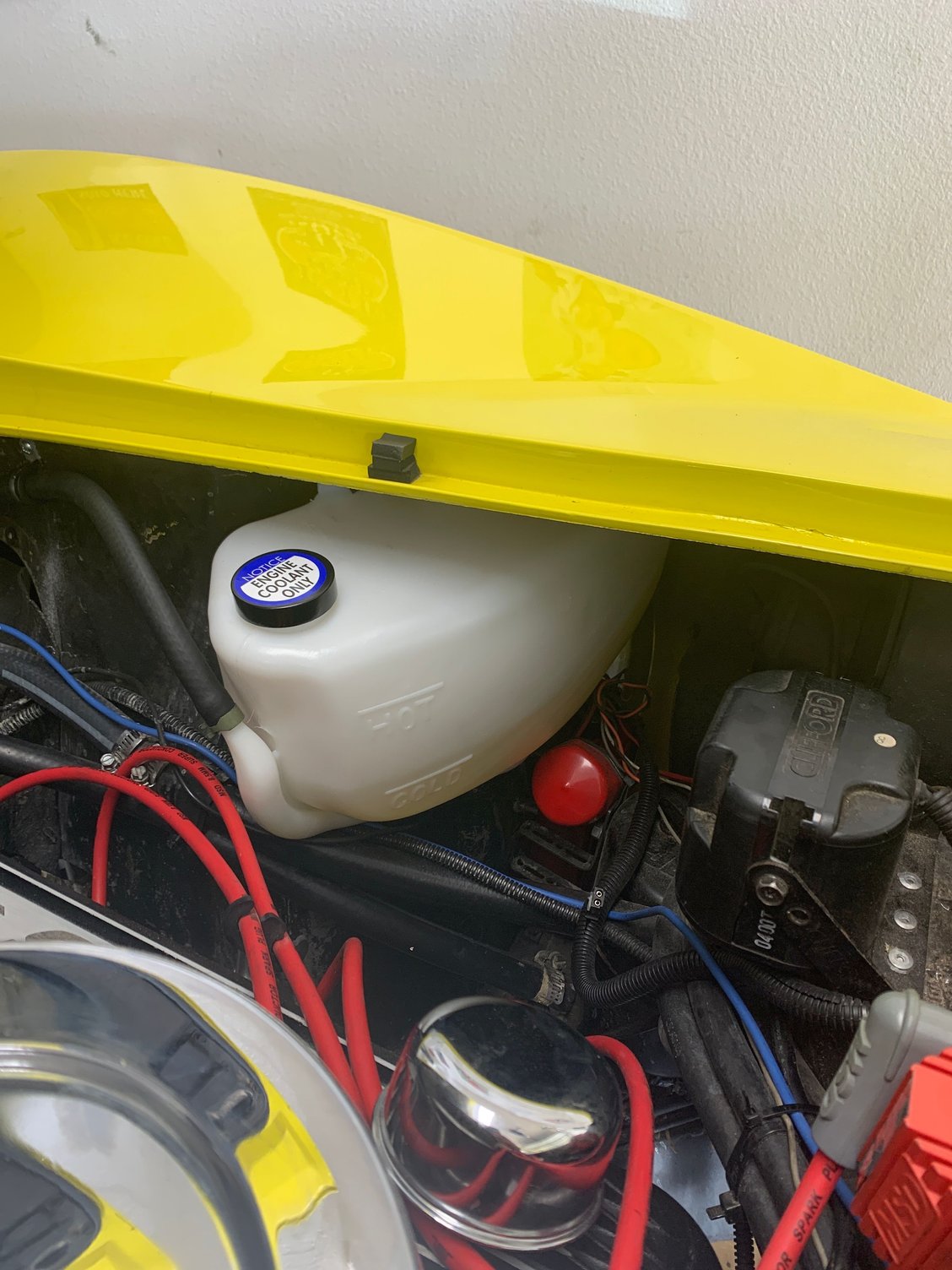

Here is my new install with the late C3 tank. Very clean. Also fits the curve of the fender. There is an MSD6 box and vacuum canister under there as well.

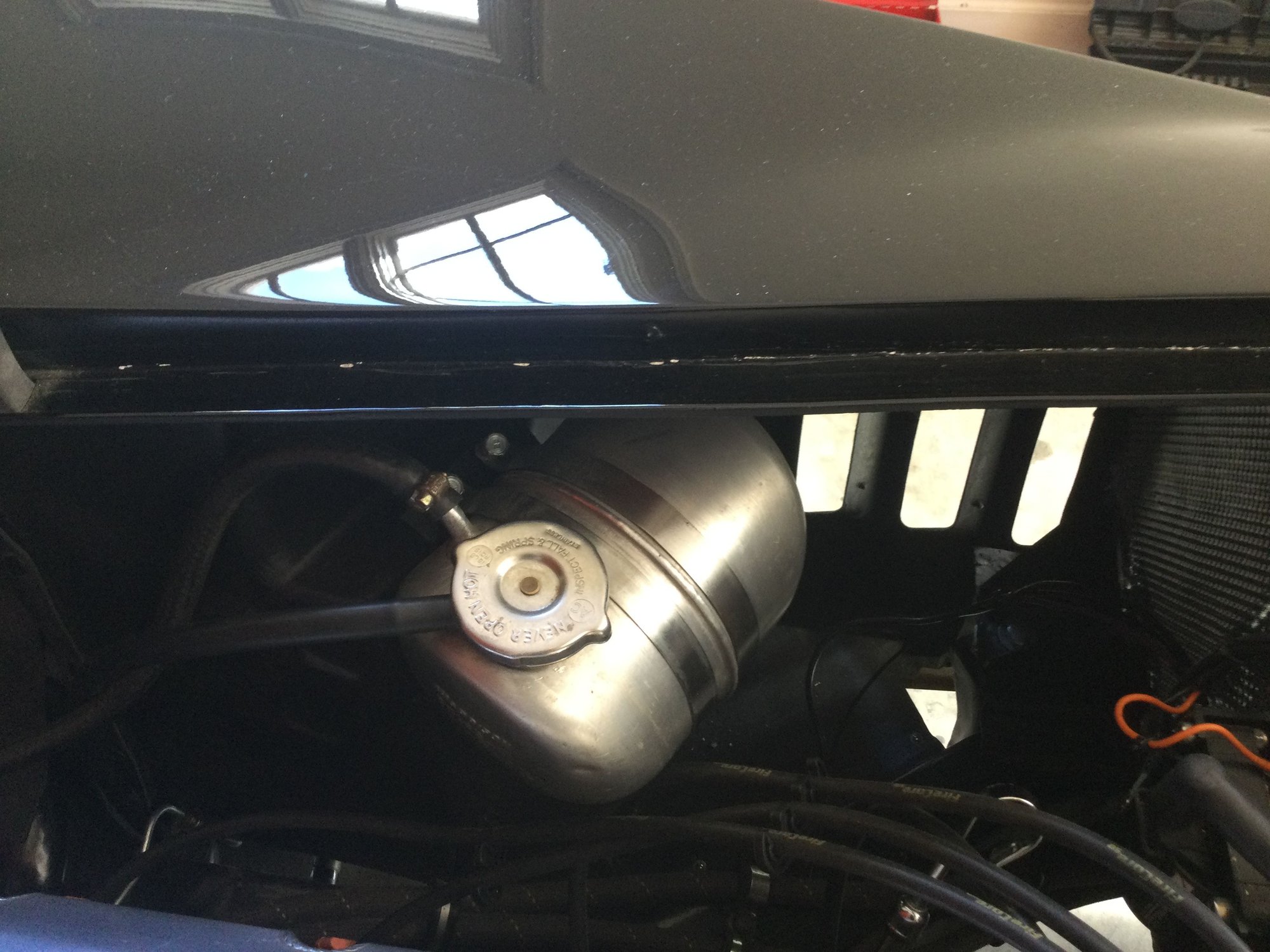

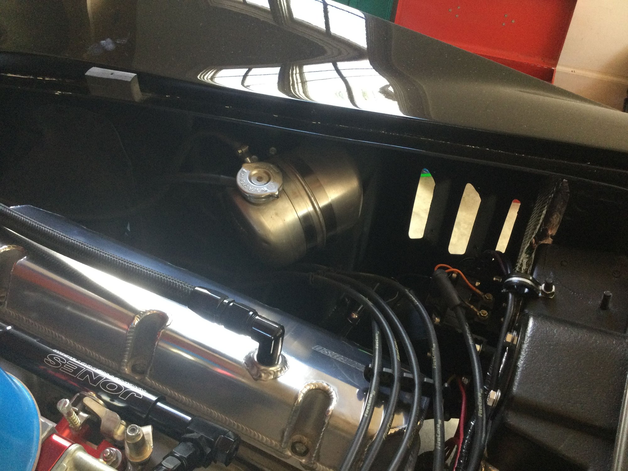

Do you have any photos of yours mounted?
Old Feb 22, 2021 | 01:32 PM
69ttop502's Avatar
69ttop502
Posts: 6,240
Likes: 1,013
From: Watkinsville, GA and Glen Cove, NY
I wouldn’t be surprised if the flat on the inner fender to mount it is there on your 73. All the vendors carrry the mounting bracket that is riveted, or in my case, bolted, to the inner fender.
Old Feb 22, 2021 | 02:50 PM
OldCarBum's Avatar
OldCarBum
Posts: 14,406
Likes: 8,212
From: Napa Valley California
Thanks for the photos!
Just what I wanted.
I called DeWitts Radiator and they are going to manufacture a 68-72 surge tank for me without the radiator hose nipples coming off the bottom of the tank.
John at DeWitts said it will function like the overflow tank on my 73.
It’s always great working with DeWitts.
I’m calling Corvette Central now to order the mounting straps and bracket.
Thanks again.
