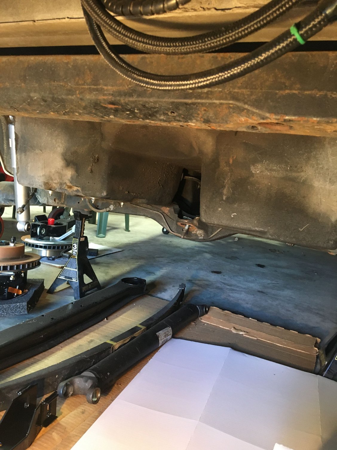

Default attached pics
Cut here
2-1/2" vs 3" halfshafts
Just to clarify, no, the halfshafts are not "Made in Taiwan"

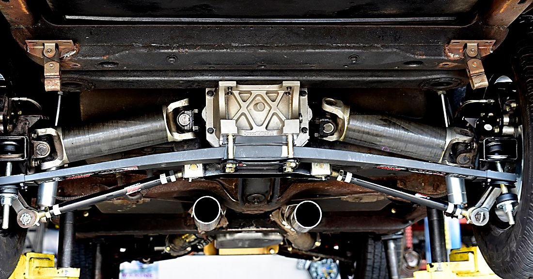

You don't have to cut anything. I have 3.5" diameter carbon fiber half shafts which fit easily.
Pic........

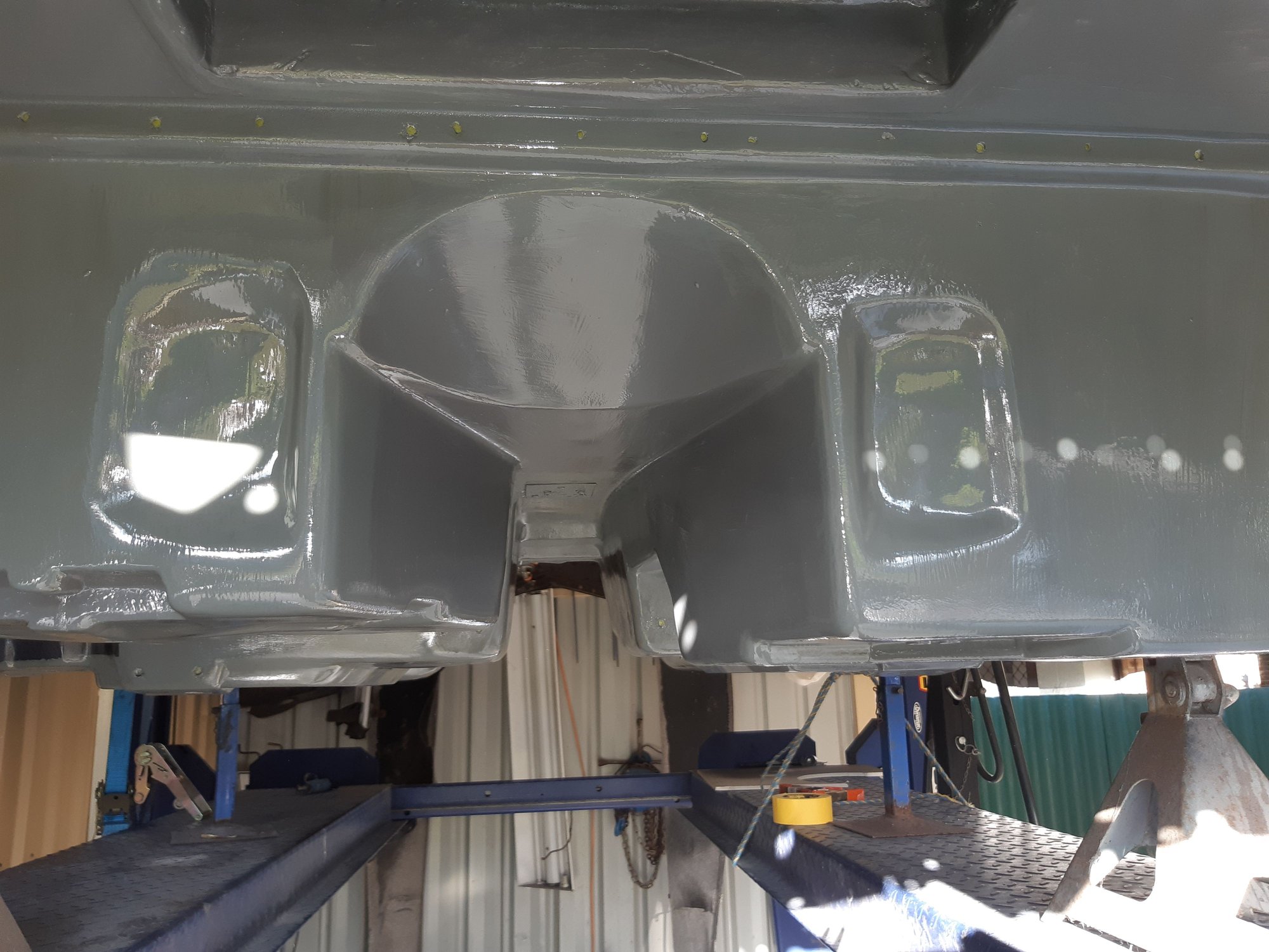

Originally Posted by GTR1999
Bill
It's just Tom's 1480 axles with the large flanges that hit the boxes. The stock shafts will not be a problem.
This is what i had to do for the 1480 axles.

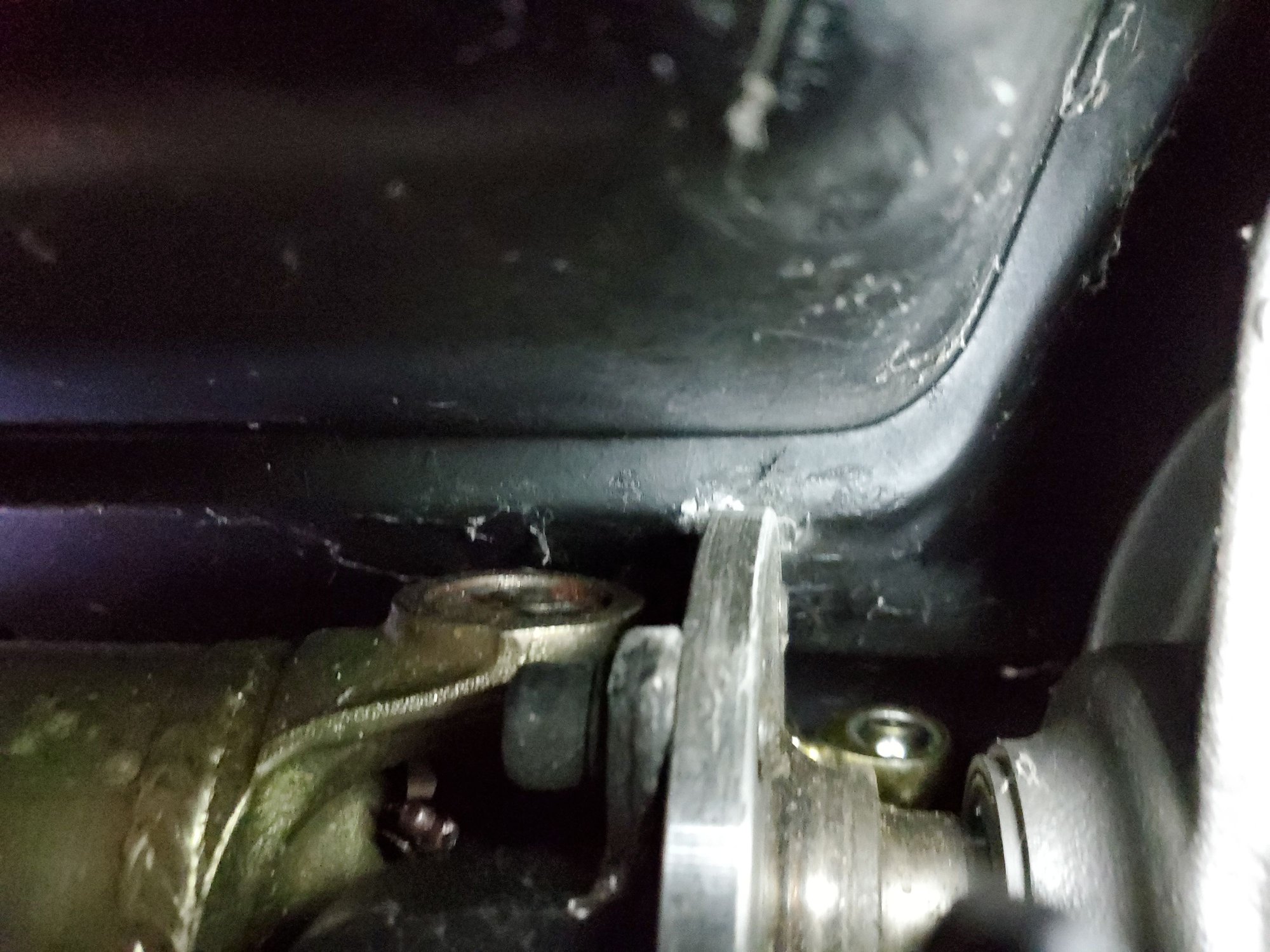

Tom's flange hit the compartments on my '65.

That appears to be a 1480 axle- large diameter, single bolt pattern. Still I this is the first time I heard of a box issue with a c2. Do you have a finished picture? Is that a complete 1480 12 bolt set up?
That sure is pretty!!!

"Sweet, what RWHP ? More than me I'm sure"......
Haven't had the car chassis dynoed with this engine yet. Engine dynoed 686 HP, 610 TQ. I'm estimating around 500 rwhp or so.

It barely rubs on both sides.
It is a complete Tom's 1480 setup wheel to wheel.

Thanks I built plenty of 1480 12 bolts for c2 but none ever hit that I was aware of. It looks like you stayed with zerk 1480 joints, I used to have Tom pull those out and I went with solids.
