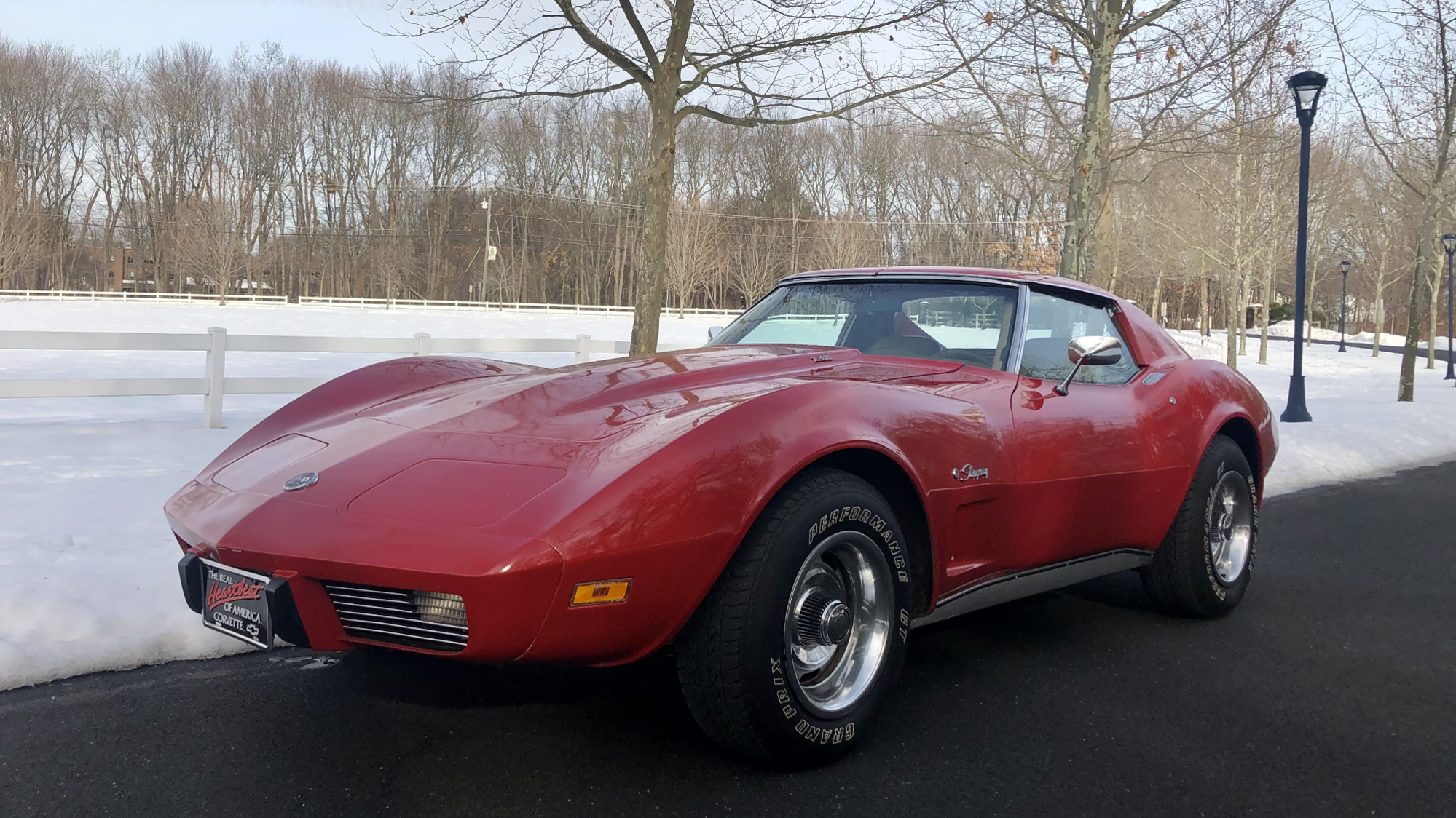

Default 76

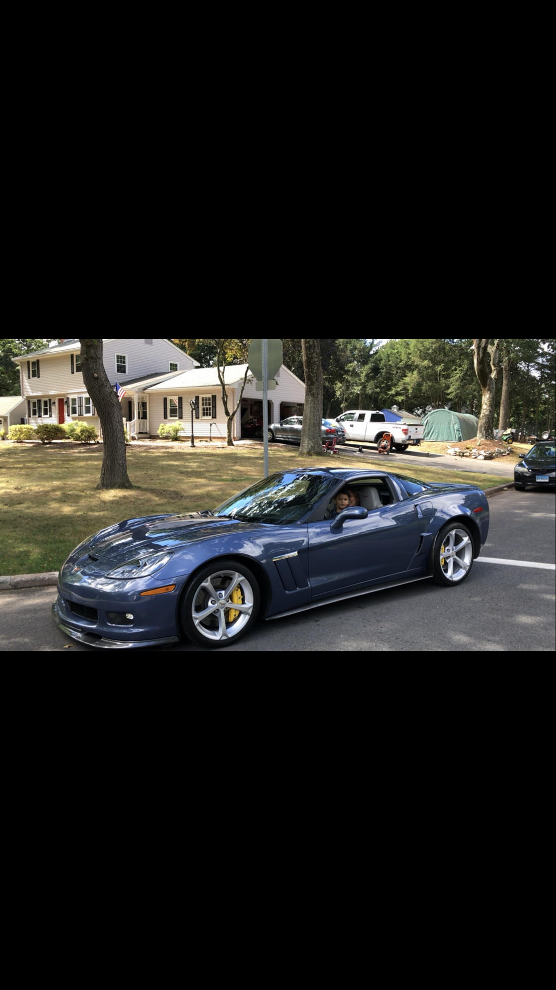

My 13
the 76 gets all the attention these days
