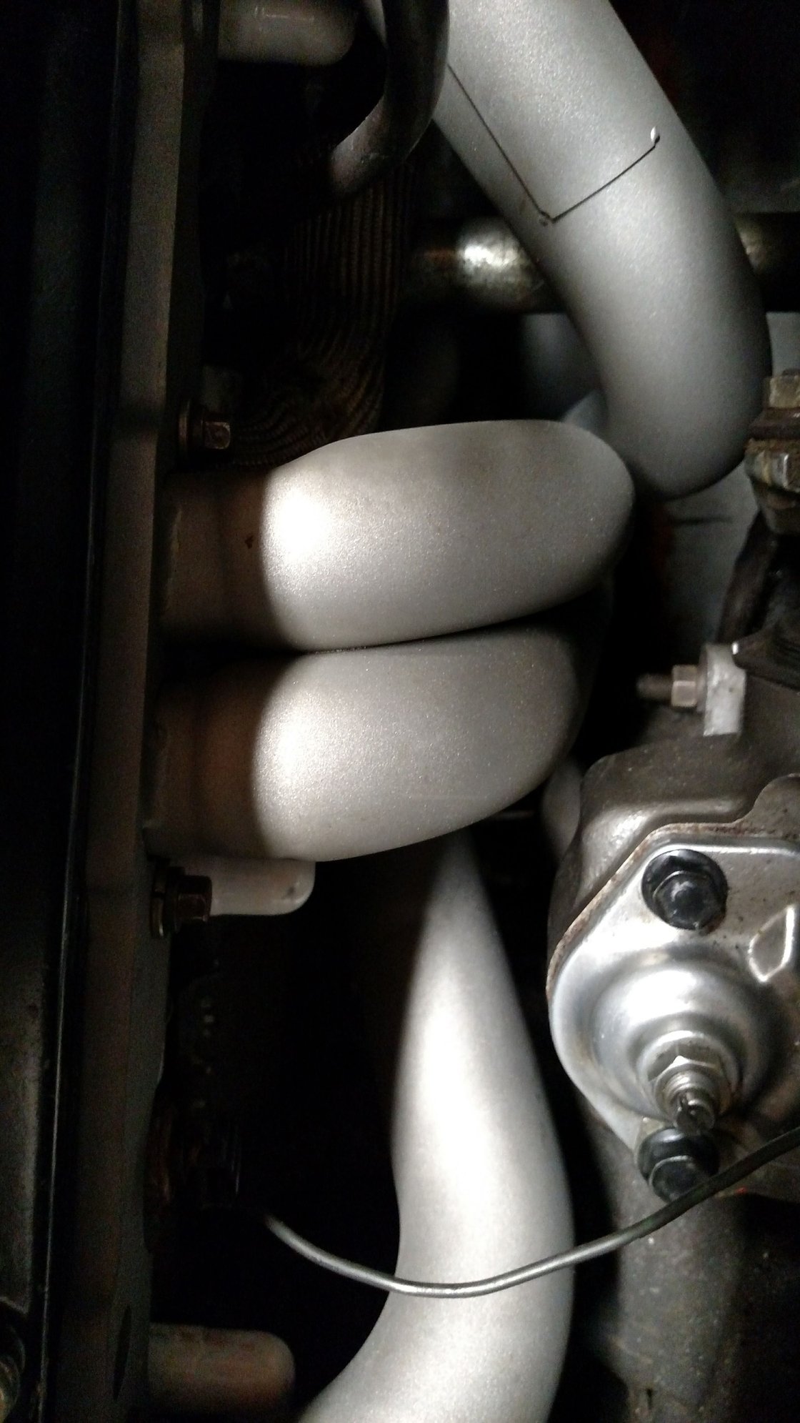

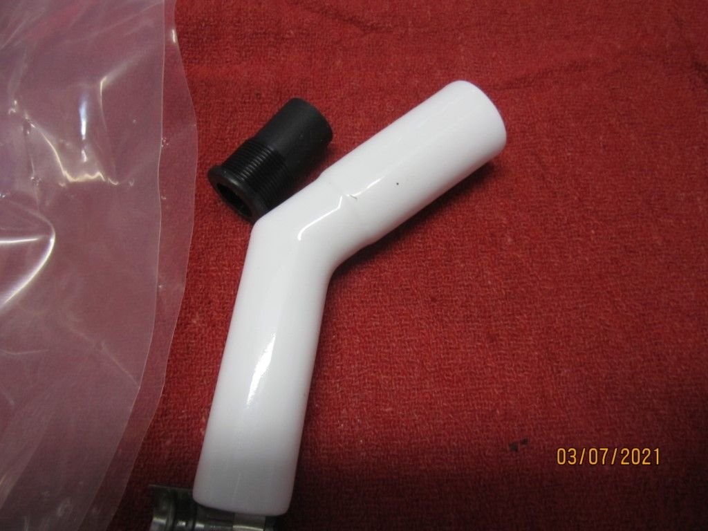

Same problem here years ago and went with ceramic boots...problem solved...would a 90 degree ceramic boot fit instead of that 45 degree in the pic? These are XS Power LTH 1 7/8 inch primaries on a 355 SBC L-82 motor.....

I could only get the 90 degree on if it pointed more or less down/back which made the wiring have a weird loop but that might just be on my McJacks
