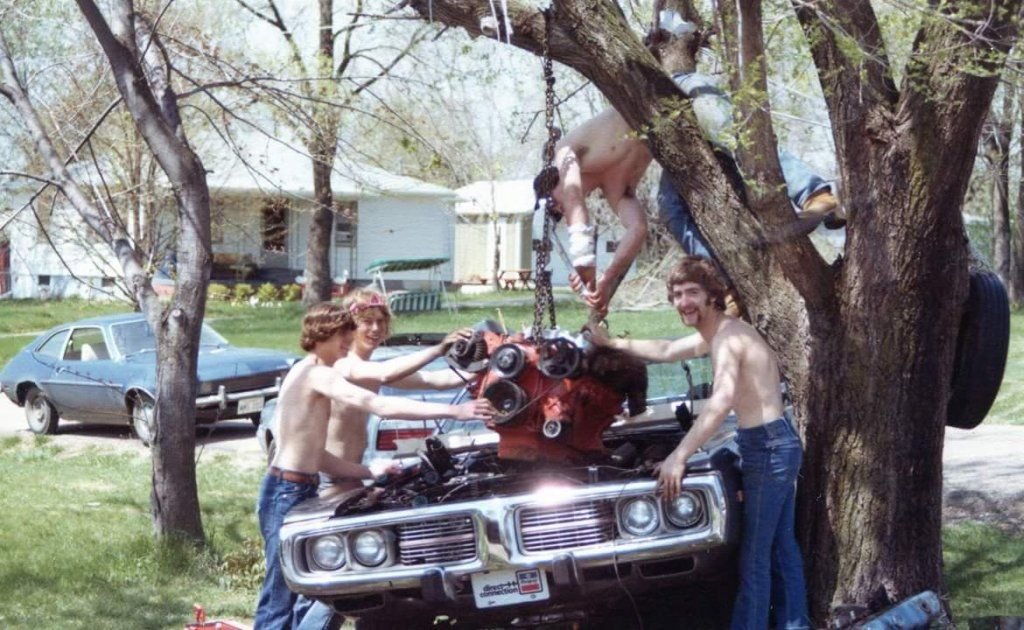

It kills me that in 2021 the only way to rebuild a 50 year old used Chevy engine is to send it out to a speed shop and spend $5K. There was a point in time that we pulled engines and rebuilt them in the driveway using the same parts and tools we use today.
the good old days !
