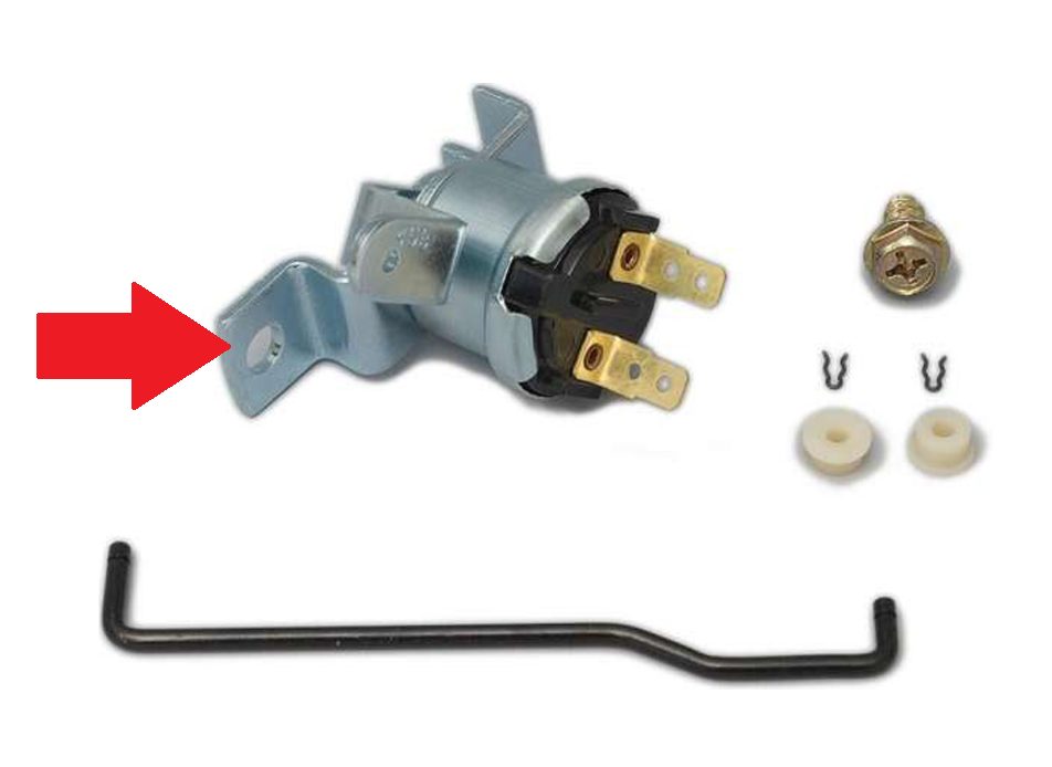

When I converted over to a hydraulic master cylinder- didn't have enough throw to engage the clutch safety switch.
I took my dremel and just notched the mounting hole- and IIRC just had to tweak the mounting tab a bit.

I actually "upgraded" to a Camaro / C5 style switch. I didn't want to deal with the bracket or waiting for a new one if it went bad vs going into any local parts store. I try to get a photo, but I mounted use the stock holes of the original.
