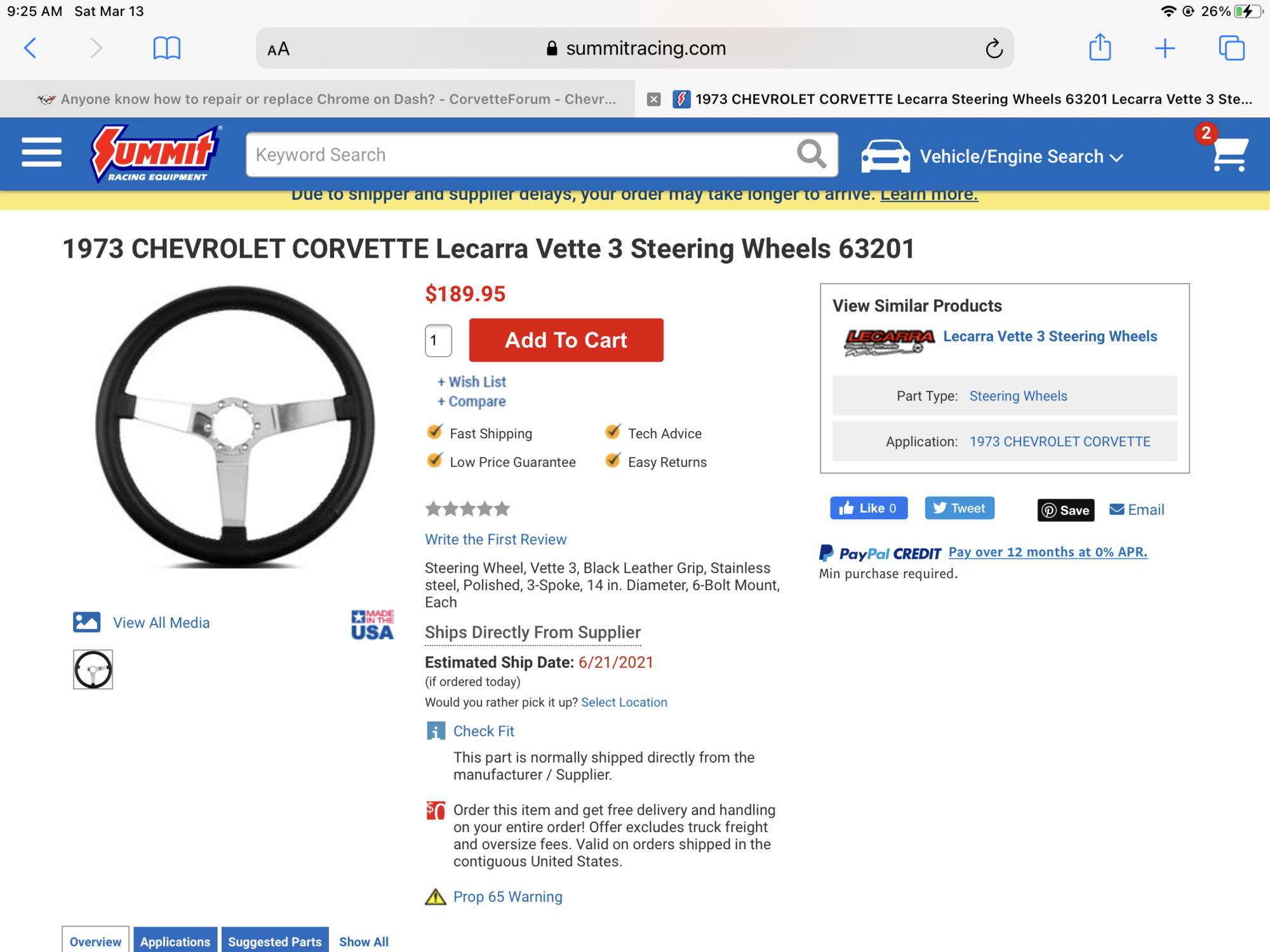

I’m looking at new steering wheels for my 73 restomod.
I’m redoing the interior in all original panels, seats, gauges, etc and want to keep with a leather rapped, 14” replacement steering wheel that looks similar to the oem wheel.
I’ve seen the ones for sale from Corvette Central, Wilcox, and the Lecarra steering wheel shown in the photo below from Summit Racing.
What did you replace your oem steering wheels with, are you happy with the quality, and how was the fitment?

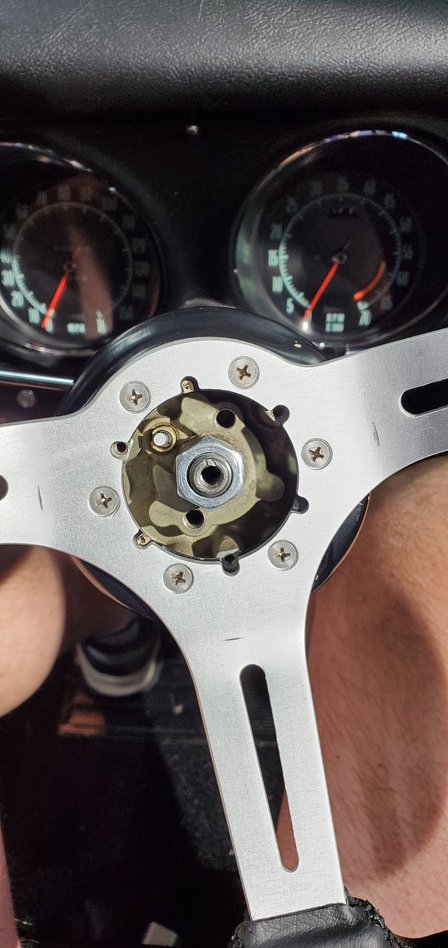

I actually just put in the Corvette Central version this morning. The wheel came in a box labeled Auto Pro USA. I have mixed feelings. Installation was not straightforward, but in the end, it looks like it will work well.
I too wanted to come as close as possible to a stock look, and my original wheel was in great shape, but at 6'5" I need to do everything I can do to fit comfortably. I also wanted a bit more direct feel after installing Borgeson power steering. There is still a little salt on the roads and I will hold off until the next rain for a drive to test the feel, but it seems good in the garage.
The spokes are a bit thicker than the original and the dish may start too close to the center. If you have a telescopic wheel, the rotating mechanism will bottom out on the spokes before the center seats. I first tried shimming under the rotating mechanism, but the screw that locks the telescopic function is then too short. I had to also insert a spacer down the center hole then so the screw that is attached to the rotating mechanism was able to lock the telescoping function.
This is where it hits:
After shimming and installation, it looks good. I may go back to make a little shorter spacer for the bottom of the screw. Right now the telescoping action is not as smooth, but it works fine.
It looks good all said and done. The extra 1/2" per side clearance makes a big difference getting in and out. The fatter wheel feels better in my extra-large hands.
I may question Corvette Central on this, but it looks like it is just the way these wheels are made.

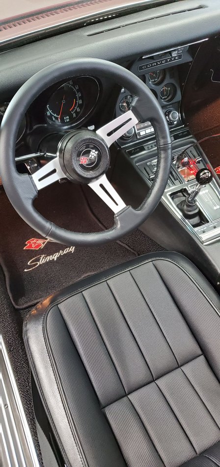

Default Manta 4
I still have the stock one but put this in when I replaced the column and put in a borgeson. Love it!
This wheel looks pretty flat in the picture, is it dished at all, if so what is the offset?
How close is it to the turn signals?
It is nice who makes it and where did you purchase it?
it is dished some. I find it perfect distance to hit the signal and you can still have the same hand on the wheel and just slide your hand up or down. I’ll get you a better picture tomorrow with it on the car. It is the Manta 4 Personal. Made in Italy. They sell around $200 on eBay. The previous owner gave this to me when I bought the car. I installed it once I rebuilt the steering. Really like it. Even has the Corvette center cap for the horn. Here is a pic I found on the internet.
https://images.app.goo.gl/st51ynp3XJFK3fDQ9

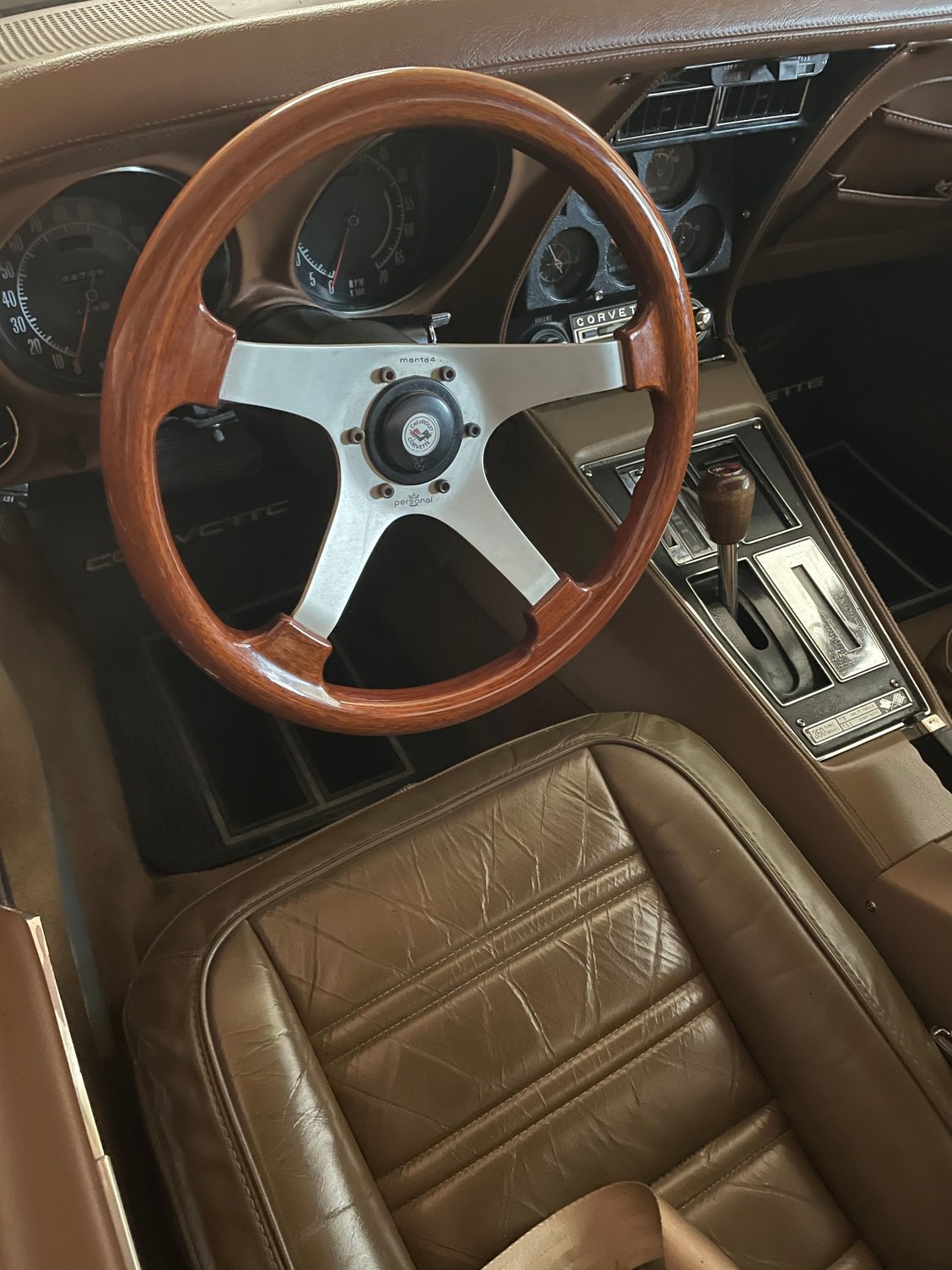

I love this MOMO wheel I installed a couple of years ago. It has a little less dish than the factory wheel to get the wheel a little farther away from me.
