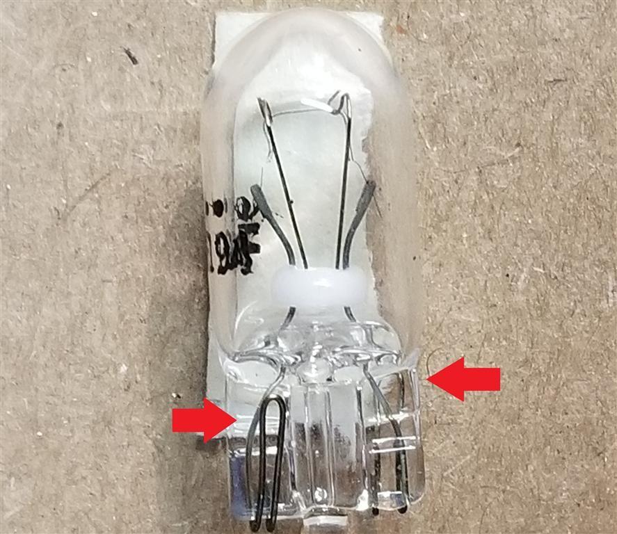

All good advice above,
Pay close attention to the front side marker lights.
The little loop wires sometimes need to be pulled away from the glass to make good contact in the socket.
I always reset these when I pull or replace a bulb.
