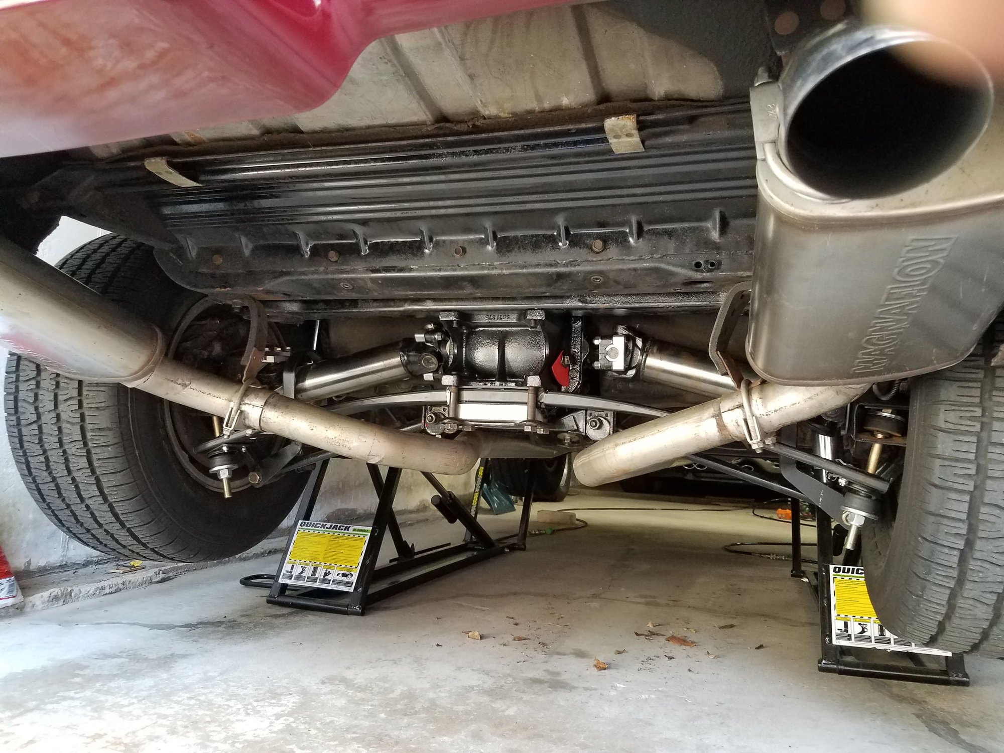

In case anybody was wondering if this was ever resolved: After removing the diff the second time to look for the source of a noise after a pinion thrust washer had gotten chewed up in there, we noticed a slight nick on a ring gear tooth - on the coast side. We had spun the gears with a drill on the bench. Drive direction was quiet, coast side yielded a pulsing noise. This matched what I heard in the car - no noise on acceleration or steady speed but a slight grinding sound decelerating in gear.
So I got one of the last US Gear sets, 3.73 ratio. Thanks to Gary R for the heads up.
Gears are in, rear is in and a 10 mile test drive showed no noises or other problems.
I will eventually test it out on the track, with the drag radials but I'm not expecting problems. (I got both thrust washers in properly this time.)

Yep, according to my machinist brother in law, with lots of experience, its good. Lash is at .008, so I should be good to go.

Now, is that the Heavy Duty diff cover from Muskegon Brake on there? The "ears" look thicker than stock.

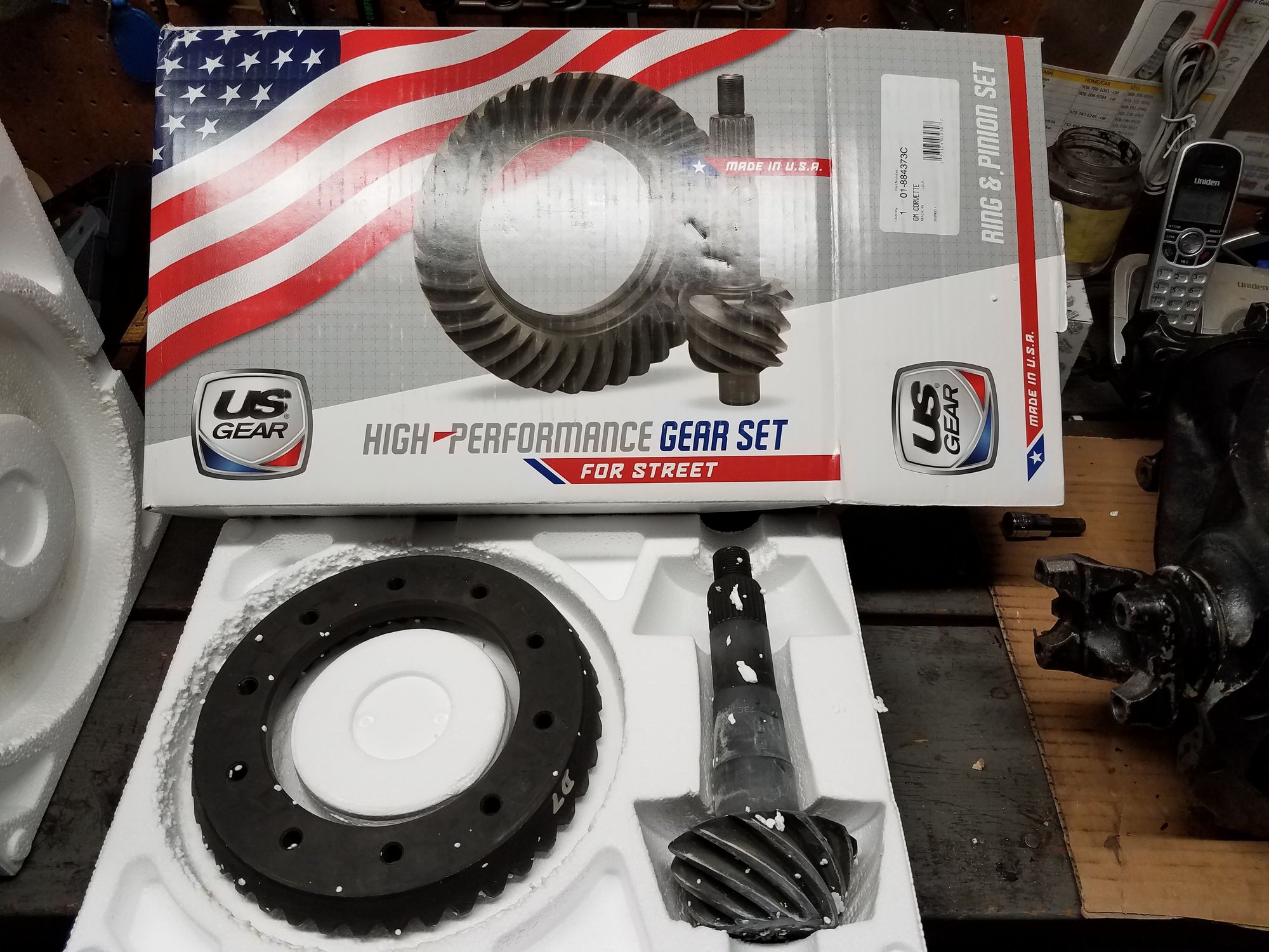

The gear set box says: For Street Use. Likely a limited warranty issue incase you break something at the strip. It doesn't say Street Use ONLY.
Looks like one ring gear bolt was not torqued yet. But you took care of that, right?
Nice set-up.

The diff cover is the original, stock 77 unit.
The ring and pinion are replacing the same brand gears that I had in there since the rear was rebuilt about 7 years ago. I had no problem with them over a couple hundred runs on drag radials. What started this round of rear end work was worn clutches in the posi unit. The ring gear got damaged by a spider gear shim (thrust washer) that I didn't reinstall correctly. Regarding warranty for R&P failure with this new set - I wouldn't even try to pursue that and hopefully I won't have to.
Ring gear bolts are Lock Tited and torqued, believe me. But thanks anyway.

In my case the gears were quiet before the thrust washer got ground up in there. We finally found the damage on the ring gear while doing the spin test slowly in each direction. While going in reverse, the slight pulsing could be heard or felt, roughly every fourth time the pinion went around. Since the ratio is close to 4 to 1, (3.73), we knew the damage was on the ring gear, on the coast side. After scrutinizing the gear, tooth by tooth, we noticed a spot on the ring gear that was unusual (burr, nick?). When we rotated that spot, in reverse, by hand, while putting some resistance on the ring gear, it could be felt every time that tooth contacted the pinion. Those gears might have lasted indefinitely in there with no problem other than the slight noise I was hearing. But who knows?
I will try to get a pic, for conversation purposes.

We put yellow marker on the ring gear before we spun it to possibly show the bad spot. It did help a little.
Can you see the light area within the black marker? That is the bad spot. It doesn't feel high or low there but it drags a little on the pinion on that tooth. It is amazing to me. Maybe that tooth is bent slightly. The pic shows the drive side. There is a similar mark on the coast side.
This shows the potential risk in installing used gears, in my mind. I don't think anybody would notice anything on a visual inspection.
Disregard the styrofoam pieces. They are from the shipping box for the new gears.
