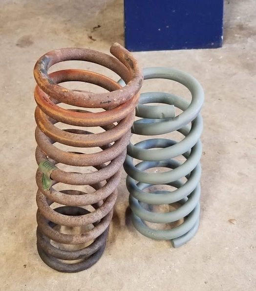

Likes: 4,507
I put on the 550s and dropped an inch over stock. I'd certainly try them first before cutting them, especially with a big block.
Also, even with a 385 lb VB&P rear spring, the rear feels softer than the front. My 80 may be a bit lighter than your car, and the stock 1 1/8" front swaybar adds even more stiffness, but do check some other threads before you commit to a size. You may want to call VanSteel and ask for advice based on the rest of your car.
Do you have a rear swaybar?
EDIT: Not 100% sure of the 1" drop. It's lower than stock, but not any lower than before the change.

Old Mar 20, 2021 | 09:08 AM
Bikespace's Avatar
Bikespace
Joined: Mar 2017
Posts: 11,949
Likes: 4,507
Originally Posted by augiedoggy
Yes I do believe I have a rear swaybar now. The fact that your height dropped is actually encouraging to read but it does confuse me that so many have gotten different results from the moog replacement springs. I guess with all the different changes and small weight variances its to be expected though. I will test fit the springs uncut first.
To be fair, I'm not 100% sure they are Moog, just that they are 550s.
I should have measured the before and after. Looking through my photos, none clearly show a ride height change and certainly not a 1" drop, so my previous statement is in error. YMMV with a big block, though.
Here are the two springs.
