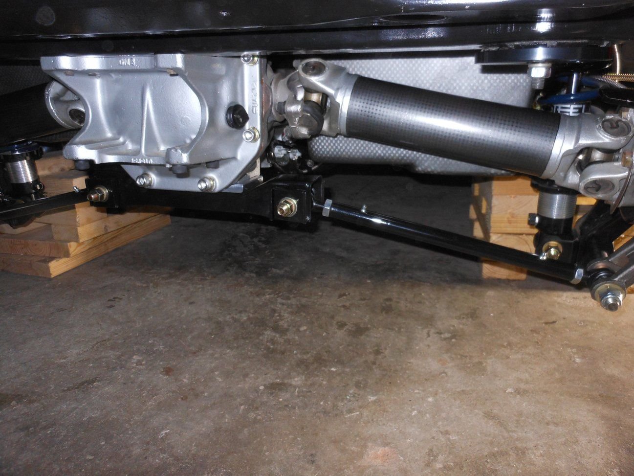

Look at these- Mine are greased internally in the tube-
really neat design and I was all in for $160
https://www.corvetteforum.com/forums...post1603165668

Richard454 your rear end looks show / collector quality!
I ordered a new strut rod kit with Heim joints. I also ordered a rear spring bolt kit with new grommets that has longer bolts to lower the rear end some. I always thought the rear sat about an inch higher than it should. Anyone have experience with adjusting ride height with these extra long (by. 2 inches) rear spring bolts?
