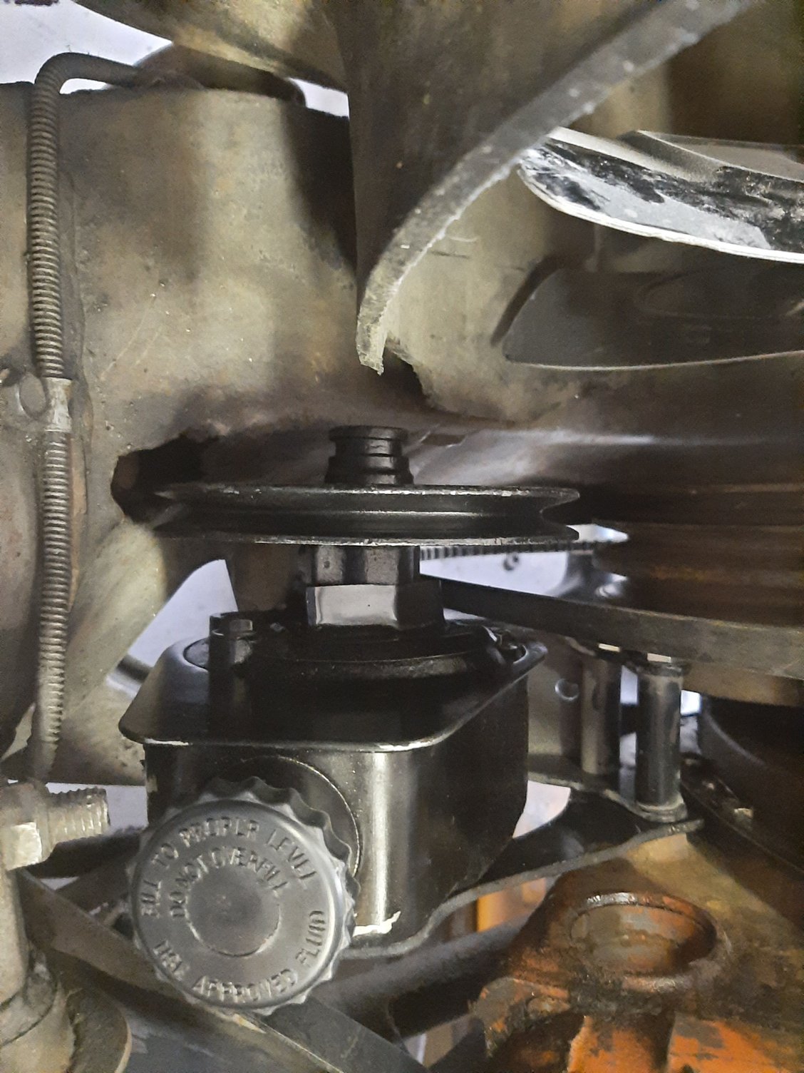

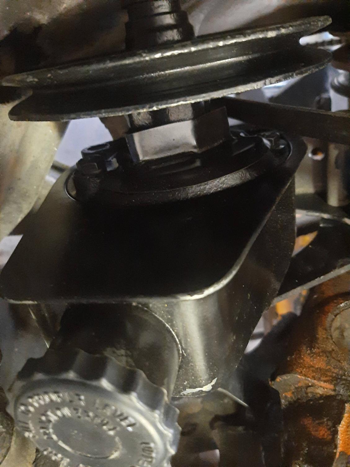

Not sure why my laptop won't download any new photo's.. I think I cant text them to you..
Old Mar 20, 2021 | 08:21 PM
c3vettesforever's Avatar
c3vettesforever
Joined: Feb 2018
Posts: 23
From: Gunnison Colorado
Default Power steering pump...
Sorry this took so long...I need a 12 year old back in the household to help me with technology!

I'll see if I can get a photo of mine

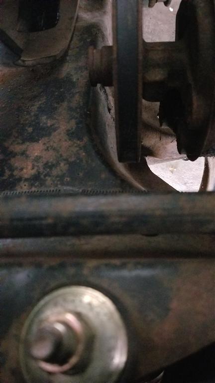

Default pump
Here's another photo.
Old Mar 20, 2021 | 08:38 PM
bmotojoe's Avatar
bmotojoe
Joined: Oct 2007
Posts: 4,360
Likes: 1,724
From: Seattle Area Washington
So snaking under the alternator this angle would be from just above the pump under alternator.
Old Mar 20, 2021 | 08:43 PM
c3vettesforever
Joined: Feb 2018
Posts: 23
Doesn't look like you have much room to slip a belt in either... I guess I will loosen up the pump to get it in... Hopefully I don't have to change it often!
Thanks for your help and patience with me and the photos!
Your Vette looks great... My 68 was the same color..
Jackb

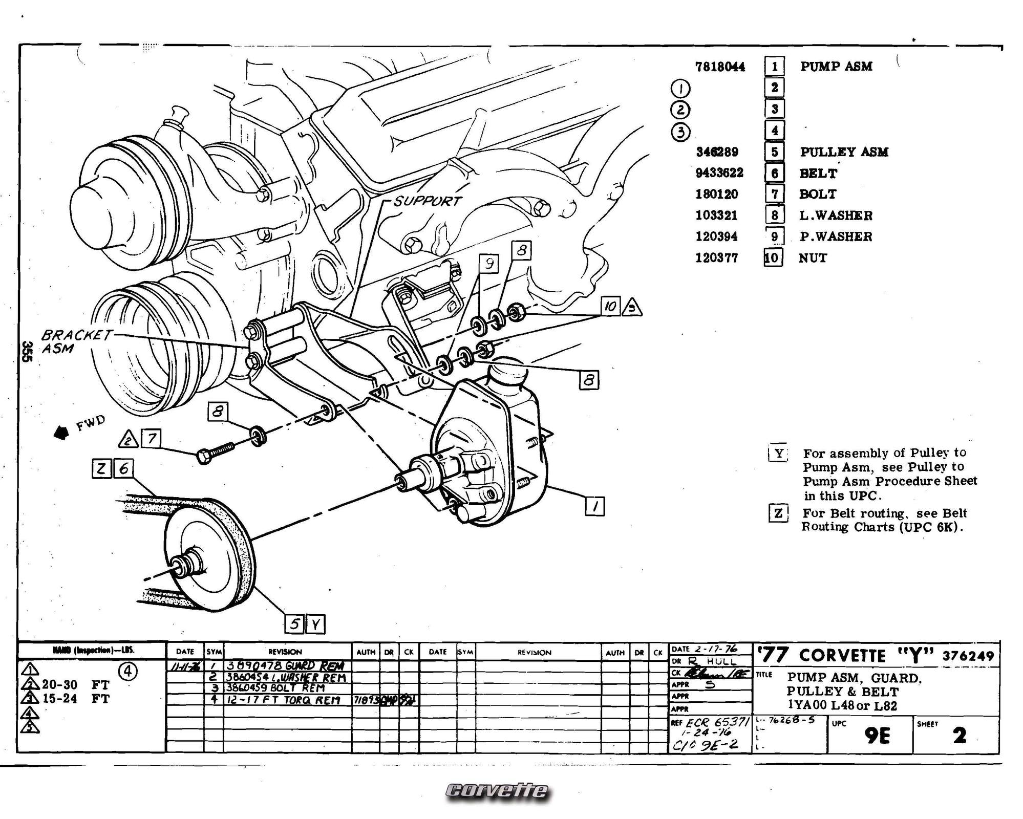

And your brackets are like these?
Old Mar 20, 2021 | 08:48 PM
c3vettesforever
Joined: Feb 2018
Posts: 23
Bottom one is the same.. The top one to adjust the belt tension is a little different.

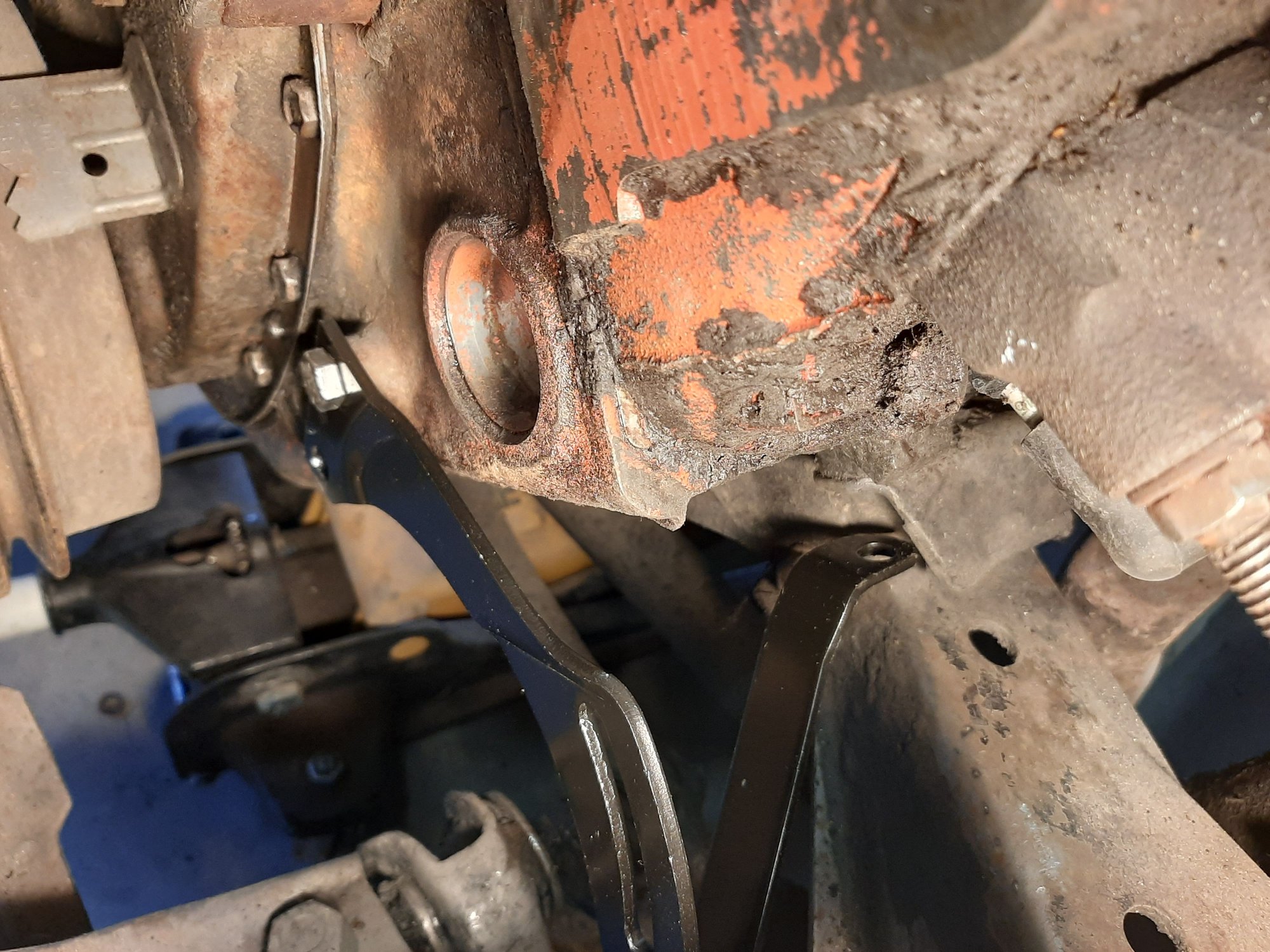

Default Power steering pump adjusting bracket
I ordered a new adjusting bracket and I have the same problem as before. See where the end is suppose to mount to the block? There is @ 1 in. or more space between it and the block.. Not sure what's gingon here? Any thoughts? Thanks in advance...
