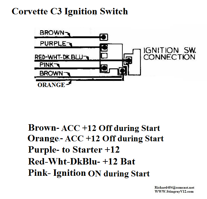

I'd look at the ignition switch,
The stereo ( if wired stock) uses the ACC wire- hot in ignition and ACC but not crank. The gauges uses the ignition wire- not hot in ACC but ign and start.
And you'd have the Sniper keyed source off the pink (Gauges) wire as well- as you need hot in ign and crank.
Since its affects both- it really points to the ignition switch/connection / the power source going to the ignition ( fusible link) and
/or the bulkhead connector.
Richard
Richard
This is definitely a possibility. I have the original ignition switch in there right now.
