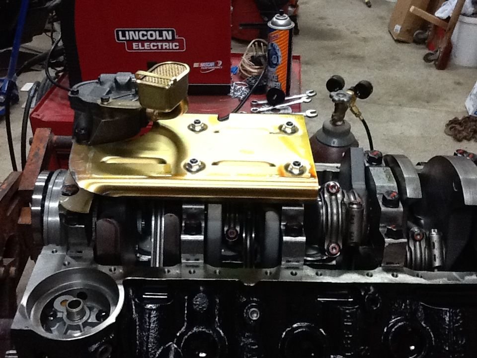

Hello:
I was priming my 427 today and had a oil leak coming around my filter. The adapter I have now has a hole in it. I am having trouble finding the correct adapter to replace it. I attached some pictures to show what I have now. I found a Mr.Gasket set that looks like it may work but not to sure if it is correct. It does have 5/16 threads on the bolts and they do have Dorman markings. Any help will be greatly appreciated!
Tom

That oil filter adapter in your picture looks like the one for the old style "toilet paper roll in the can" or canister filter. Since 1967 or so GM has used spin on filters (PF-25 and the like). Jeff82c3 has the correct style adapter.

Got the parts I needed thanks again for the help.
