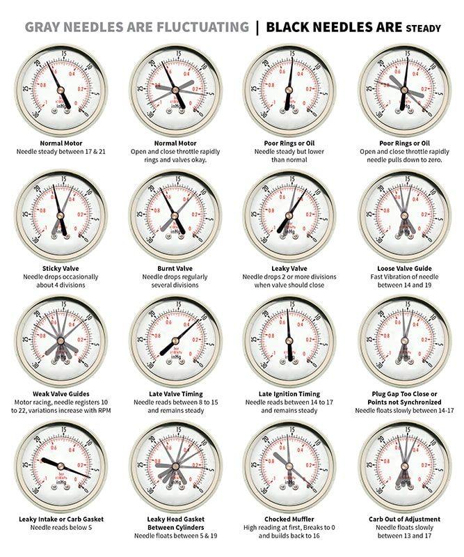

I did not know you could get liquid filled vacuum test gauges. Learn something everyday. Dash ones ive seen liquid filled. A vac gauge is such an underrated test tool - it can tell you so much. I am trying to understand the teeing into the vac advance line to the carb, and why this is better than tapping into direct vacuum off the manifold. I've done it both ways. What if any is the advantage of teeing into the vac advance line? Trying to understand and learn.
OP, can you try that first vac gauge, that is from your mighty vac, on another performance type motor to see if it moves the same? I've never used my mighty vac as an engine test gauge, but there should be no reason why not. It's a vacuum gauge. Just wondering if it's just not able to handle the pulses from an engine, but rather to test and hold linear type vacuum like a vac advance can or headlight actuator,etc. First gauge suggests valve guides, second gauge suggests all pretty good.

If you take a reading from a runner with a big cam it will bounce like that.....going to the carb can even out all of the pulses in some cases depending on the style of intake.....
I always take vacuum readings from the carb as it is the closest to the throttle plate and representative of what the carb “sees”.....all 8 cylinders....not just one.

Makes sense. Never considered the fact that pulses are more pronounced at the manifold. I'm running a 108 LSA cam and i see a slight moving needle off the manifold. Will tee off the vac line and see if a difference. I can now see the benefit for keeping a plugged tee on the vac advance line. Thanks all. More knowledge.
