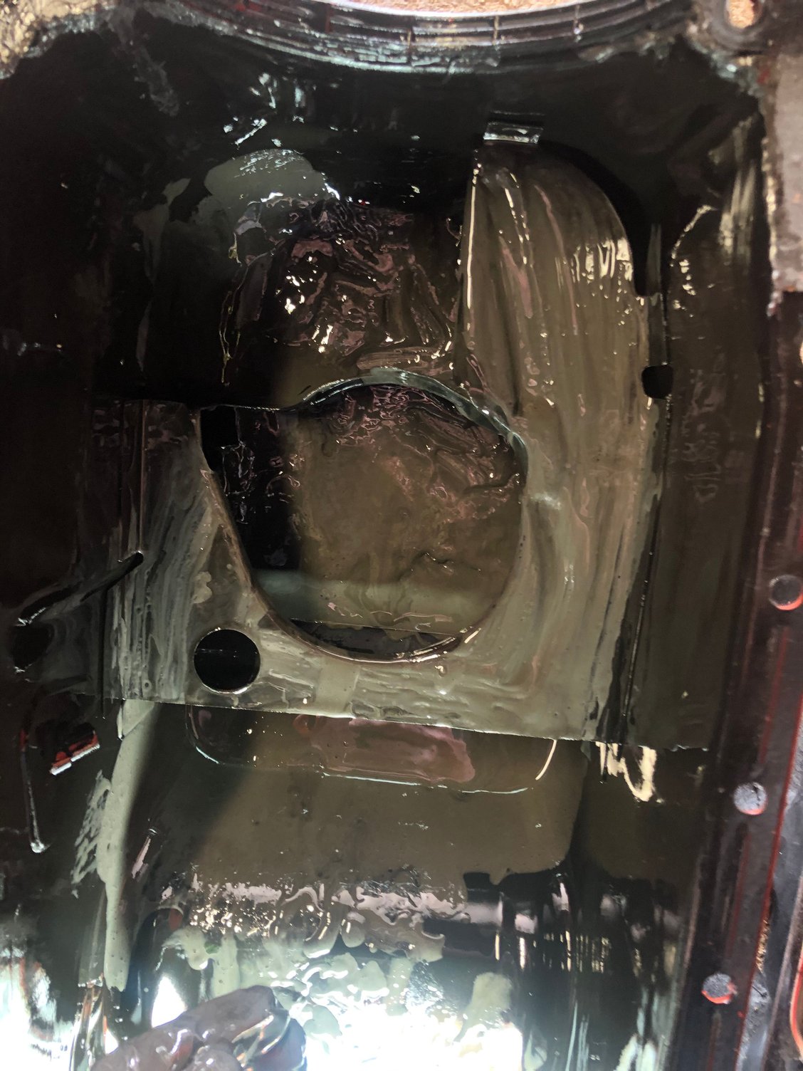

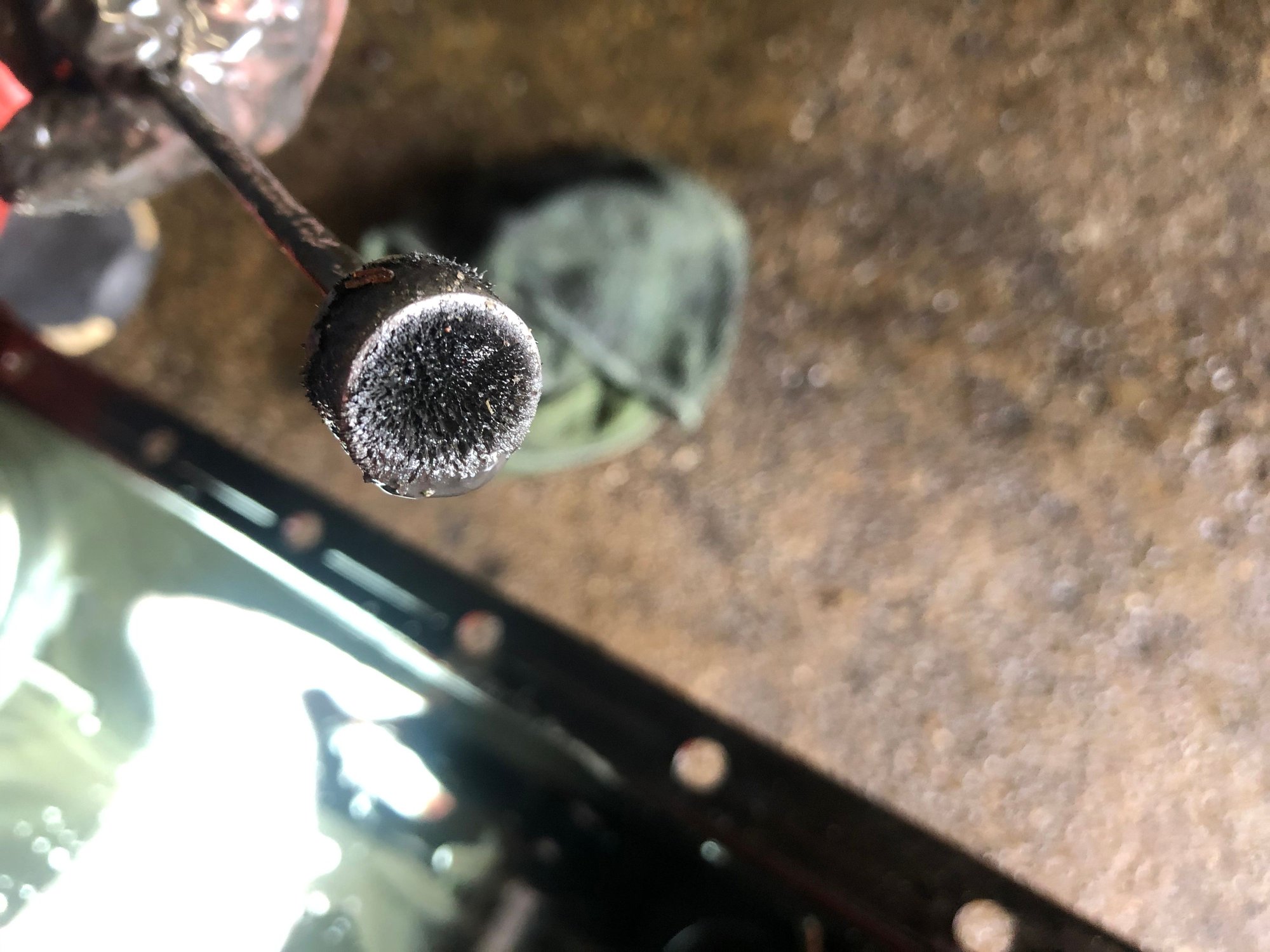

well i dropped the oil pan and its all a grey sludge however there isnt any larger metal pieces. its thick though and when i put a magnet through it very tiny metallic. i found my cam. now can i get away with just a new cam or does it need a full rebuild

There will be varying opinions here, so be prepared. Personally I was involved in a race car in the past where a cam was wiped - we flushed everything as best possible, replaced the cam and ran the motor with several frequent oil changes soon after - it was fine for the couple seasons we ran it. If the pan is off I’d look at a couple of rod bearings and see how they look. If they are in question, probably worth pulling the motor and taking everything apart for a proper cleaning and reassembly. It doesn’t mean you have to bore/hone etc. depends on how old the build is, and how contaminated things look. You do need to be concerned about that metal paste as it will be in the filter, oil pump, oil passages in the block etc. For longevity sake and if you can afford it, I’d be inclined to pull it out and disassemble. For what we were doing, there were no street miles at all and the motor got constant attention, so total running time was a fraction of what our street cars see.

Even several oil and filter changes may not dislodge some metal particles embedded in the engine. It seemed that a short length of thin steel wire passed end-on through the oil pick-up mesh in my engine and passed through the oil pump spur gears at 6000 rpm 'shocking' the oil pump drive shaft enough for it to fracture (loosing all oil pressure).........luckily I only needed to replace the oil pump!

looks like im just going to pull the engine to clean it all out and hope there's not much damage. hopefully just put new bearings in and be on my way. anyone have good machine shops in ny
