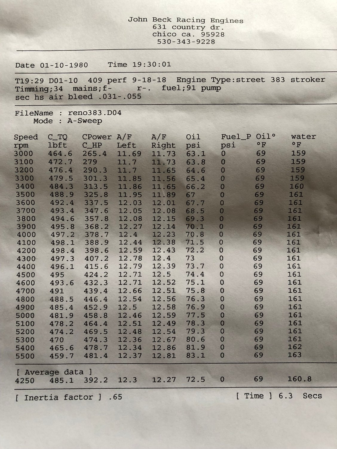

I used a 350 4 bolt main block 30 over Skip White forged rotating assembly his Chinese heads his Magic HR cam and whala. Yeah I know the date is wrong my engine guy is obviously not into time

You would have had hotrod God status back in 1980!!!! too bad they didnt start the run down lower, I would like to see what the full torque curve looked like. Very nice numbers!!!

"You would have had hotrod God status back in 1980!!!!" I was going to say the same thing. Would have been the boss in a nice light car.

YA, ONE hp per cubic inch was a good goal back then...now a days if you arent close to 1.5/cu then you arent trying hard enough
