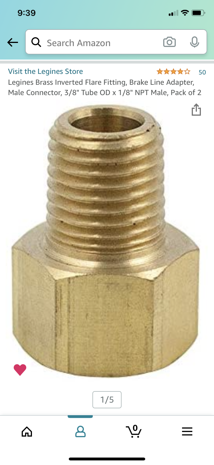

You’ll need an adapter for the brake booster steel line. I got this from Amazon.

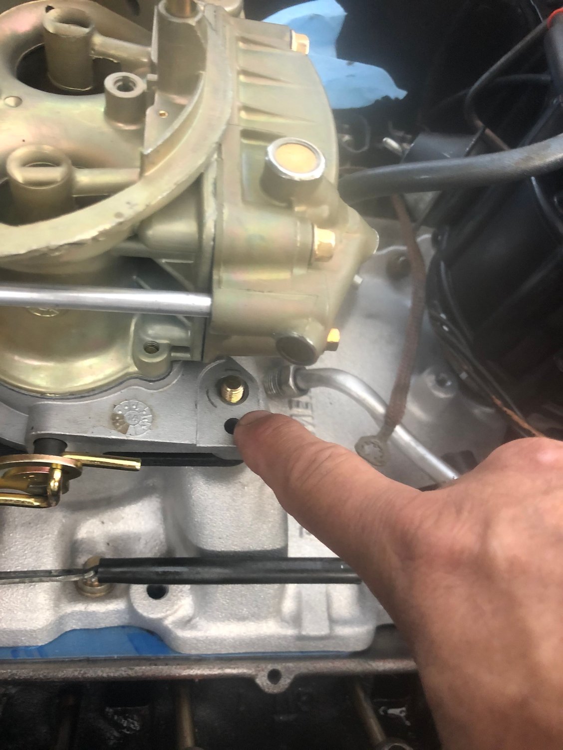

I can't use longer studs because of the clearance above (hits the carb itself check out pics.)

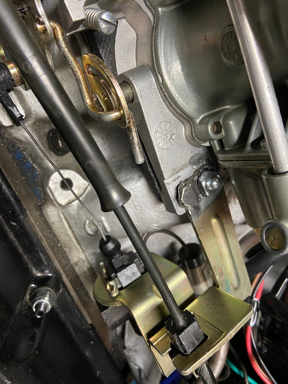

This is my throttle cable bracket. It only requires 1 bolt to hold it on.

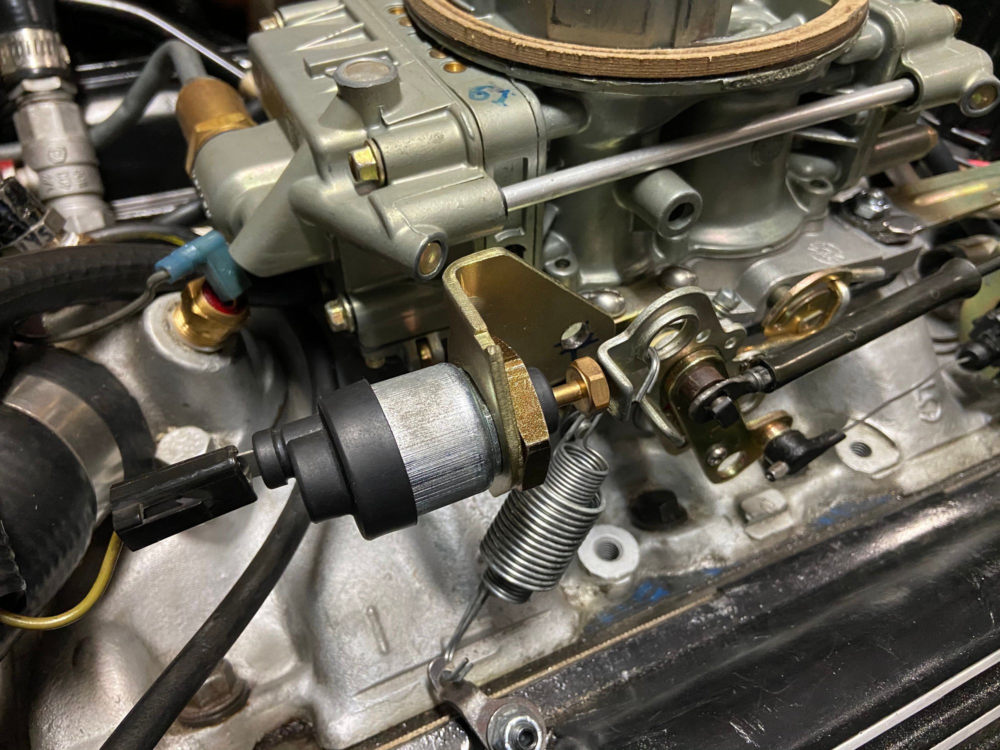

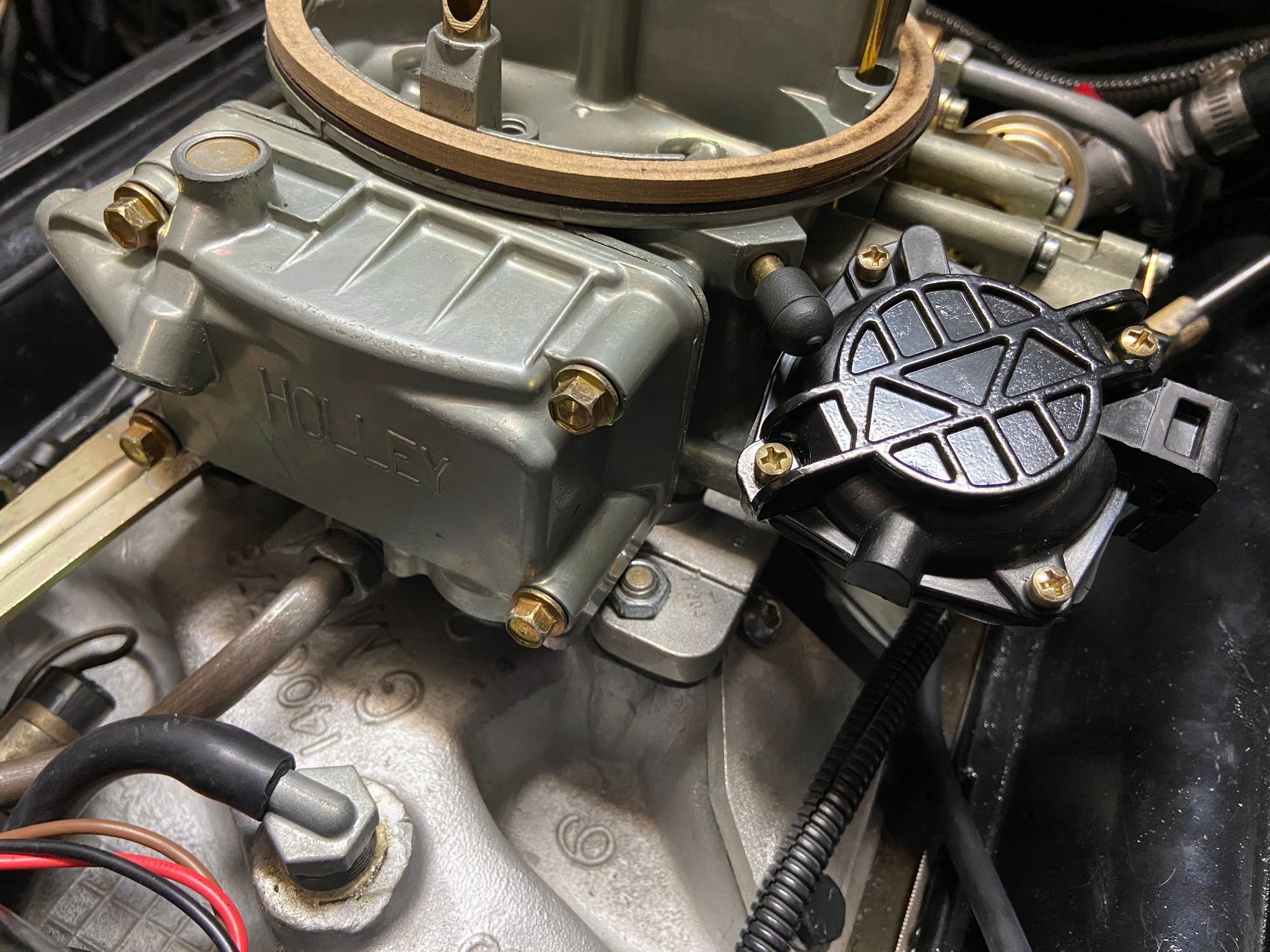

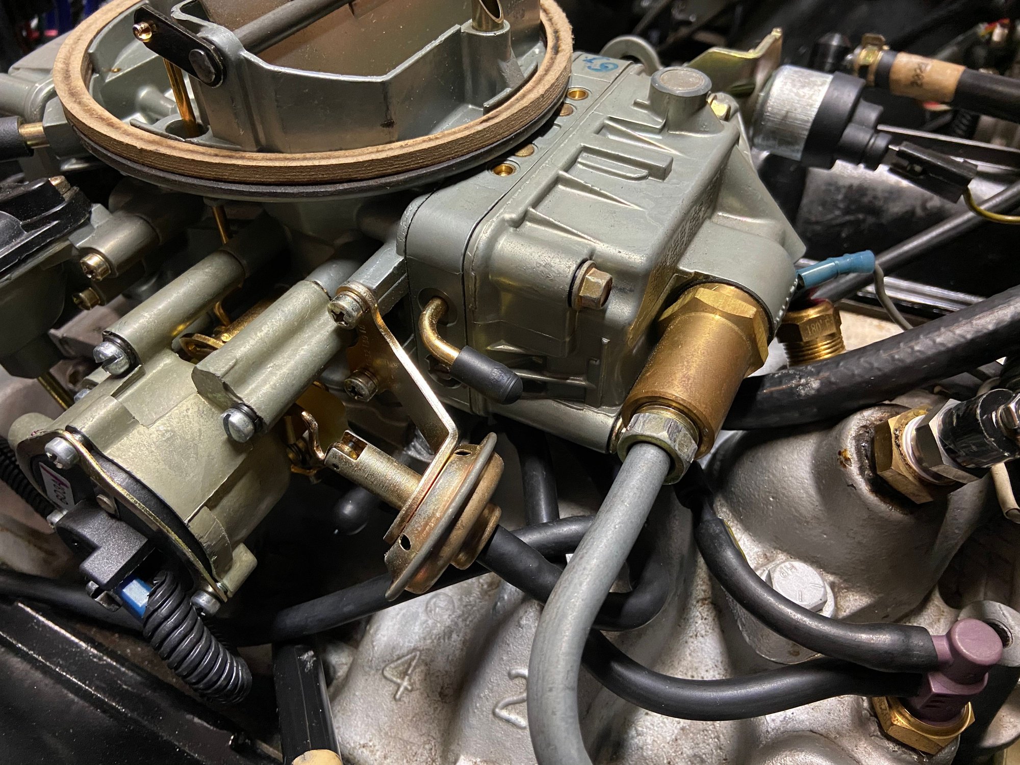

Here’s some pics of my 4175 install

More
Tried to upload photos but forum won’t let me. Try later
hmm I see what you mean. I can cut mine down to one bolt if I can get it connected or even thin it out

I see the. Clean setup. Can you take a pick further back to see the bracket from a different angle?
