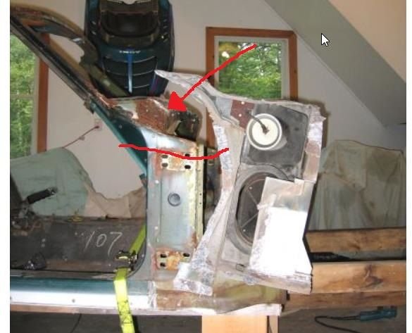

Here is a pic, but naturally this is the wrong side. The large oval shaped black vent flapper is visible here. There is a similar on in the driver side. The reason I picked this pic is it shows the vent is part of a large internal fiberglass piece which holds the fender on. It goes between the metal birdcage and the outer fender.
Sounds like yours got changed with a non AC piece during your fender repair. The black piece that holds the vent door is a separate part. I am unsure how this part is attached but I would assume bonded.

If I were you I would remove the interior kick panel piece by your ankle (after the metal door sill plate) and see what is behind it. If you are brave enough, it should/may be possible to add this "flapper door frame" piece back in from the inside of the car. I can give you good clear shots of mine if necessary, as my Non air car BB car is all dissasembled. The cable just runs under the steering column to the console.
This looks to be an AC car with the vacuum operated pass vent door. The vac canister can be seen up top.
