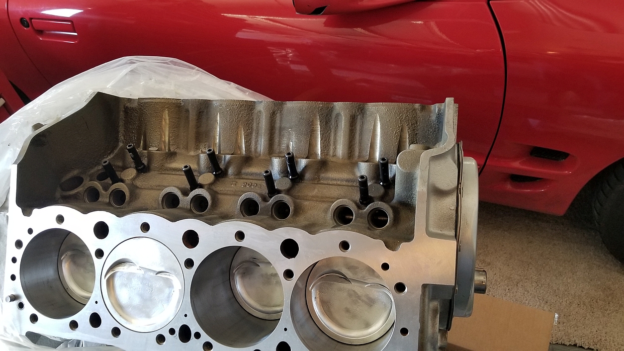

The waiting is killing me along with my torn rotator cuff and one bicep tendon. The joys of working under race cars for to many years. Like months to acquire. My bore is 4.155 and my previous head gaskets were Cometic C5247-027 It's a MLS .027 thickness. My quench is better this rebuild. I had the block decked to end up with .015 piston down the hole. So .042 quench is pretty good.
Iron block and aluminum heads.
My question is does anybody know of a source for similar Multi Layer Steel. I've had solid copper fail in the past and I don't want a typical FelPro because of 11.7 C/R

The Fel-Pro 1143 is a MLS gasket....4.165 bore/.041 thick.....Summit has them in stock.

Thanks, but the quench might kill me. .041 + .015 = .056

Oh, I did stop at summit this morning and i have the .027 on order. Summit didn't have valve clearancing clay. I installed the cam 4 degrees advanced from where it was before basically 4 degree retarded for broader TQ curve and top end power. I'm not really worried about valve clearance because I am going to only 1.6 ratio intake and possibly even 1.5 on the exhaust.
cam lift I = .403 E= .420 .403X1.6 = .645 .420X1.6 = .672 then you minus the lash factor to get net lift. .012 I and .014 E Hot lash.
It was just too hard on the springs with the endurance road racing type lobes even with only 220# on the seats.
