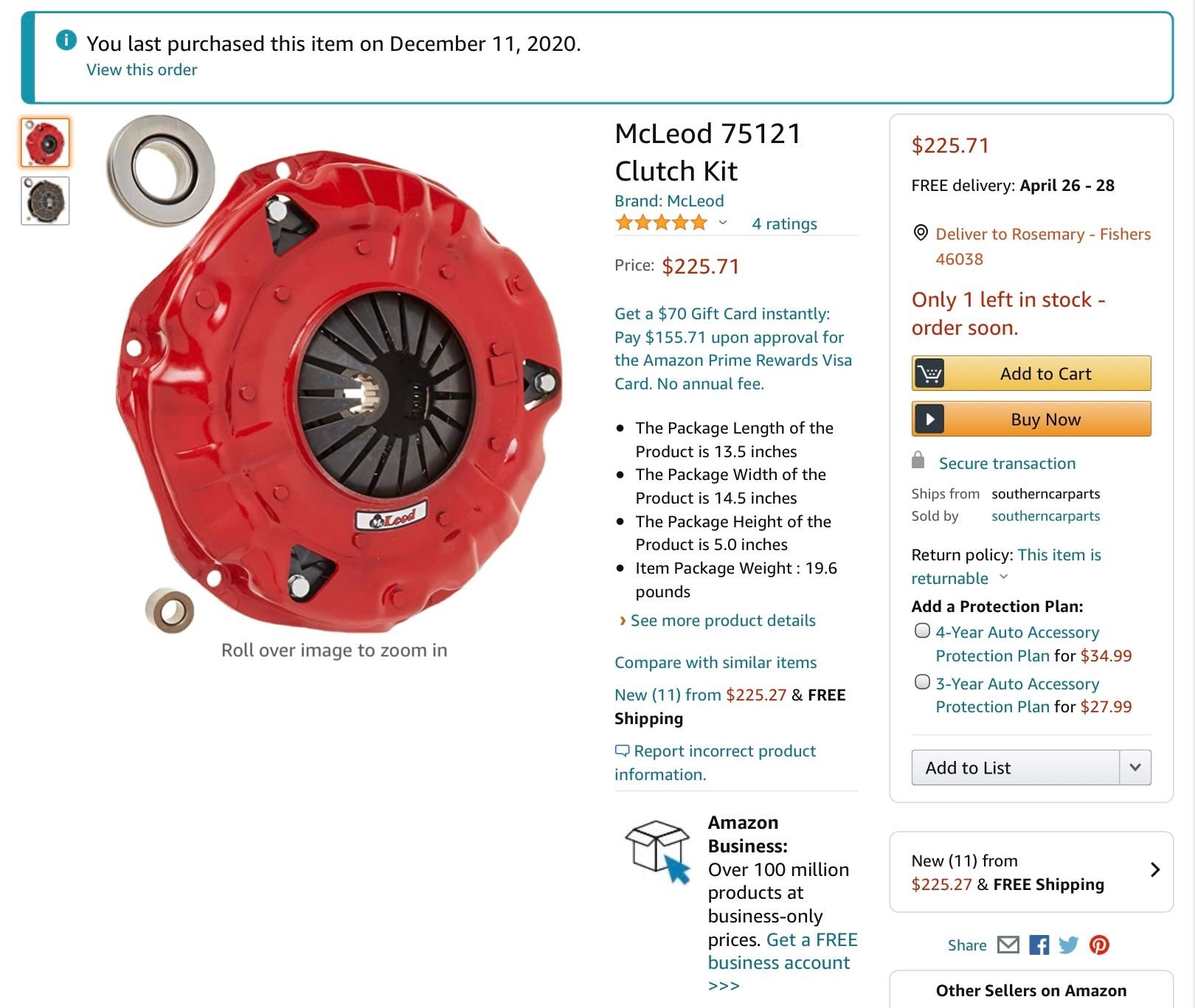

I have a McLeod Super Street Pro installed in mine 2 years ago. https://www.corvetteforum.com/forums...vel-range.html
I was fortunate to find this thread before I bought mine. My reasoning for using the McLeod is (yes, I'm aware it's a little more money) because of HOW MUCH OF A LARGE PAIN IN THE *** it is to replace a clutch in C2 - 3. So, I decided why take a chance, and go with a known commodity.

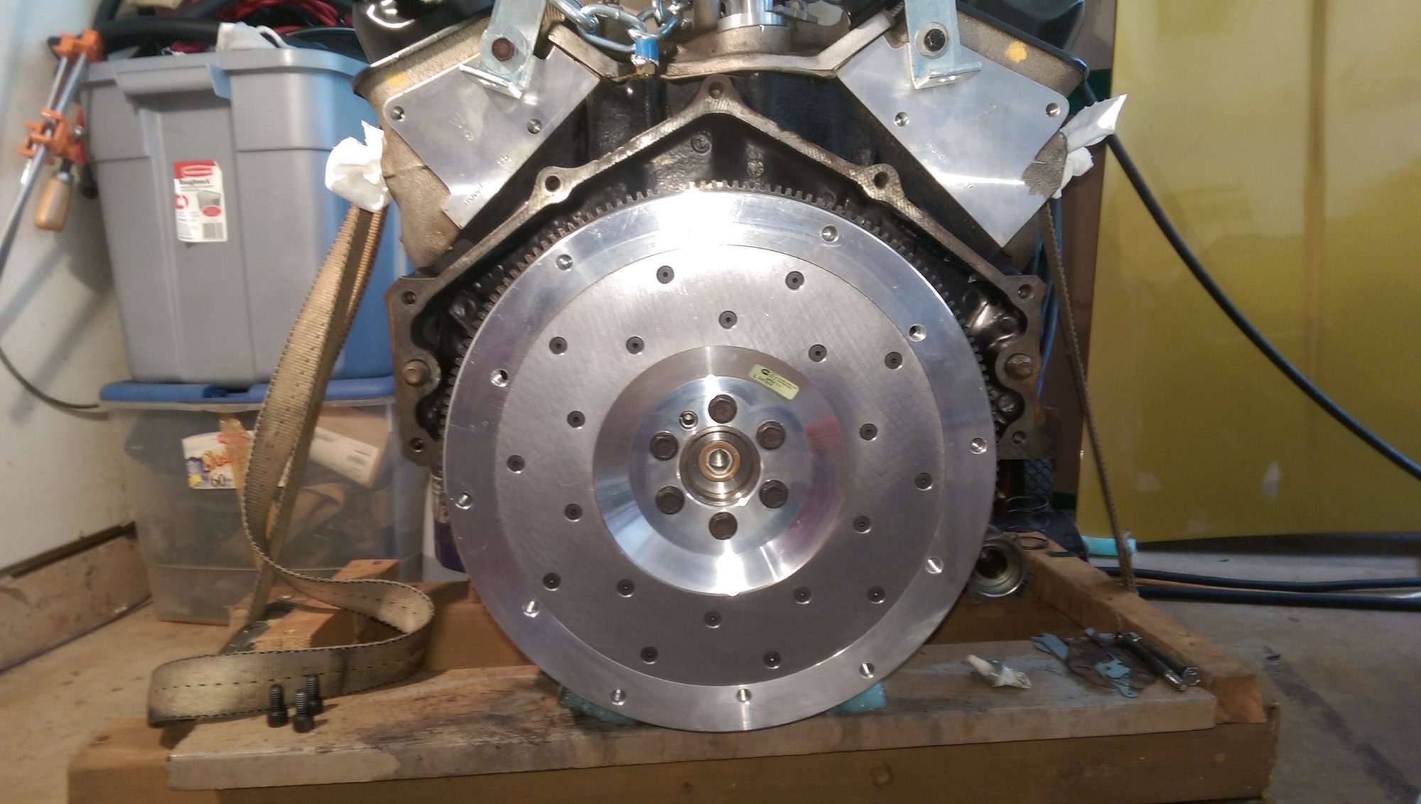

I use SPEC. Great customer service and made in the USA.
My SPEC Aluminum fly wheel:

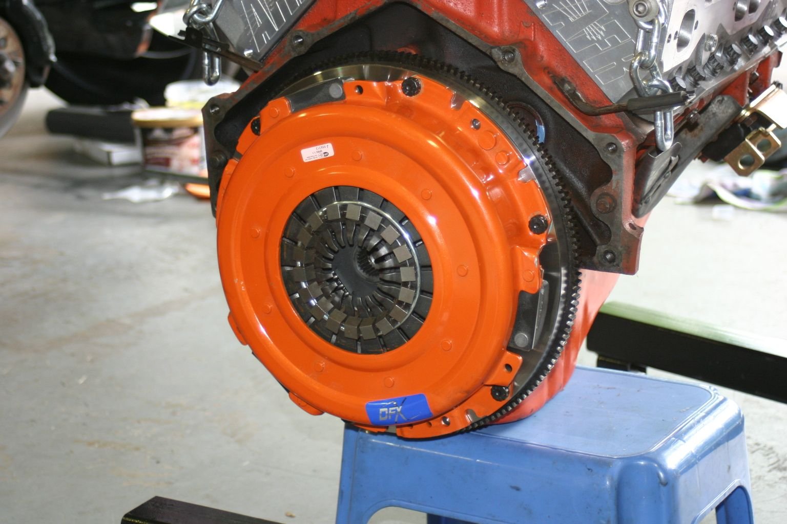

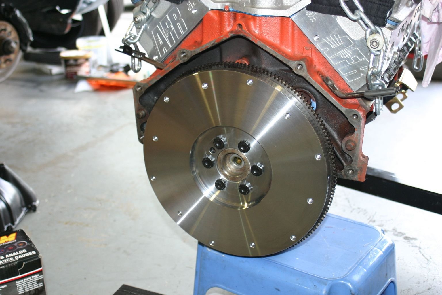

Royal Canadian Navy
Center Force here with ceramic pucks.
CF billet SFI approved
CF DFX clutch/PP
