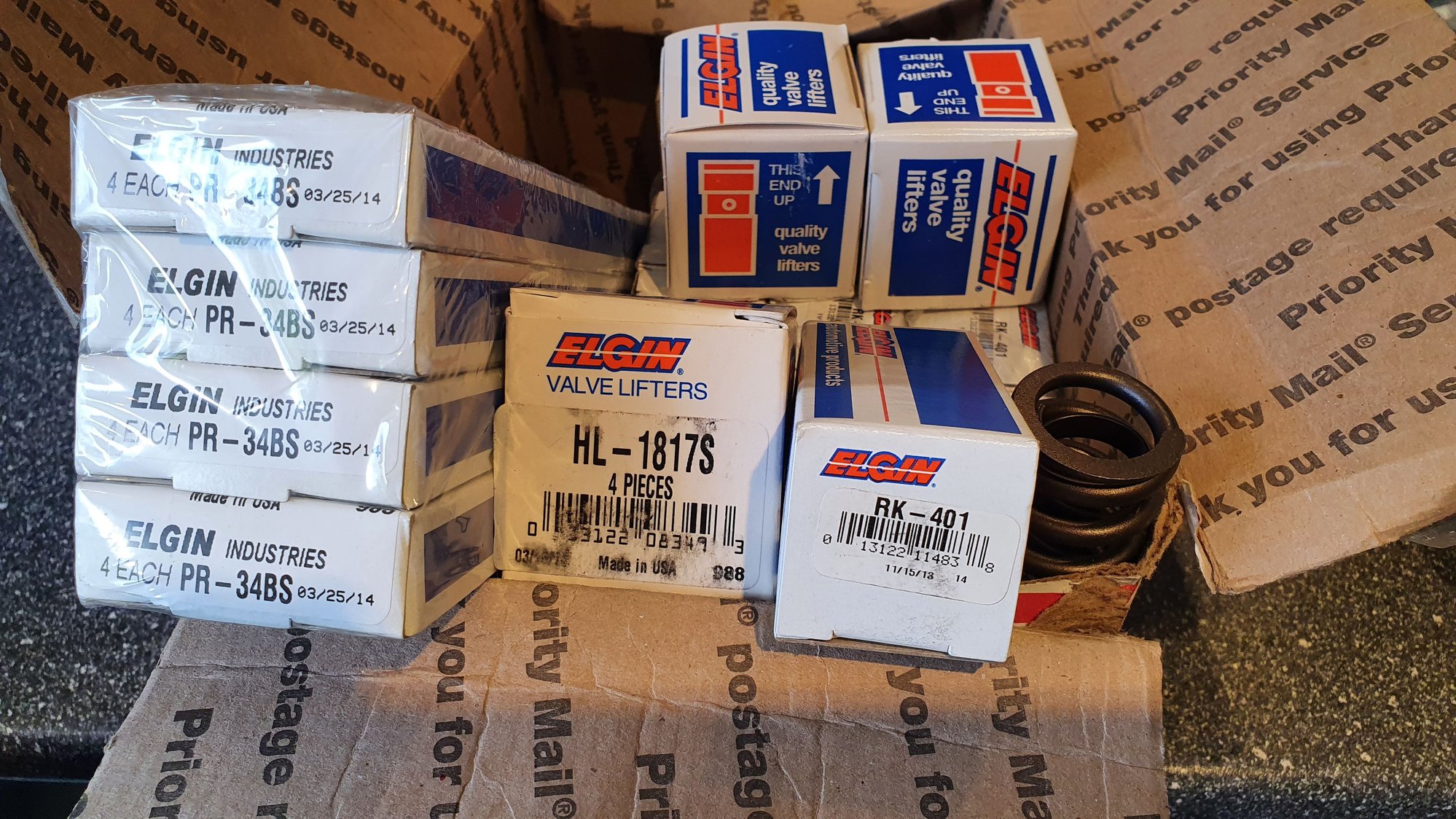

I do have a new set of Elgin Z28 springs in stock, but also lifters and 1.5 rocker arms, all new, and from Elgin.

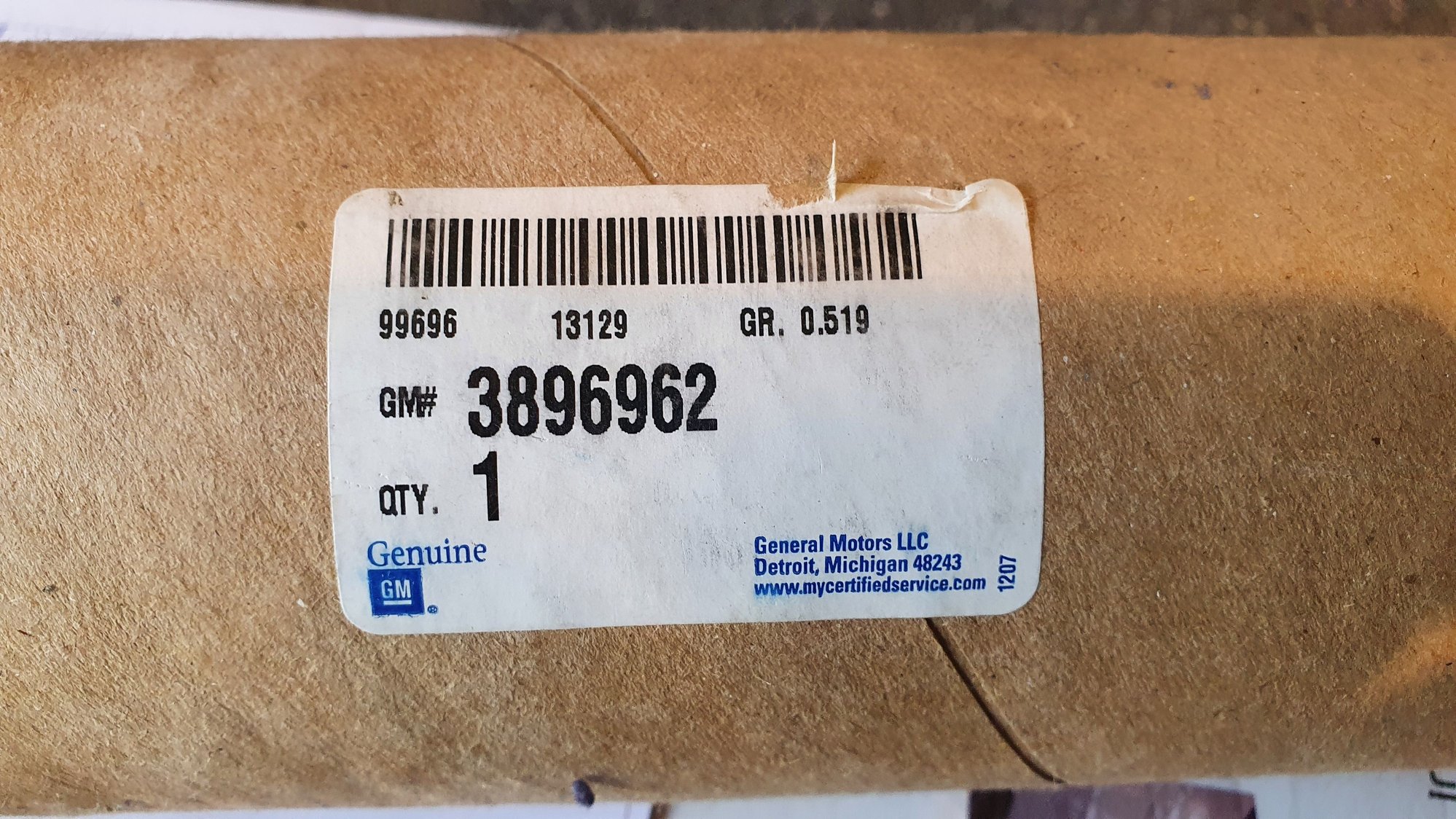

But I also have a brand new L46 camshaft, GM number 3896962 please see below.
What will be the effect of using the parts, in the engine, will they work "good together"?
Regarding the camshaft, I assume it this one.
Will that be a better solution??

They should work Great together. You will almost have exactly duplicated the L46. Do you have the 73 Z28 cast iron manifold and quadrajet as well? Or going aftermarket? A good running quadrajet works terrific on this engine.
Crane has a duplicate of the OEM L46 cam and they rate it at 224/224 at ..450/.459 lift and a 114 LC. RPM range of 2000 to 5600. WIth a 10:1 CR you should wind up with 8.0 - 8.2 DCR about perfect.
The Elgin is a little hotter at 230/230 at .480 lift and a much tighter 109 LC. Says lopey idle, 2200-5400 but great power from 3000-6000.
So the L46 will have better all around street manners, broad powerband, idle with a little lope, good low end TQ, etc.
The Elgin 109 LC especially and +6 duration means it gives up a lot on the bottom end <3000, strong lopey idle, but pulls better and longer upstairs. With the Elgin you may want higher static CR to keep your DCR over 8.0. The 109 LC makes it a little bit of a racey sounding / feeling cam.
Your choice depending on what you are looking for. Some people "need" a bad-*** idle, others don't. Looking for an all around street car? Or reving and racing it a lot? Personally the L46 is one of my all time favorite Chevy engines, for good reason,. And I owned an LT-1 for 27 years, that's another. Just changing your idle rpm 100 or so changes the way it sounds at idle anyway.

I was thinking,with the GM cam, and a set of 1.6 rocker arms I have in stock, will that be too much?? (with the Z28 springs)
It will be 0.490 on the exhaust.

Verify the spring stack. You should be fine.
Those "Z/28" springs were originaly designed for the "first design off-road" cam. The stock Z/28 used the same valve springs as every other small block Chevy. You can add some extra RPM capability using those springs with the "962" cam. The higher ratio rockers increases the spring requirements so you already have it covered.

FYI - The pushrods in your parts photo are not guide plate compatible. They have the ball ends which are not reliable and more important, they are not hardened for guide plate usage.
