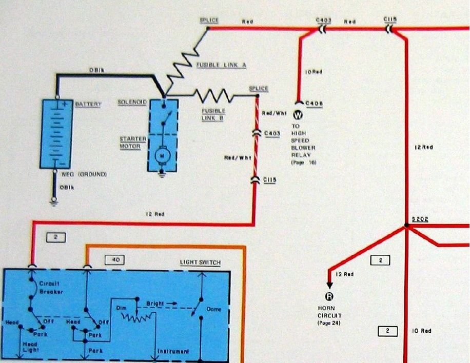

Old Apr 27, 2021 | 12:24 AM
bmotojoe's Avatar
bmotojoe
Joined: Oct 2007
Posts: 4,360
Likes: 1,724
From: Seattle Area Washington
Found 2C circuit.
There is a Black/White 6 cell plastic connector housing near the distributor, circuits 2G in, 2C out
This connector is prone to overheating and melting.
This connector is inside the Lt.Blue box on the drawing below.
Old Apr 27, 2021 | 07:45 AM
bmotojoe's Avatar
bmotojoe
Joined: Oct 2007
Posts: 4,360
Likes: 1,724
Here is a colored drawing from a late 77 headlight switch.
The wire colors may differ a little, the drawing to the light switch is the same for your 79.
You will see a C403 on the drawing, that will be the 6 cell wire connector I noted above. Circuit 2, your 79 is labeled 2C.
C115 is the bulkhead connector.
