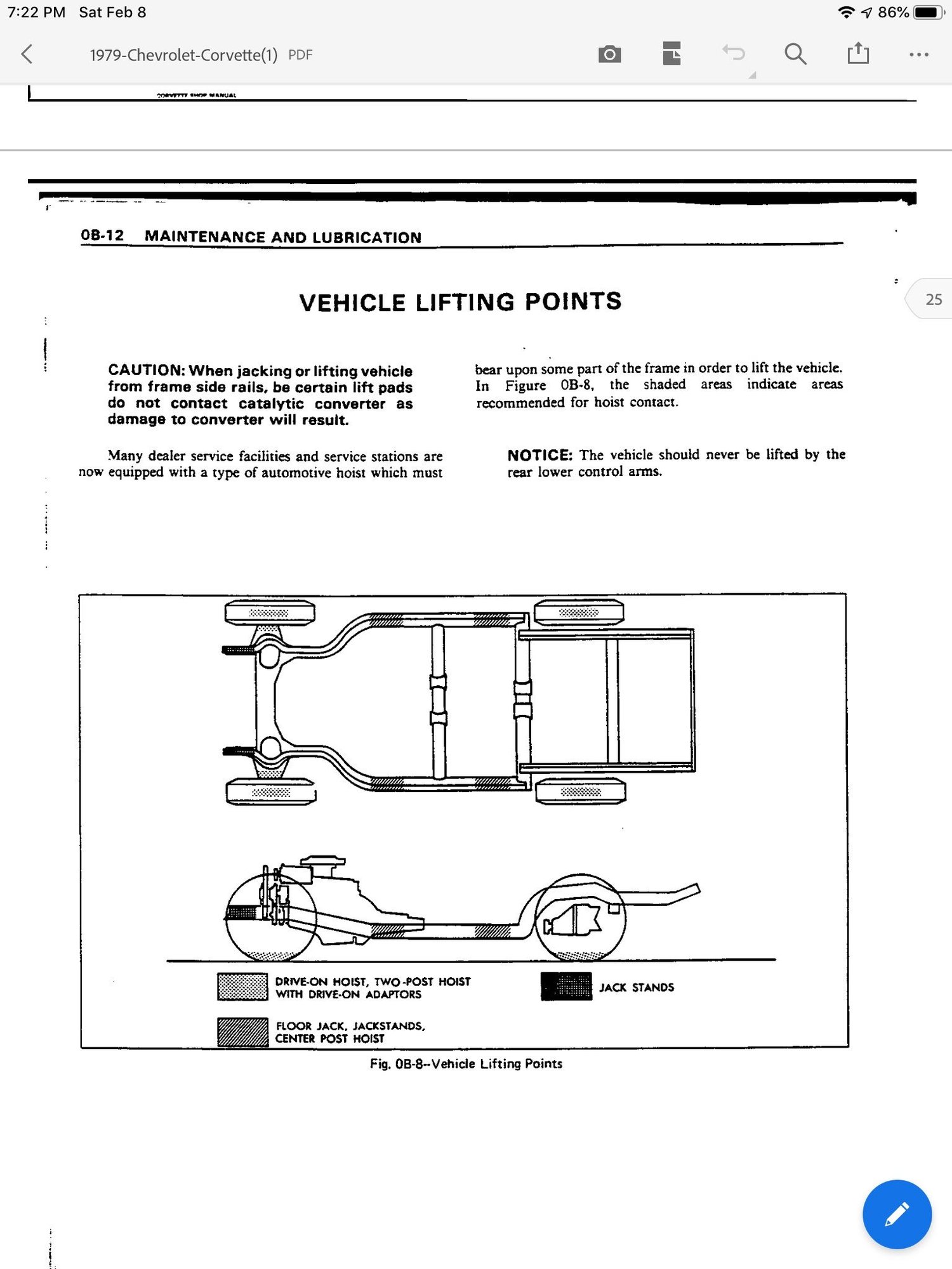

just replaced the plugs on my '79 last week, some tips that may help for next time
-- jack up the car at the recommended points only. leave the jack in place and use sturdy blocking as a safety. also
block rear wheels so the car won't roll. backyard mechanics getting their chest crushed under cars is not unheard
of. the unlucky ones only get partially crushed and struggle for awhile. google this, then be careful.
