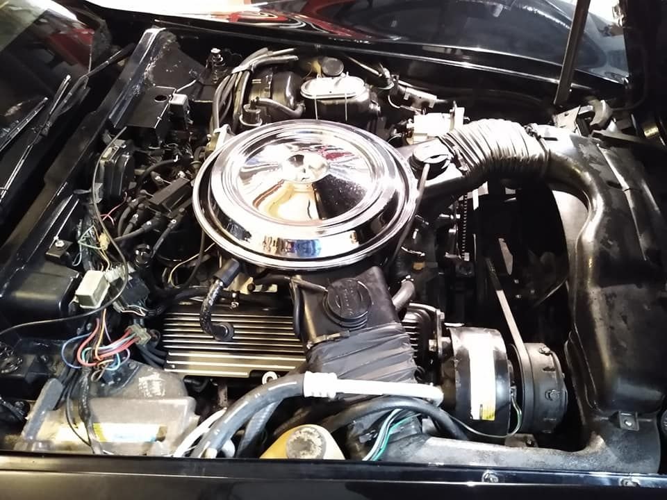

I took off the AIR and EGR system on my 81, rebuilt/ adjusted the carb, and replaced the computer with a rebuild ($84 from Auto Zone). So now the computer just controls the AF ratio on the carb, the distributor advance, and the transmission torque convertor lockup. Far less expensive than swapping the engine out, and runs fine. Not a race car by any measure, but a nice cruiser. Had it up to 120 and probably more than that.
If you car read the Shop Manual it's not hard to do.
By removing all the crap the engine looks good too:
To need advice on engine swap - '81
