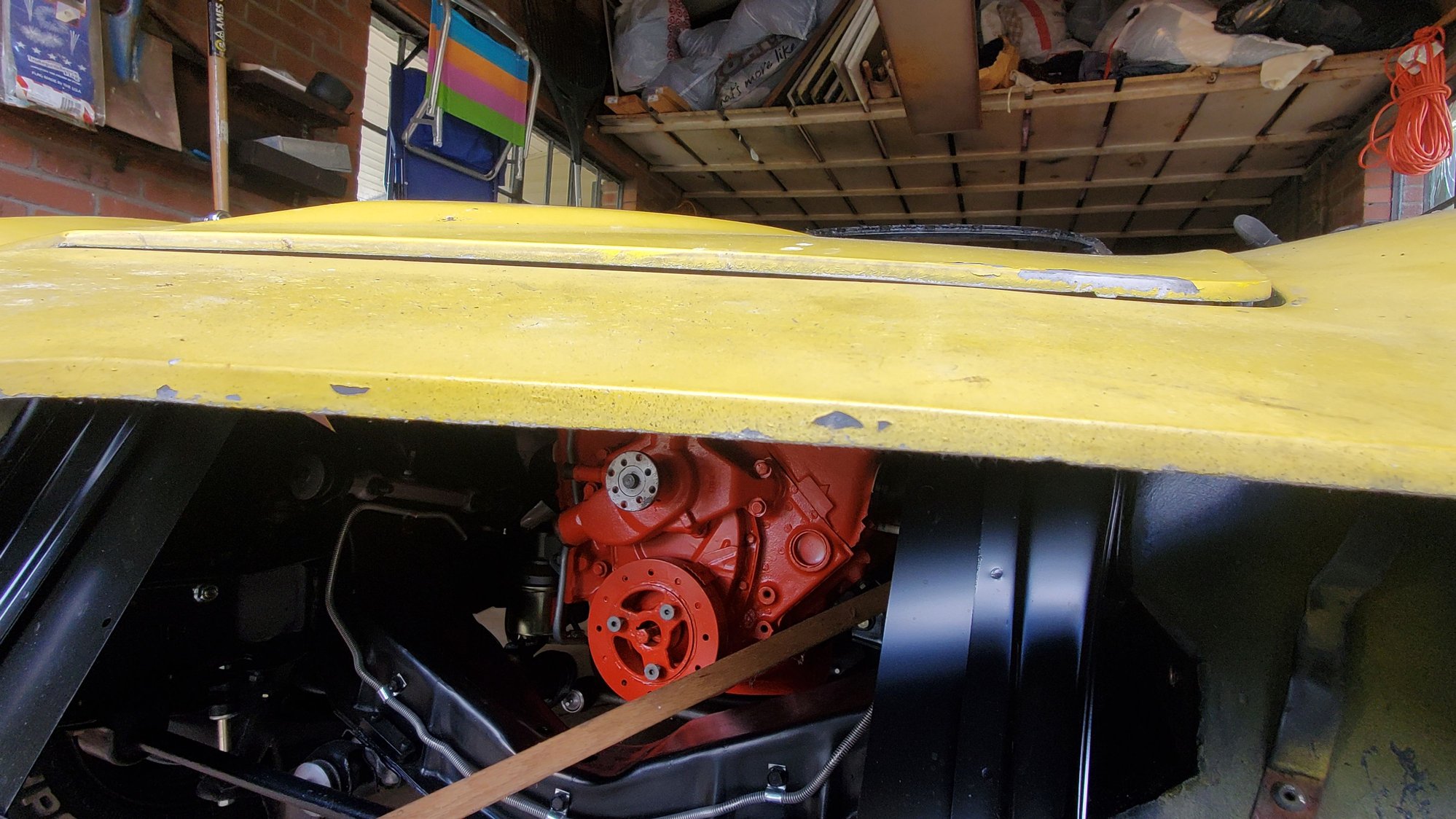

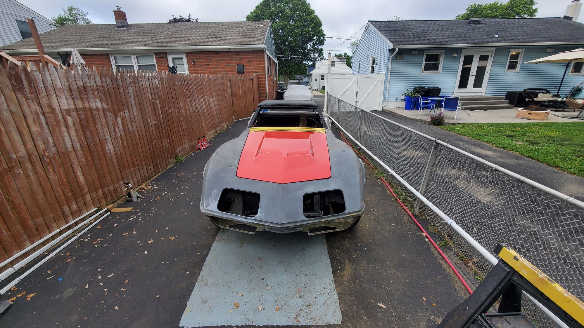

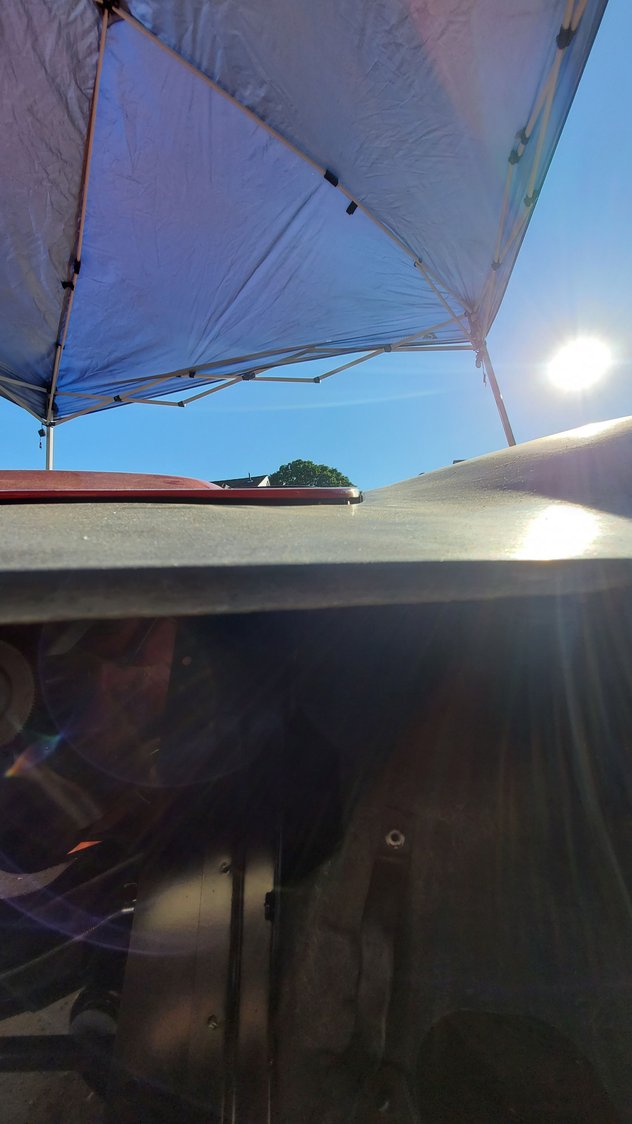

I have a 71 roadster I am restoring. I am in the process of fitting the front clip which is from a 72. When I dry fitted the nose the front driver's side cover of the hood sits above the surround about a 1/4 of an inch or a little more. Is there any adjustment for this? Passenger side looks decent. Not sure if it's the pitch is my front extension brackets? I got a BB hood for the car. So I fit both to make sure it was wasn't the aftermarket hood. Both were high. Stock hood fit well before before my car.

Looks like the inner guards are still bonded to the surround ? if so the only main adjustment is those extension brackets . You can shim the rad support to crossmember a bit ,also some shims under the hood hinges but your not close enough yet to "fine tune" anything .

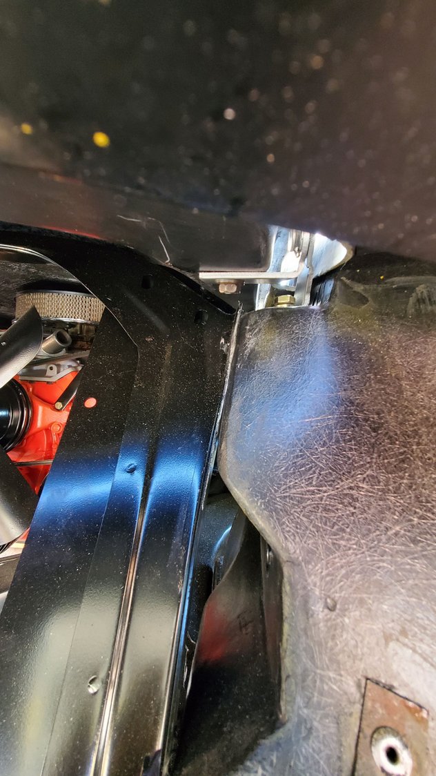

Car is sitting level ? second pic shows the holes in the front of the inner guards are uneven ,confirming that the drivers side of the clip has to go up .
Have you tried just putting the rear bolts in the extension mounting holes (loose) and getting a jack under the centre of that front crossmember and using that to control the positioning of the whole front of the clip ? You should really have the chrome bumper on as well (bolted just at the middle) , as the nose "curves" up and down the gap around the bumper and front of hood changes dramatically.
Leave the hood bolted but loose for now , you can tighten those bolts with it down enough easily enough later.
How does the surround sit at the windscreen base ? ,that will change a lot as you move the front . If its moving too far away from the correct position you can try using two small bottle jacks (or similar) at the back of those extensions , that way they can just go straight up and down .
Good luck , take it slow ,make small adjustments to get the feel of whats happening ,check the gaps at the top A arm to inner fender as well .

When fitting a surround, I always have the brackets that tie the outer bumper lands to the frame in place as there is a lot of weight on the surround forward of the hood opening. I also ensure the center support rod is in position. Make sure you constantly watch your diagonals and keep them as identical as possible.

the nose is bonded to the inner fenders, they are bolted to the rad support. inner fenders can be beat and droopy. and raising the rad support to raise the nose also raises the hood hinge and mount point an equal amount. it can be difficult to lower the hood hinge relative to the top of the inner fender it is installed on. don't count on glue. it has to want to stay where it belongs before you bond it.
