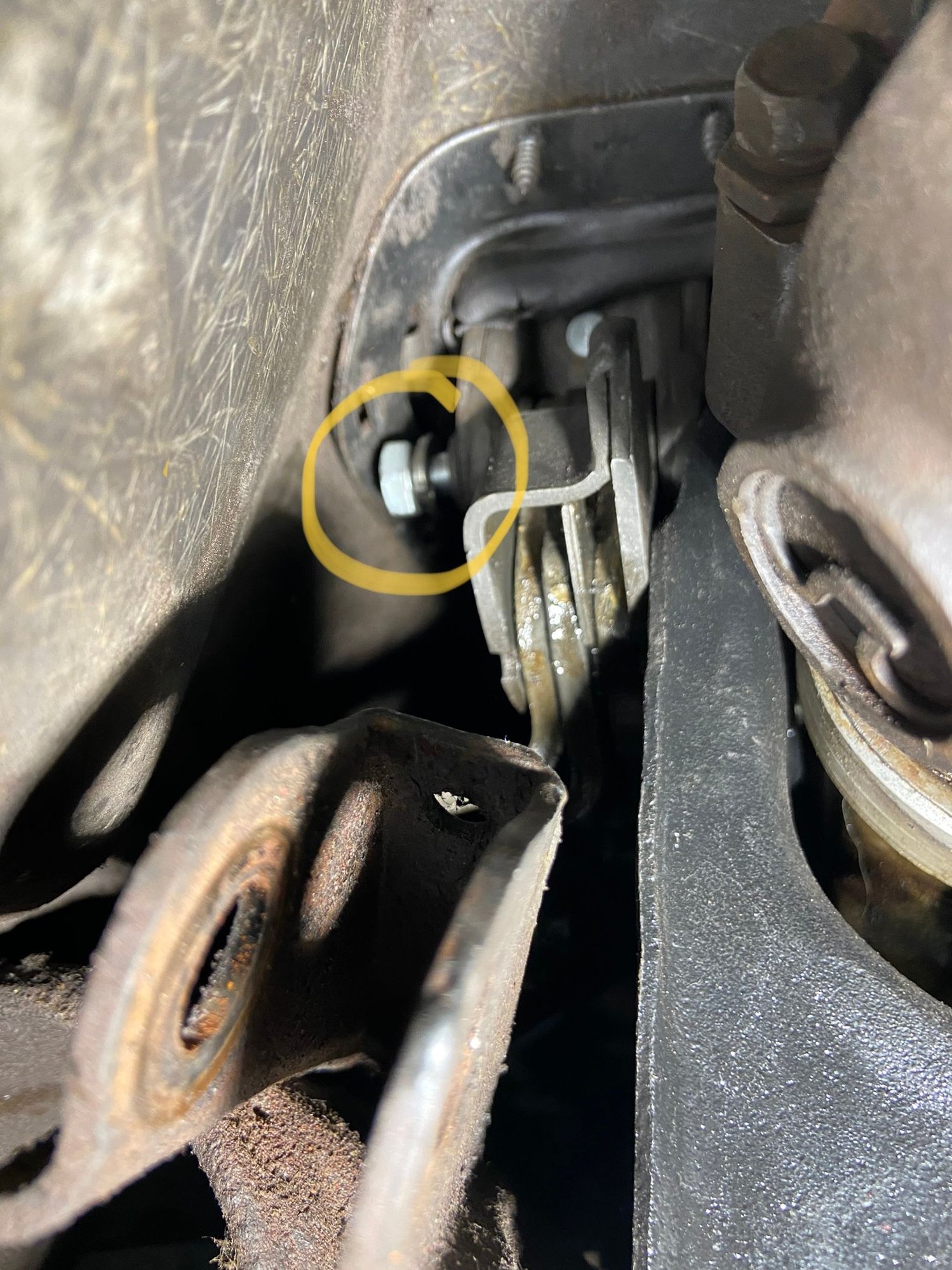

The shifter bolt in my 71 LT1 somehow came loose.
It is very tight in the tunnel that the bolt can’t come out completely. But it’s also impossible to get a wrench or tool up there. See picture below.
I removed the driver side exhaust pipe and pulley for the ebrakes for better access. Here are my questions:
- is this bolt threaded or is it a pin or clip keeping it in place?
- what’s the best way to tighten or secure this bolt? From the top by removing the shifter boot from the console? I hope I don’t have to drop the trans.
- what’s the best to keep this bolt from backing out again?
Thanks in advance for your help. Any pictures or video would be big plus.
Robby

That one is much easier to get from the top. pull the console and shifter boot. It's threaded in.

You don't need to pull the console. Just remove the shifter plate and boot. tighten from the top. 5 minute job.

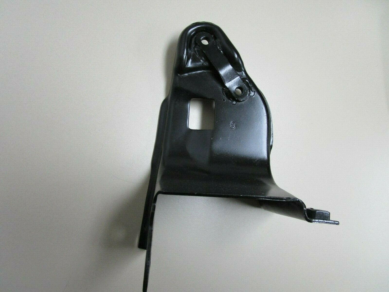

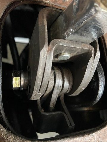

From the top and with the shifter inner/outer boot out I was able to see how the shifter bolt attaches to the support bracket.
On my early 1971 LT1 w/4sp. the nut is welded to the bracket. Somewhere along its 50 year life-span I think the shifter bolt was replaced with a slightly shorter one.
I put in a longer bolt so that it has a better bite to the welded nut.(see pictures). This should stop it from backing out. The locking washer and loctite should also help.
Replacing the bolt was the biggest pain.
Thanks everyone for your advice. Just waiting for new boots to be delivered and should be cruising this weekend.

Since you have a lot of threads sticking out, you might think about running another jam nut up those exposed threads to augment that factory piece of threaded strap metal.
Can't hurt.
