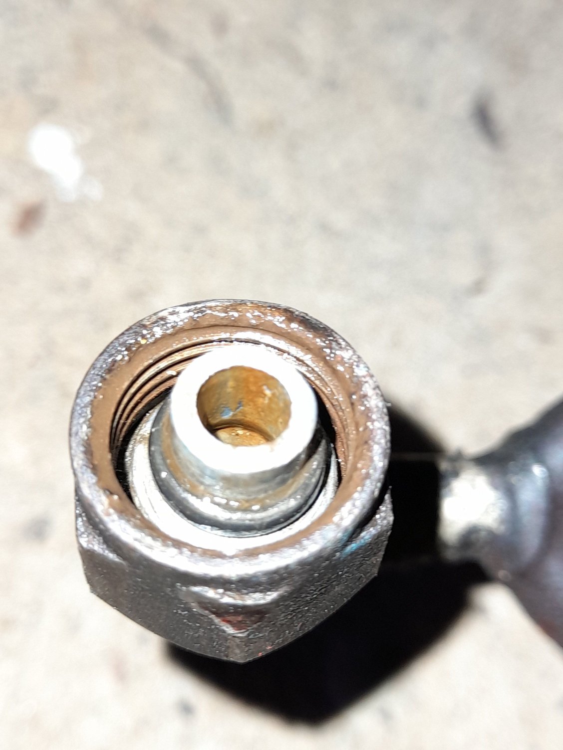

O.K., So being a Harley Mechanic all my life I'm no expert on air conditioning. That said. None the less I'm trying to repair / upgrade my air con. So, I purchased a aftermarket condenser. my issue is with hooking up the lower / liquid line. my original condenser has a fitting like this,

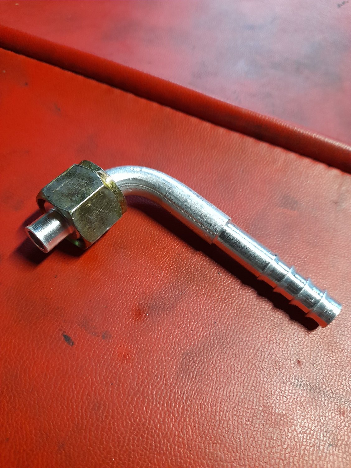

My new condenser has the opposite of this, or the female side as it where. And it came with a fitting like this,
As you can see it has a male end just like my old condenser. which is fine as this male O-ring fitting attaches fine to the new condenser, the problem is my liquid line is a metal line. what I would need to connect it is a 90 degree elbow like the one they included with the condenser, but with 2 male O-ring ends, not one barbed hose end.

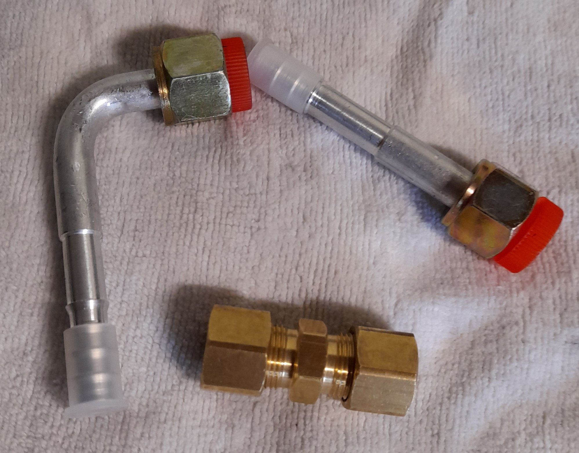

So I started with these 3 pieces.

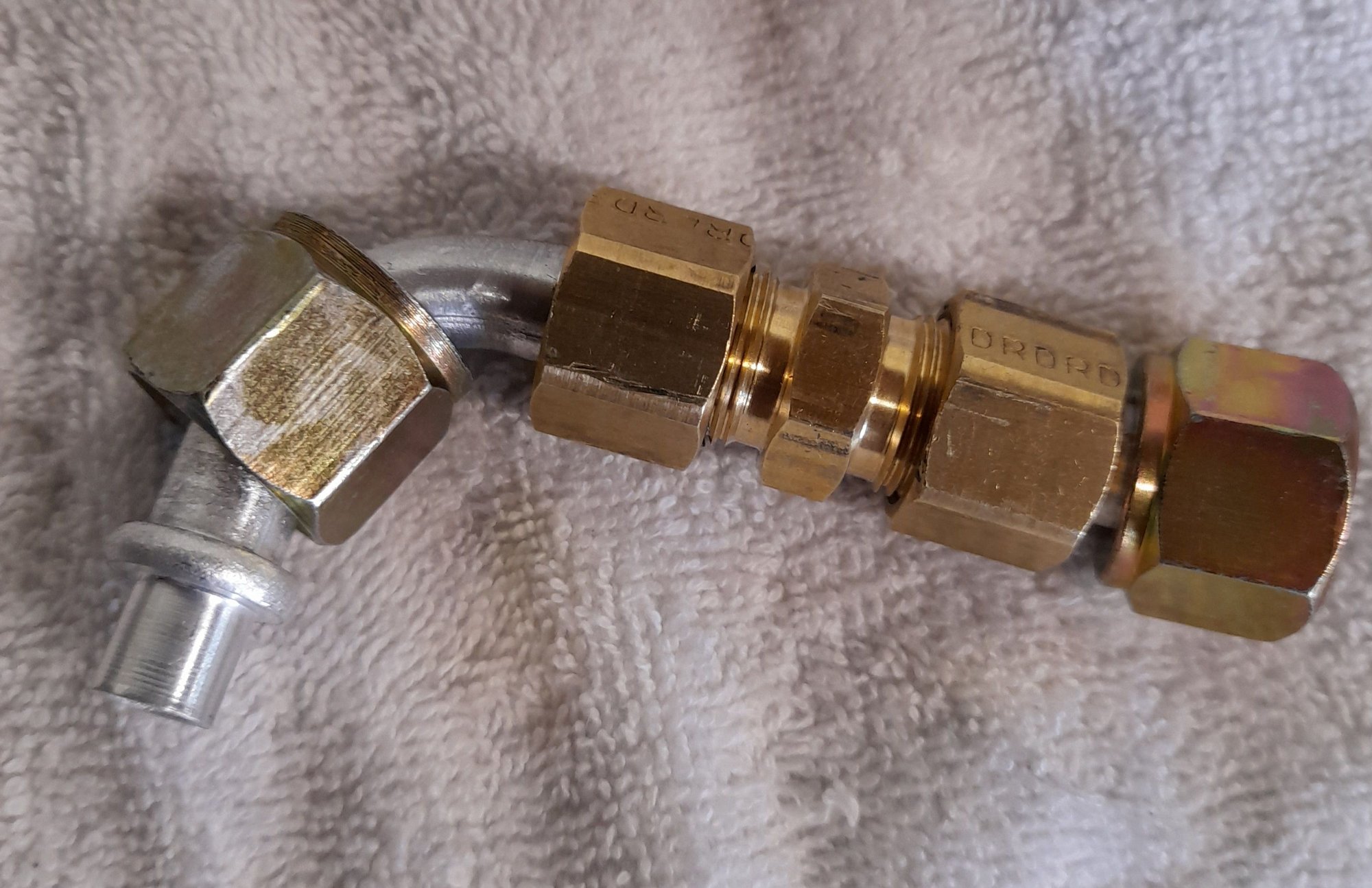

After cutting off the hose barb ends, deburring them inside and out. cleaning the pipes up real good with emery. and assembling I ended up with this. A bit longer on one side than necessary, but certainly workable.
Universal condenser connected to factory liquid line.
