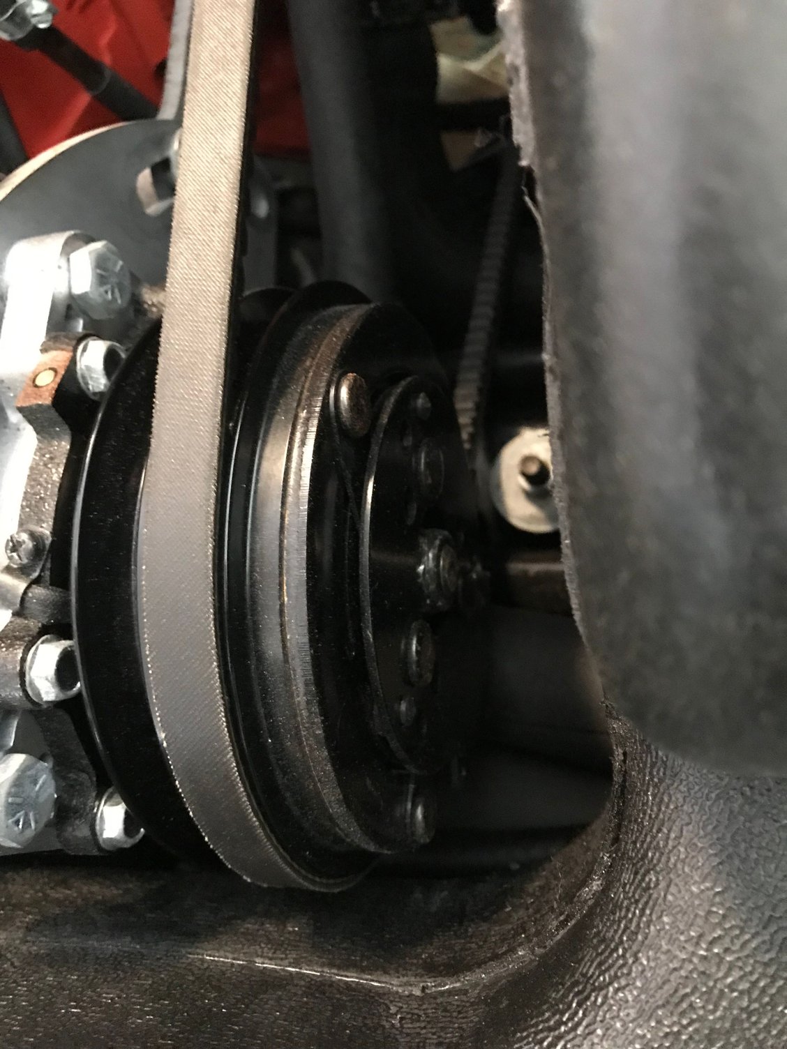

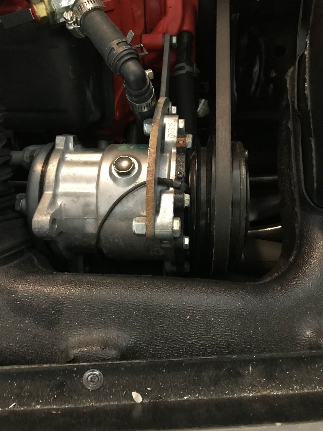

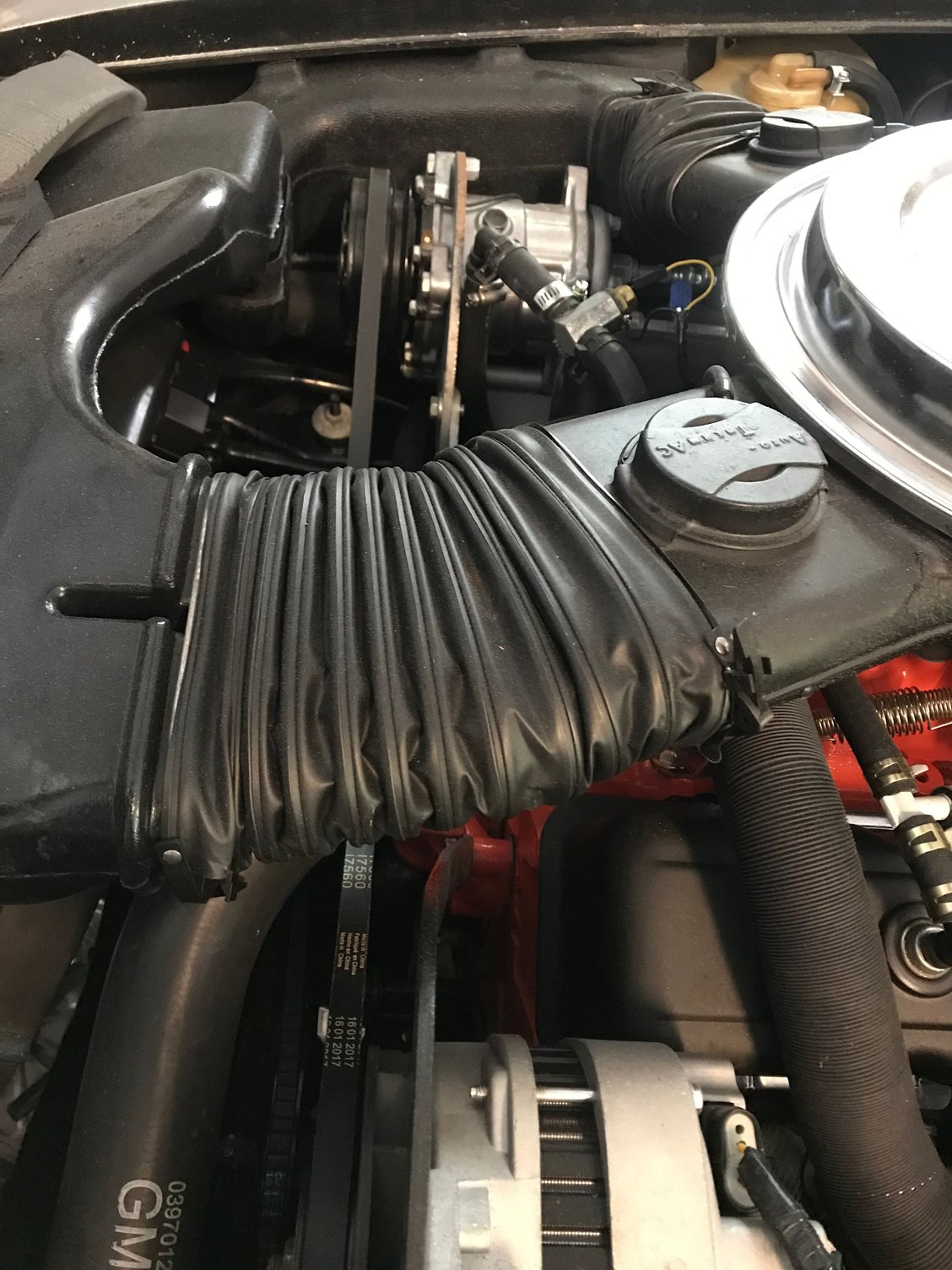

Regarding using the Sanden with the dual snorkel: my 77 had all the AC components removed when I got it. I was able to install a Sanden compressor using the Alan Grove brackets, and it fits just fine alongside the dual snorkel ducting. I’ll post a picture tomorrow if that would help.

I tried to get angles that showed both ducts and the compressor. The bracket isn’t really visible: I’d have to take things apart to show that. Hope these help.

Great sanden pics ...was everything ripped out when you put in? Or at what point does it go back to oem components?
just hoses and compressor and bracket?
MOdel or other details?

I went with the 508 style. It’s been a long time since I did the research but I think I recall the 709 would require changing the back plate for the ports so the hoses would fit (or something similar). I think it was a space issue since it’s so tight on that side.
I bought a unit that had the double groove v belt pulley so I could get the belt on the outer crank pulley. Don’t know your situation, but at least the double groove gave me a choice.
Also, you can avoid my stupid mistake if you pay attention to the voltage required to engage the clutch. I didn’t, and got a swell deal on a 24v model which required me to buy and swap in a 12v clutch. Oops.
