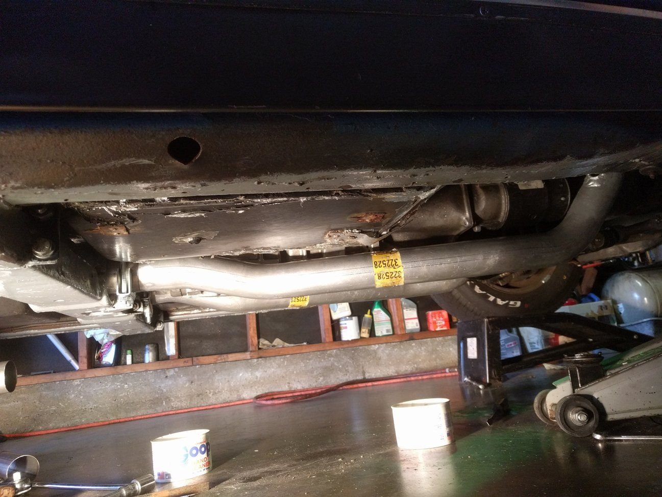

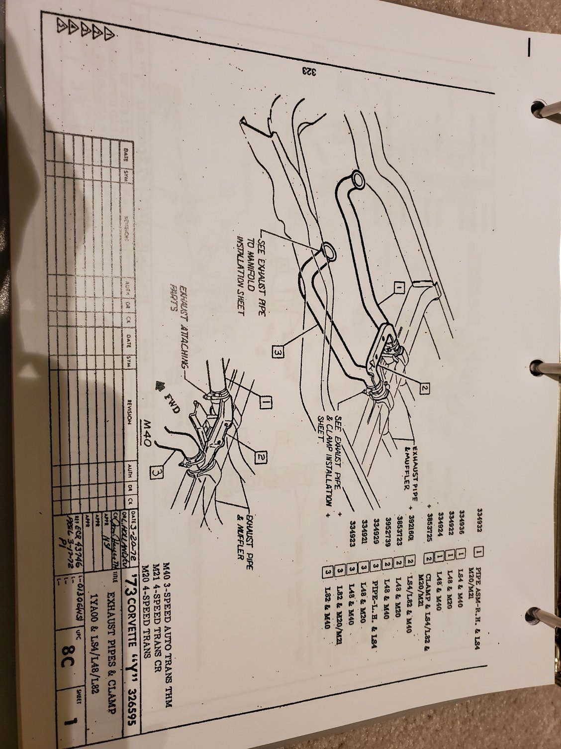

Hi guys, I'm wondering if the exhaust pipes are separated at the cross member underneath the transmission? See attached pic for location I am talking about, it's not clear to me from the AIM.
The reason I ask is because I am trying to figure out how I can remove the rear end of my exhaust/muffler in order to reach the rubber hoses at the tank (fuel separator on drivers side and return fuel hose on passenger side). My mufflers are welded to the exhaust pipes at the rear of the car, and it seems like the the only way I could remove the exhaust pipes is from this cross member point, if they are separate pieces here. Thanks in advance

Yes, there should be a slip joint right where those two muffler clamps are at the transmission exhaust hanger. If a gorilla did not install the clamps and completely mashed the pipes, you should be able to remove the clamps, put some heat (like from an acetylene torch) on the outer pipe to loosen it and twist them apart.

When I took my exhaust apart I got lucky - I was able to remove the clamps and then wiggle the pipes back and forth until they slid apart.
Usually I’m not that lucky. Since I don’t have access to a torch either, a hacksaw works too. I use a hacksaw blade in my reciprocating saw and it goes through exhaust pipes like butter. Harbor Freight sells them pretty cheap. Your arms will thank you 😊.
