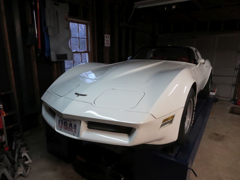

Welcome!
Feel free to take photos of cars you are considering, and post them here for a bunch of opinions (some of them useful!). Remove the kickpanels, and look for rust at the #2 body mounts, on the VIN tag, and at the upturn of the frame in front of the rear wheels. It can hide behind the dash, too, which is easier to see with a later C3.
And go ahead and buy this license plate now, to match your name. The flat printed one is a disappointment, pictured below is the "embossed" version (like a real license plate), but who knows these days with Amazon sellers.
