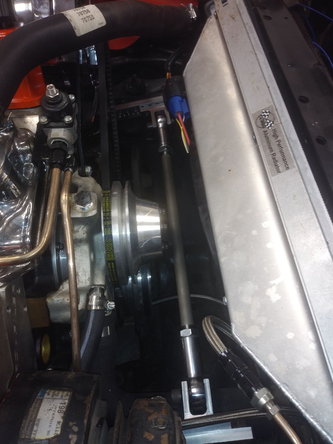

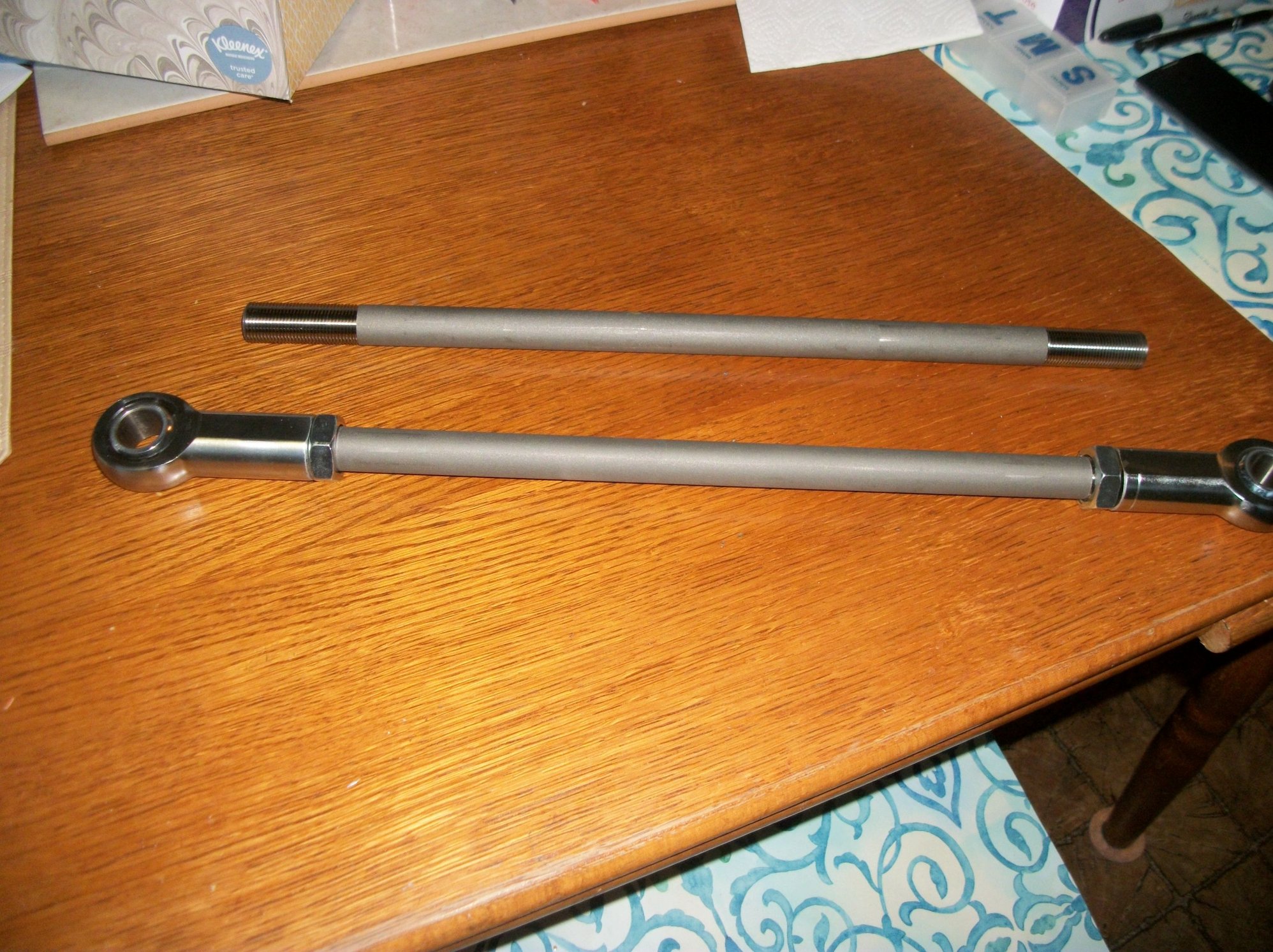

Had a chance to play a little so I decided to make an adjustable bar. Bar is titanium with chrome moly rod ends.

I like the titanium idea, strong and light. How did you manage the thread tapping toughness with that material?

Did you use Ti bar or tube?

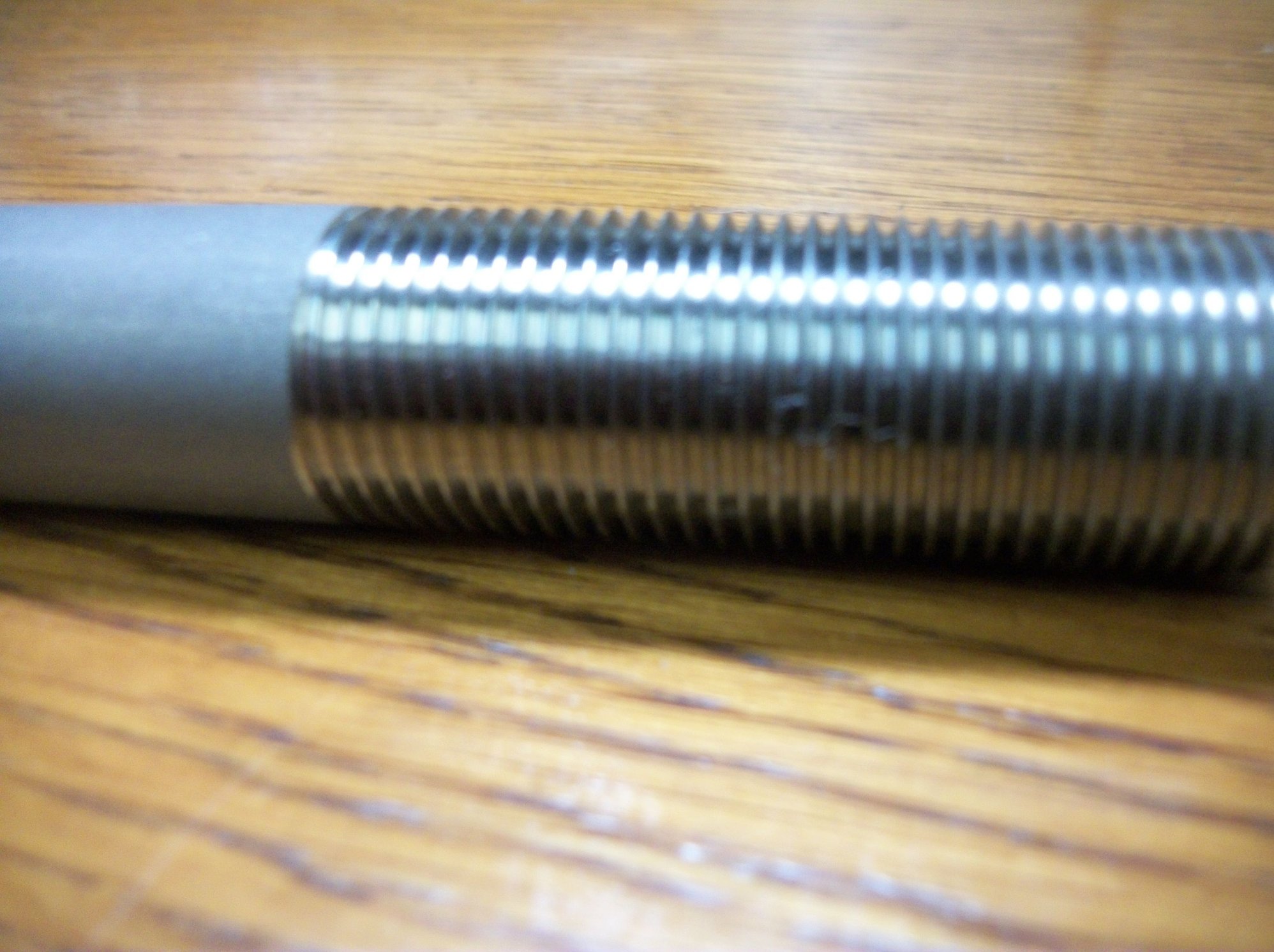

I can answer two questions with one picture. Threads are single point turned on cnc.

Close up picture of threads.

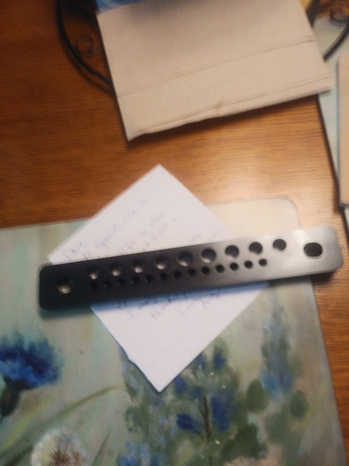

Mount and bracket black oxide coated.

Fully adjustable in all directions 😳 ???

Yes
