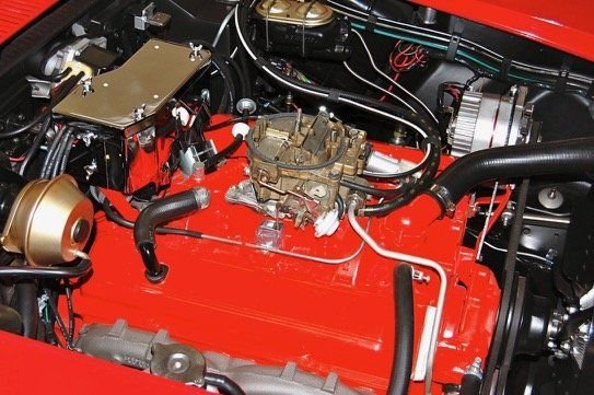

Notice Alan 71's front belt from water pump pulley to crank pulley.

It's not that hard to install the WP to Crank belt. The important thing is to get the right size belt.
If you owned a Big Block, you would be installing that belt on the rear grooves.
Here are some tips from a fellow member:
