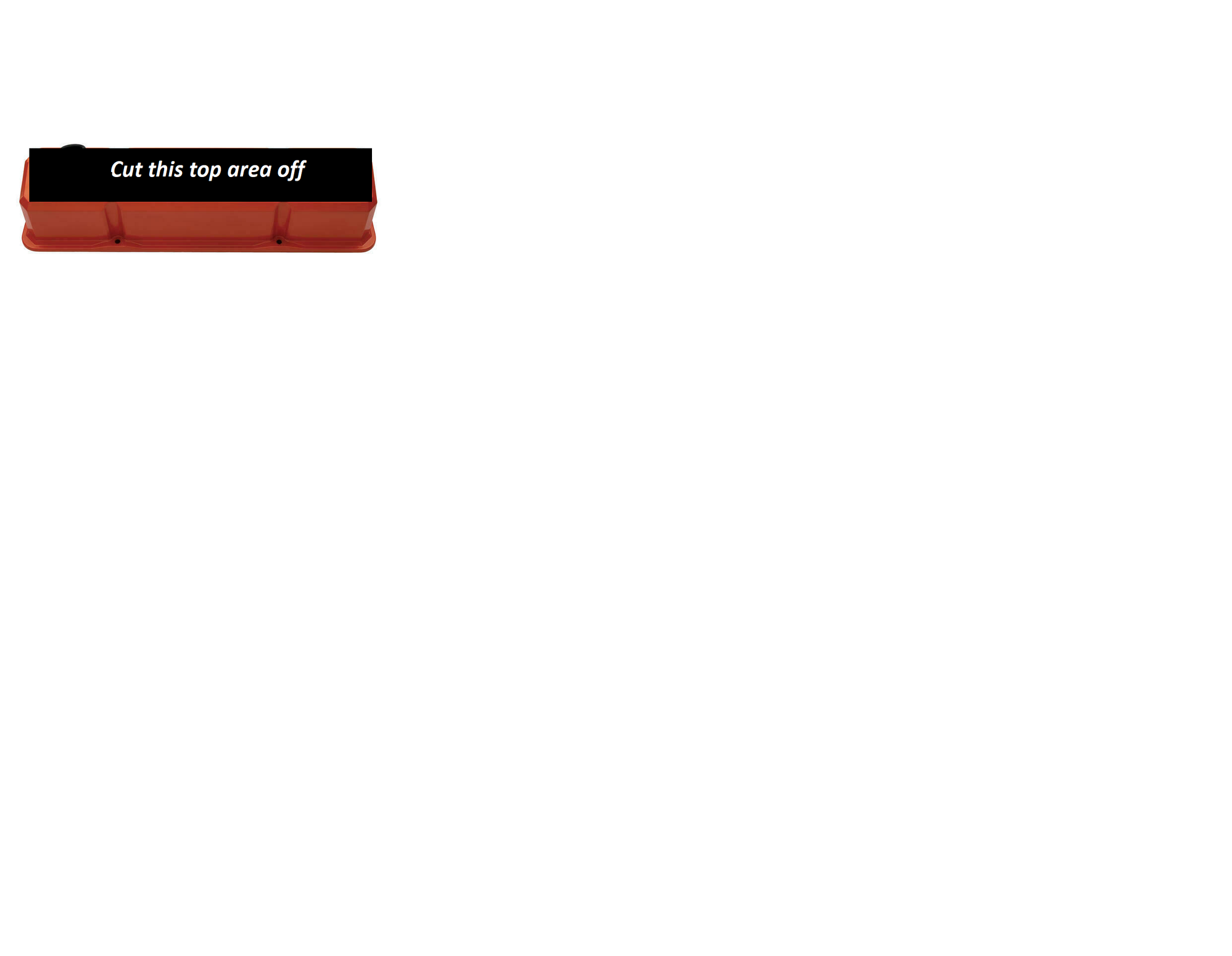

Modify an old tin valve cover by cutting the entire top of the cover open...install the modified cover.......you can see/hear/adjust rockers without getting engine oil everywhere....
