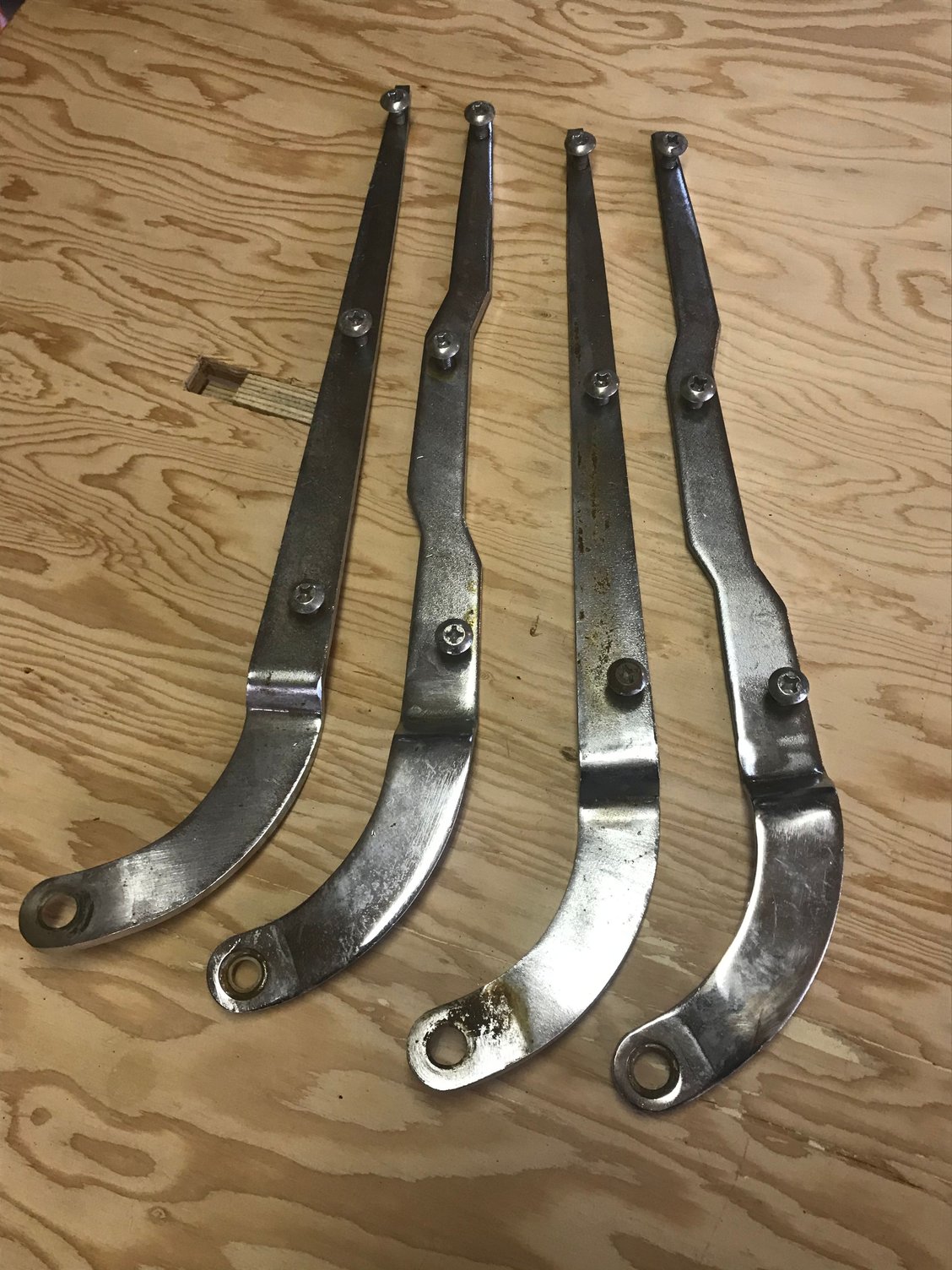

1978:

Originally Posted by Dodosmike
I have a used set for sale, with the bolts
I think I have the plastic grommets for the hinge hole too
Need a good cleaning. Better pics available if your interested
Those are for the earlier Vettes and will not work for the 79-82. This is what they look like.
correct. Should have mentioned that. Old style seats. These are from a ‘78.
sorry to hijack and add to the confusion
