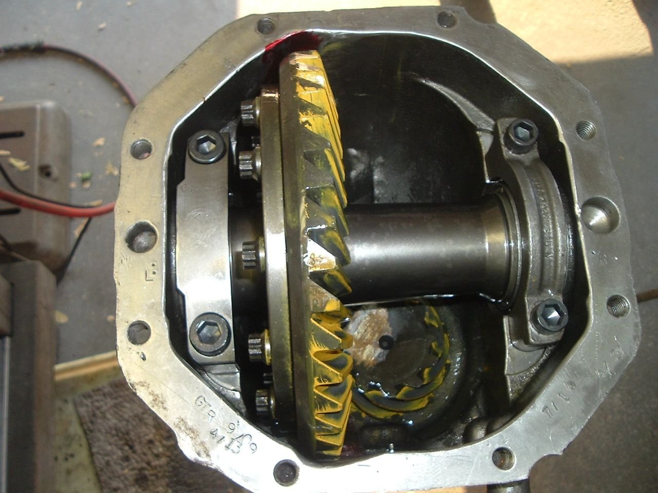

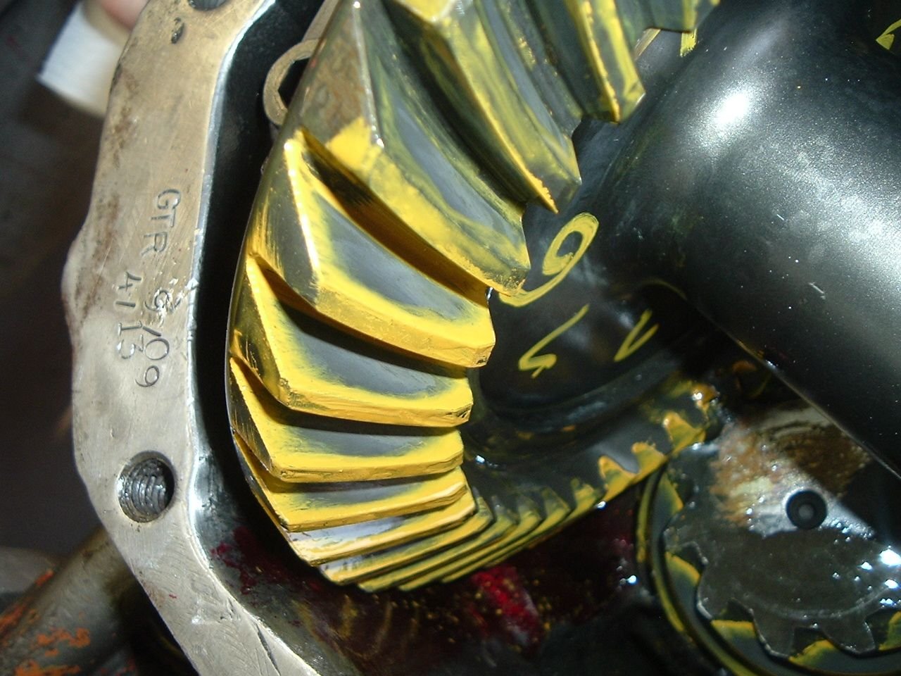

After 12 years of abuse a couple of teeth decided to come off the pinion of the old mule, not unusual with power and abuse over time.

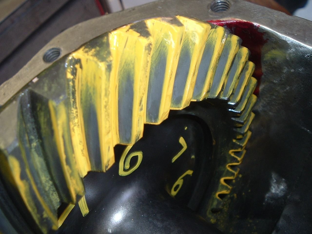

So the L82 Kid wanted to test a spool so this is what he built in my shop. It will be interesting to see how it responds on the street but this is not a road car that will be driven more then 30 minutes at a time, more like 10 seconds at a time. He did a good job and got a nice pattern.
If you need a spool I would use a 12 over a 10 any day of the week. The gears are Tom's and for those that don't know they are special made since stock 12 bolt gears won't fit. This is matched to 1480 axle and 31's on the side. The Kid did a job I would use and I doubt the RG bolts are going to back out like some 12's I have read about in the past. If he doesn't like it I still have some of Tom's NOS 10-17 x 30 spiders and a new USA made bare case on my shelf he can use.
The best part was I didn't have to build it and just played ball with the dog.

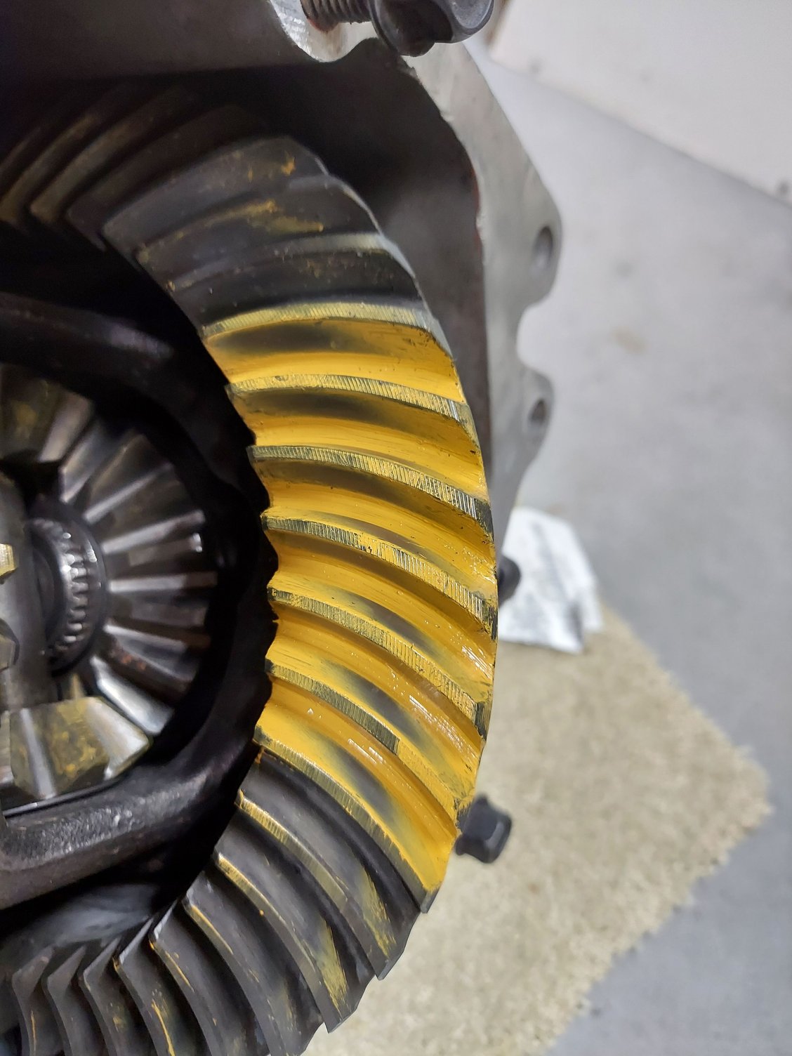

On another subject, what do you think of this pattern?

Angular pattern, 2 cut straight teeth, lash is different for the 2 cuts, this looks like an DANA diff. Pattern is center on both the Drive and Coast, if it's spins smooth you are probably dialed in but check the lash for that gear set. Axle face shows chamfer still and light wear.

Yes, it's the 4.30 Dana 44 we discussed the other day.
