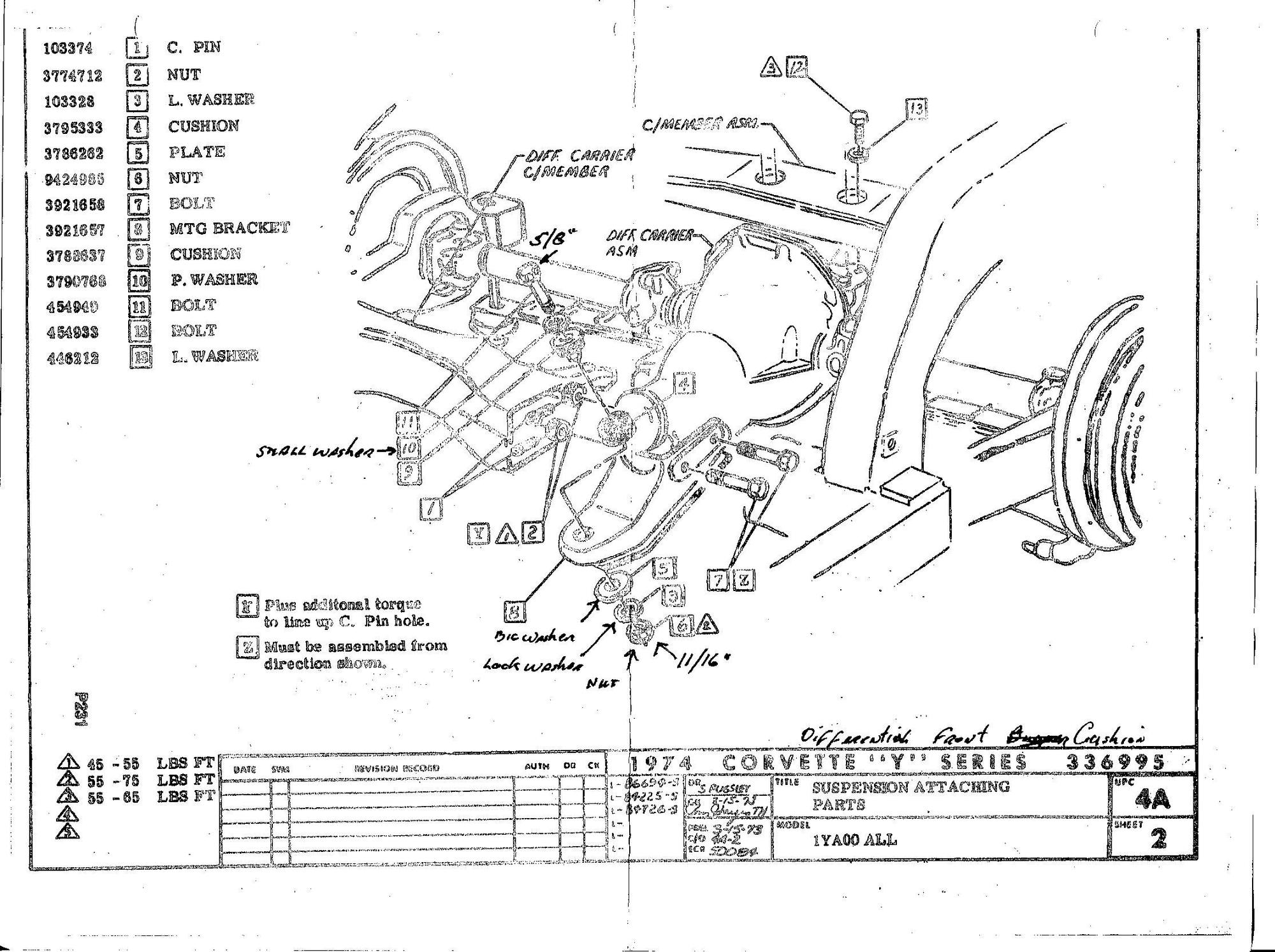

Default Does this help?
Old May 23, 2021 | 07:22 PM
captng1's Avatar
captng1
Joined: Mar 2020
Posts: 108
Likes: 8
From: Fort Lauderdale, FL
Originally Posted by Peterbuilt
Yes. Thanks Peterbuilt
To Drive Train Klunk

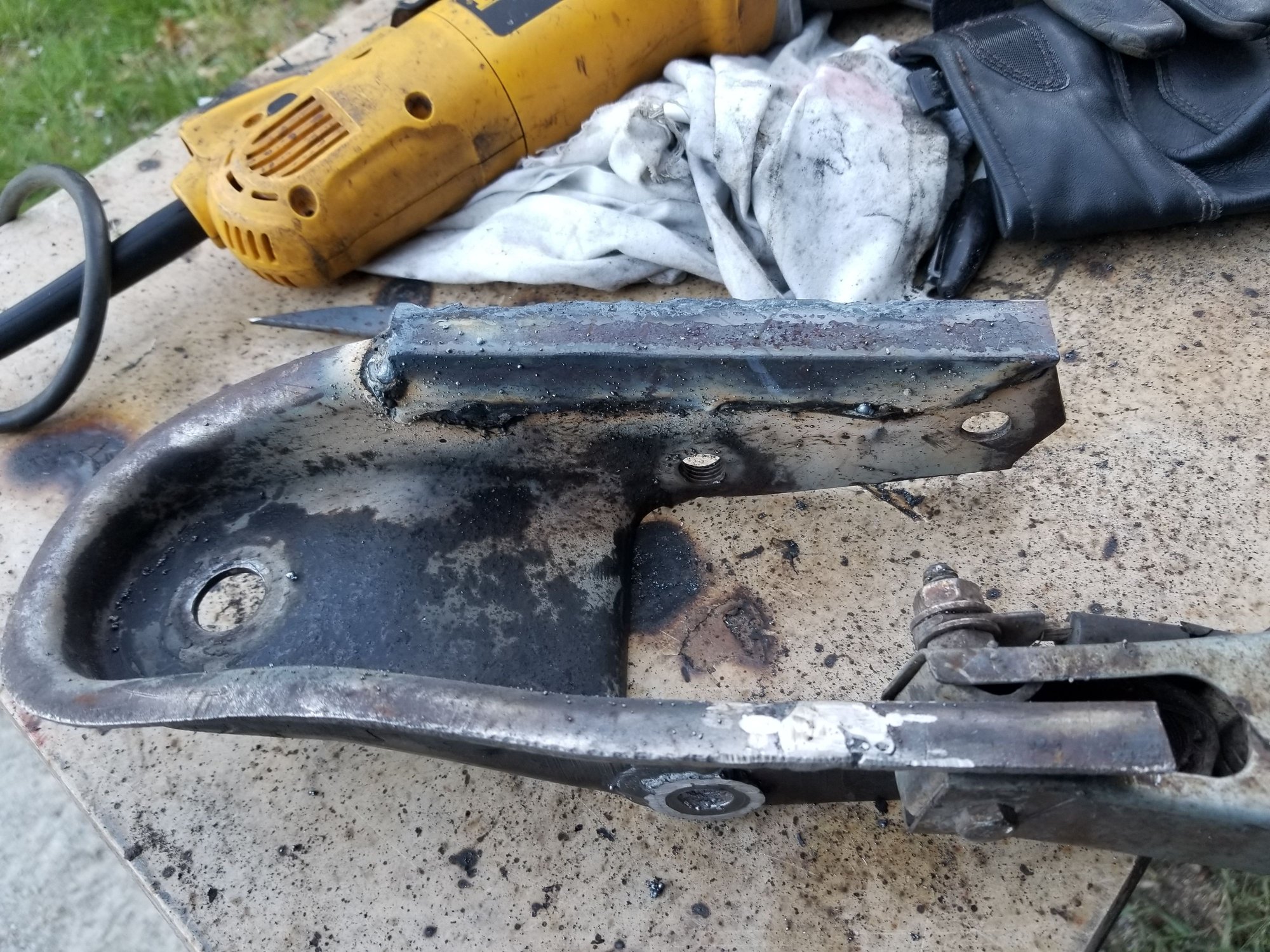

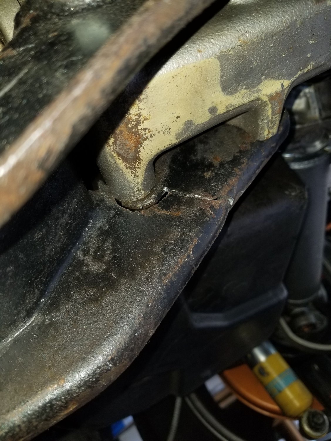

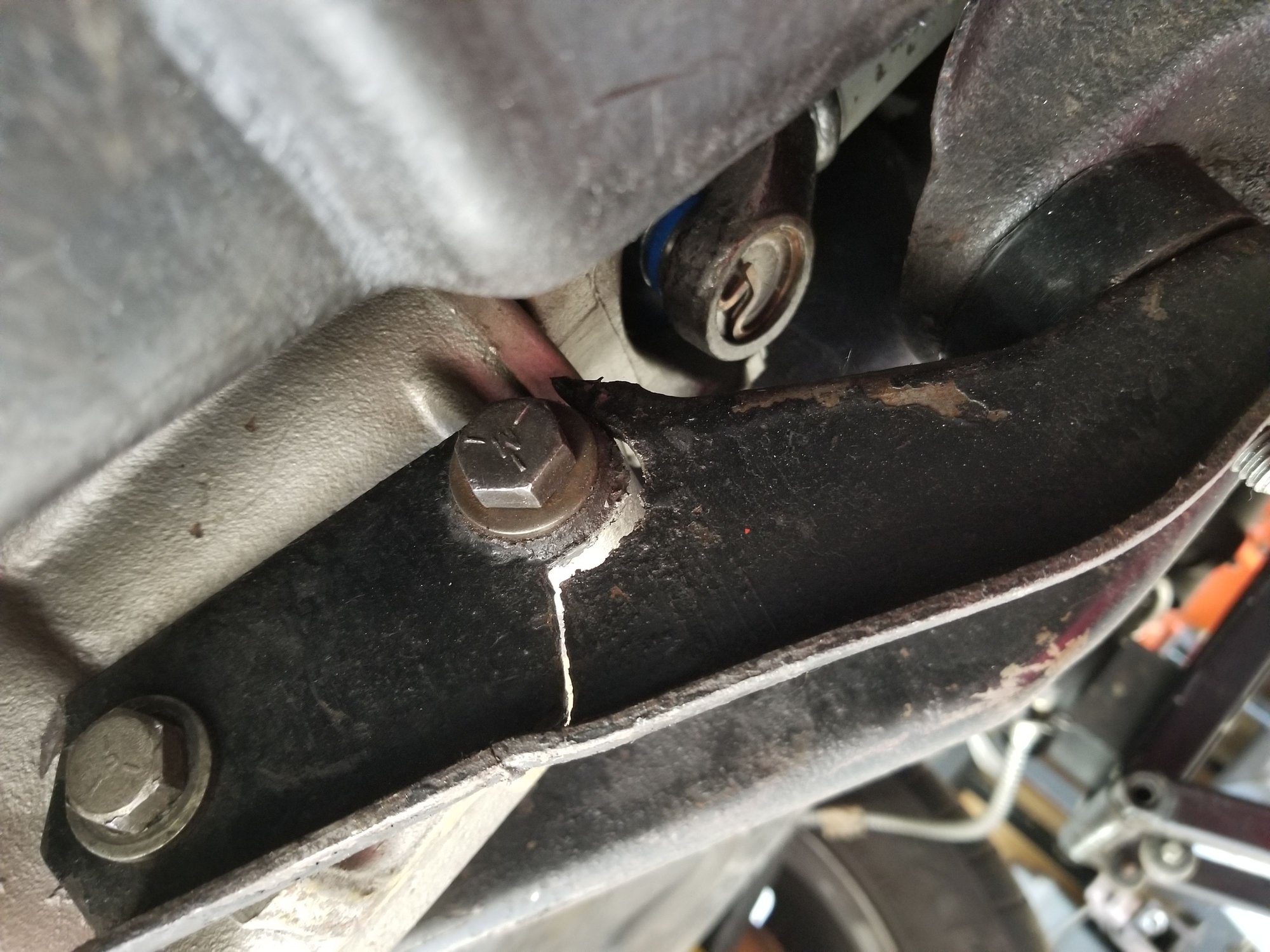

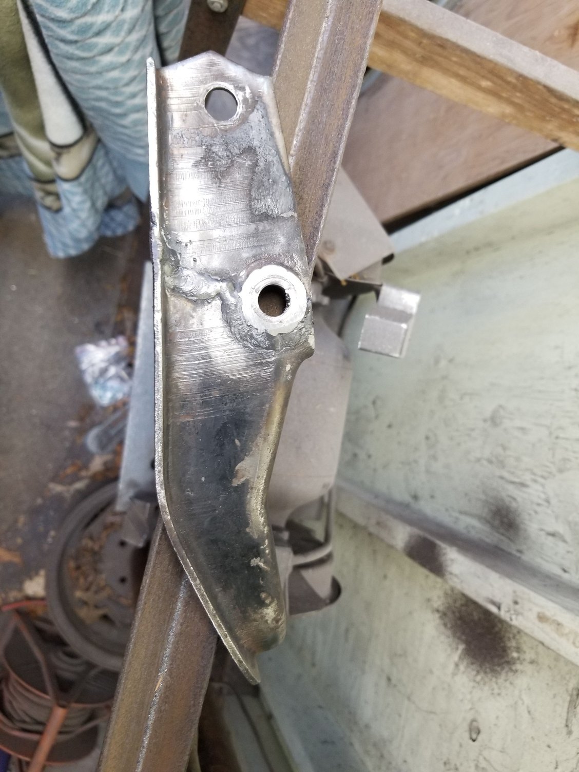

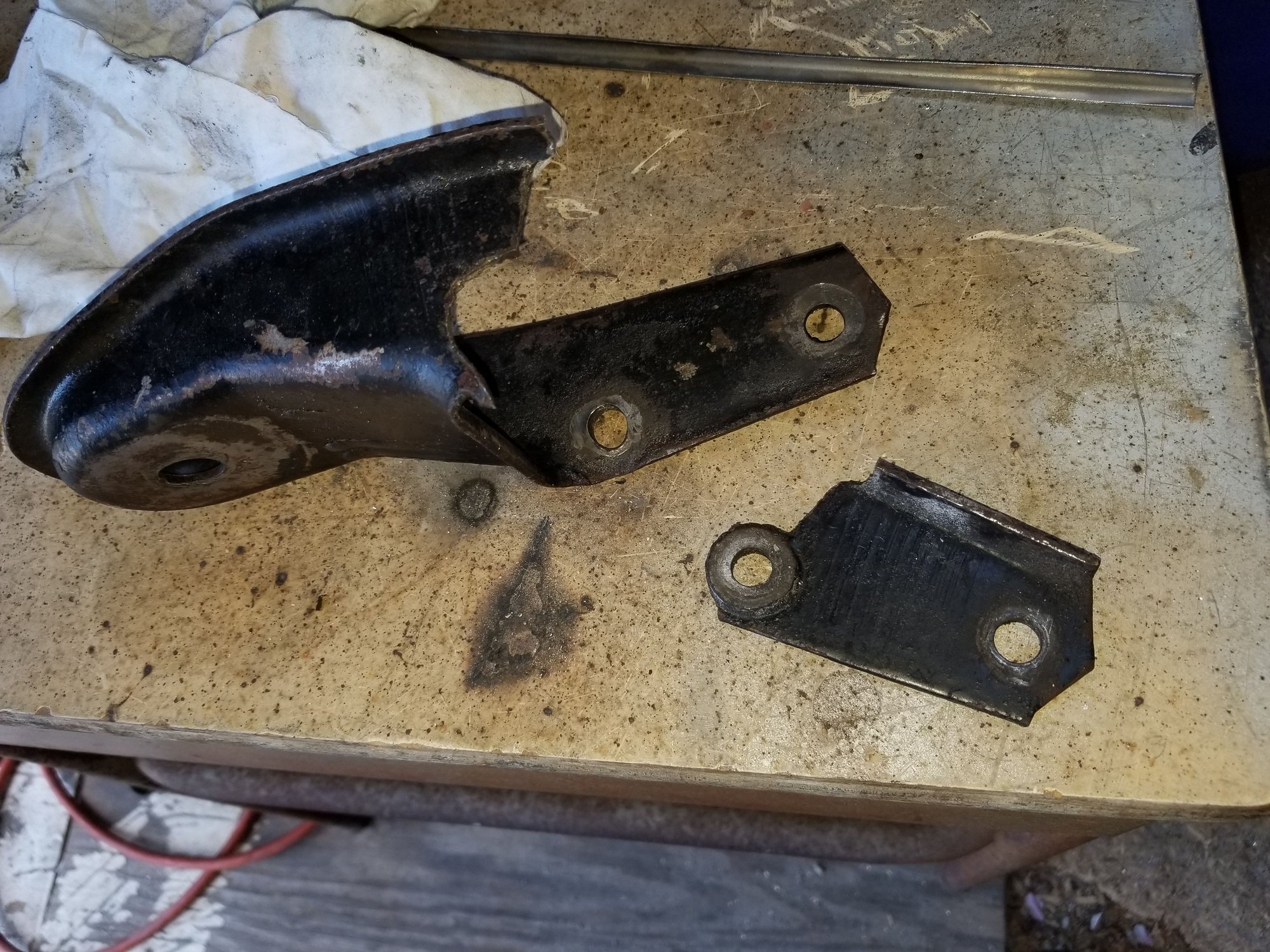

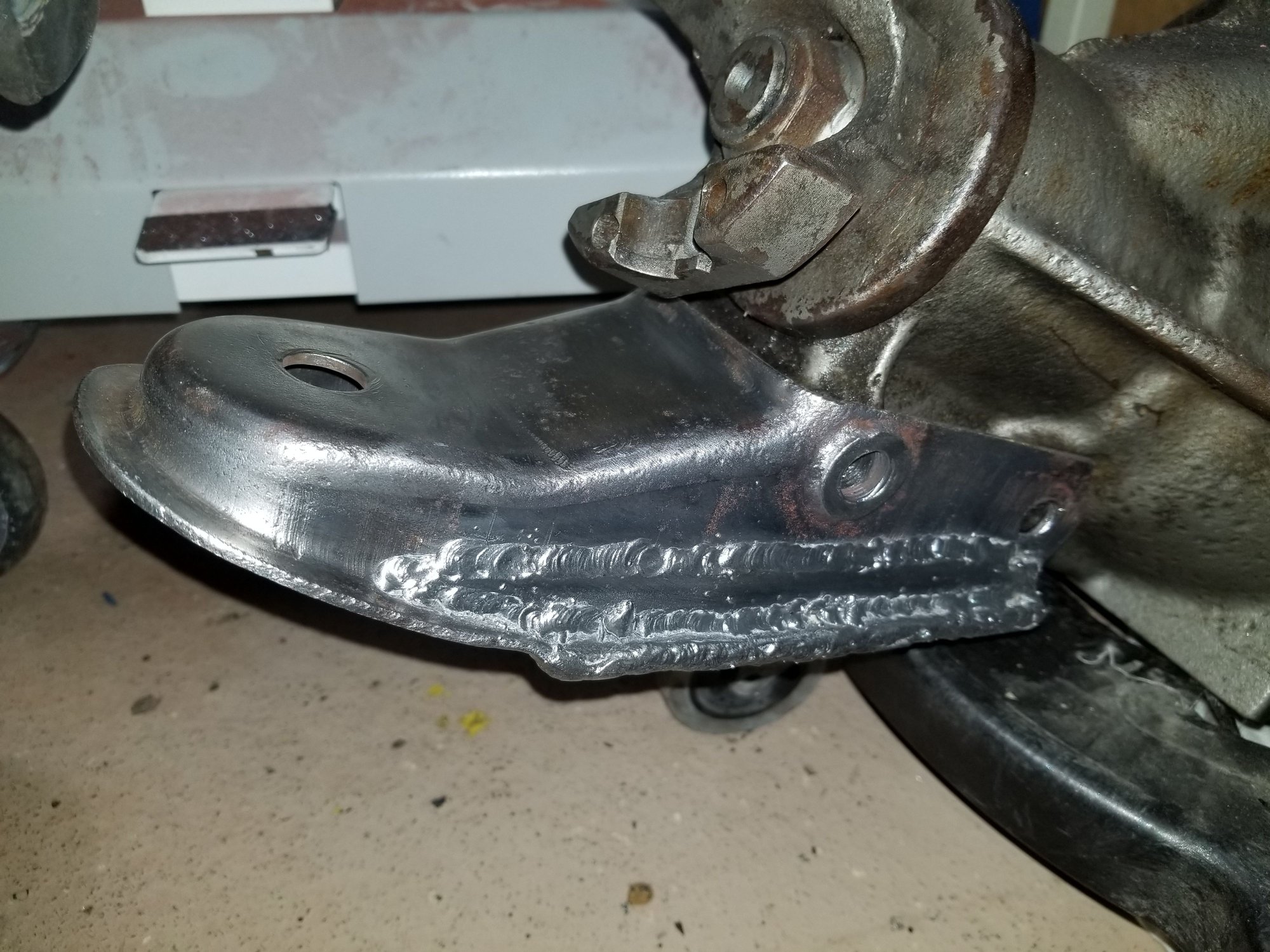

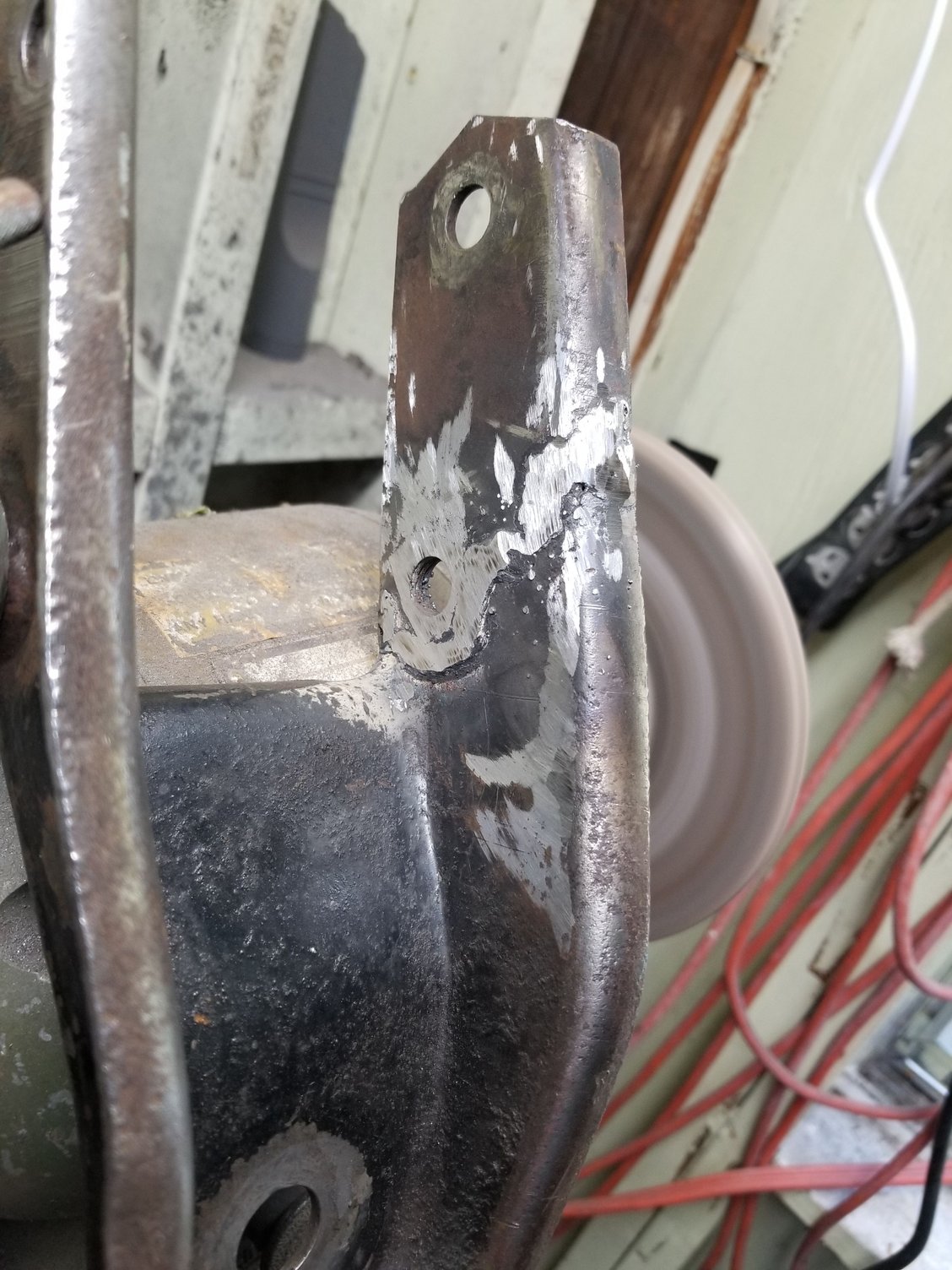

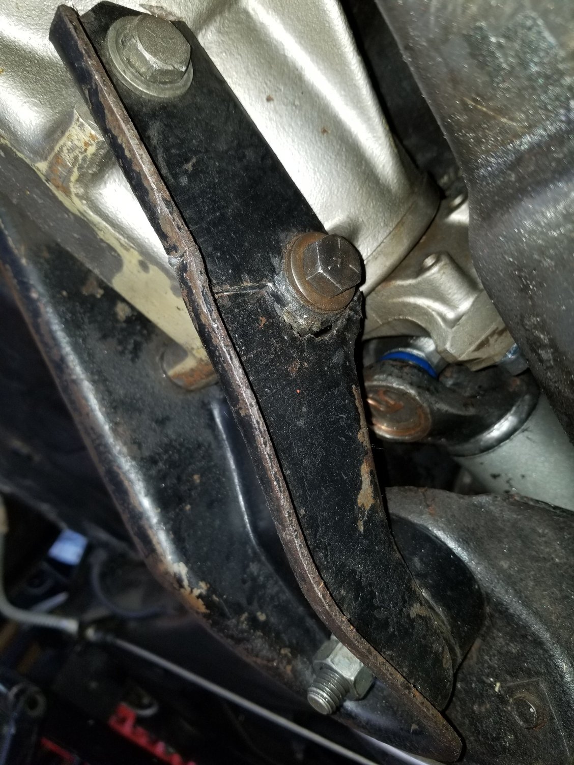

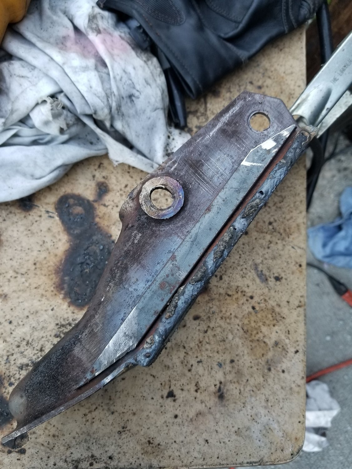

My clunk was a combination of these after installing new u joints on the driveshaft and half shafts and driving it about 100 miles
  1. broken snubber mount
  2. loose caps on half shafts
  3. loose caps on driveshaft
after tighten them and welding up and reinforcing the snubber mount I bought new grade 8 bolts and nuts, with a little extra length for secondary lock nuts. The shoulder was too long and event though they were "tight" the bolts were not pinching the snubber mount to the differential enough and an occasional clunk would occur on harder acceleration or heavy downshifting. Adding a few extra washers as shims under the nuts and a second nut as a locking nut eliminated all clunking on my last drive with a few hard accelerations, no clutch drops though.
thought it was a hair line crack
then with a light it looked worse
I unbolted this and that piece landed on my face
stitch welded it inside and out
ground the weld flat internally and mostly flat on the outside
added angle iron onto the bottom and inside a and a small plate on the outside. I reinforced both the left and right sides. Added grade 8 washers to all the mounting holes and welded them inplace
test fit on another rear end before welding on the washers
The newer model mounts have a thick piece of steel tack welded to reinforce the holes, but there is only a few welds
