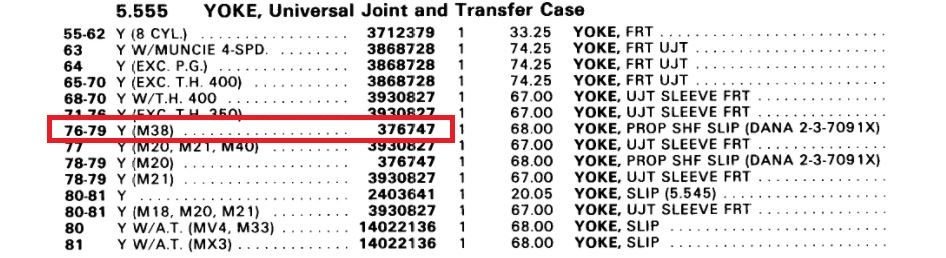

Are we saying a 1330 with straps is not being produced? Was there one from the factory?
Look like GM part number for 76-79 turbo 350 trannys (M38) is 376747? But when I find those they do NOT have straps?

Correct, I'm saying the slip yokes used on the mid-later c3s with the straps that were used for a th350 are no longer being made according to many threads here and websites like Dennys drive trains in The link above.

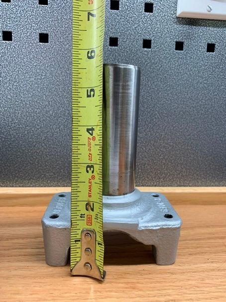

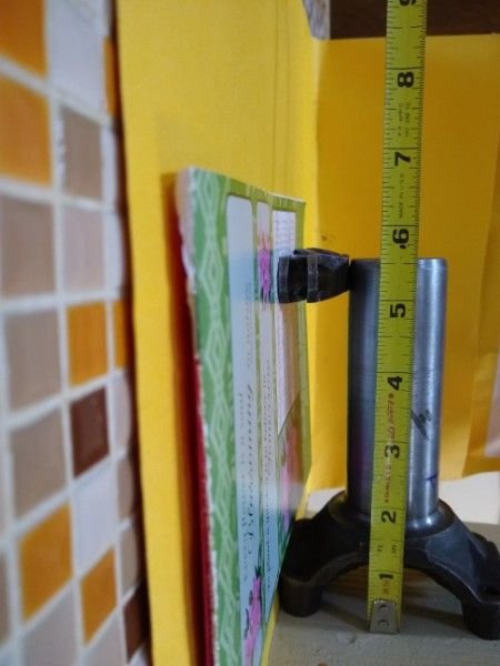

Can someone provide a length measurement on the stock THM-350 slip yoke?
Is the Muncie M-21 Slip Yoke LONGER than the late 70s THM-350 slip yoke?
My M-21 slip yoke which is ~5 9/16" from flat surface (about middle of u-joint) to yoke end
My Muncie M-21 Slip Yoke fits into the 200-4R I am installing but there is no wiggle room at all. I am willing to cut it but now I am curious what the length of the THM-350 slip yoke was so I can approximate that.
I am installing a 200-4R and my 1968 Muncie-21 slip yoke goes right into the 200-4R, but it doesn't leave any wiggle room for expansion. Was the Manual Tranny slip yoke longer than the THM-350 slip yoke?
I can lop off 5/16" to 3/8" from my slip yoke easy enough, but I'm now wondering if the THM-350 (later in the 70s C-3s) slip yoke was actually shorter than my M-21 slip yoke?
Attached is a picture of my M-21 slip yoke which is 5 9/16" from flat surface (about middle of u-joint) to yoke end.

I’m led to believe that my Spicer 2-3-7091X (1330 U-Joint with straps) is a Corvette TH350 Style 27 Spline Driveshaft Slip Yoke.
Confirmed measurements:
3 5/8" = Ground Hub Length
5 11/16" = Centre of the U-Joint to end of spline (overall Length)
https://fortwayneclutch.com/product/...sku-2-3-7091x/

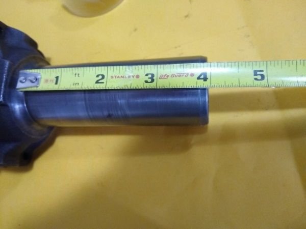

Kidster71
..and other Folks,
Ok, I trimmed the GROUND HUB LENGTH on my M-21 yoke to 3 & 19/32" ground hub length.(which is 1/32" less than 3 5/8" which was reported by Kidster71 ).
I did a pre-installation check into the 200-4R and it looks like I will have about 1/4" of free play to seating against the inside of the tranny once I hook up the U-joint.
I recognize that the differential and tranny are both essentially stationary but if I need to trim more off now would be the time to do it.
Is that sufficient free play for heat expansion and whatnot?? I really don't know how much is sufficient

Pending further responses I ground down the barrel length to 3 17/32".... Which is less than a report I got of the Corvette Turbo 350 barrel length being 3 5/8".
