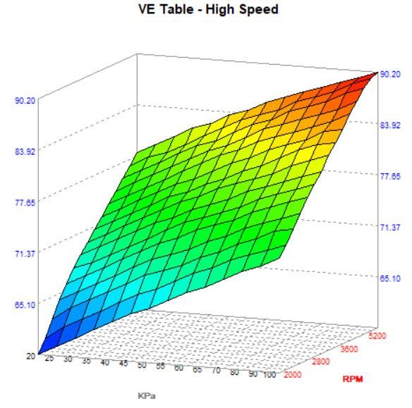

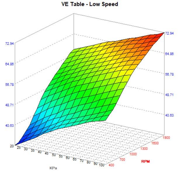

UPDATE: Making progress on the new tune. The VE low speed and high speed tables are almost done and looking pretty good. It revs pretty fast right now which makes me happy. Added just a little power to it to see how she would react and it likes it for sure. The temps here are brutal right now and the tuning may stop for a couple months and pickup again later in a few months. Even with very high temps here and me only doing the data-logging in the evenings at 105*, the motor temps are staying at 179* which is awesome. Here is the low speed VE table and looking pretty good along with the high speed table, nice transitions now all the way up. This is Bin10 so far and haven't data-logged this bin yet. These are the changes from bin9. The new TB project is moving forward, but had to wait on some parts to continue. More on that as it develops.
