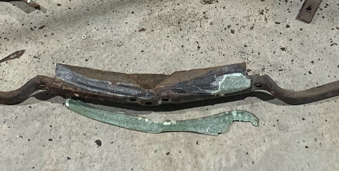

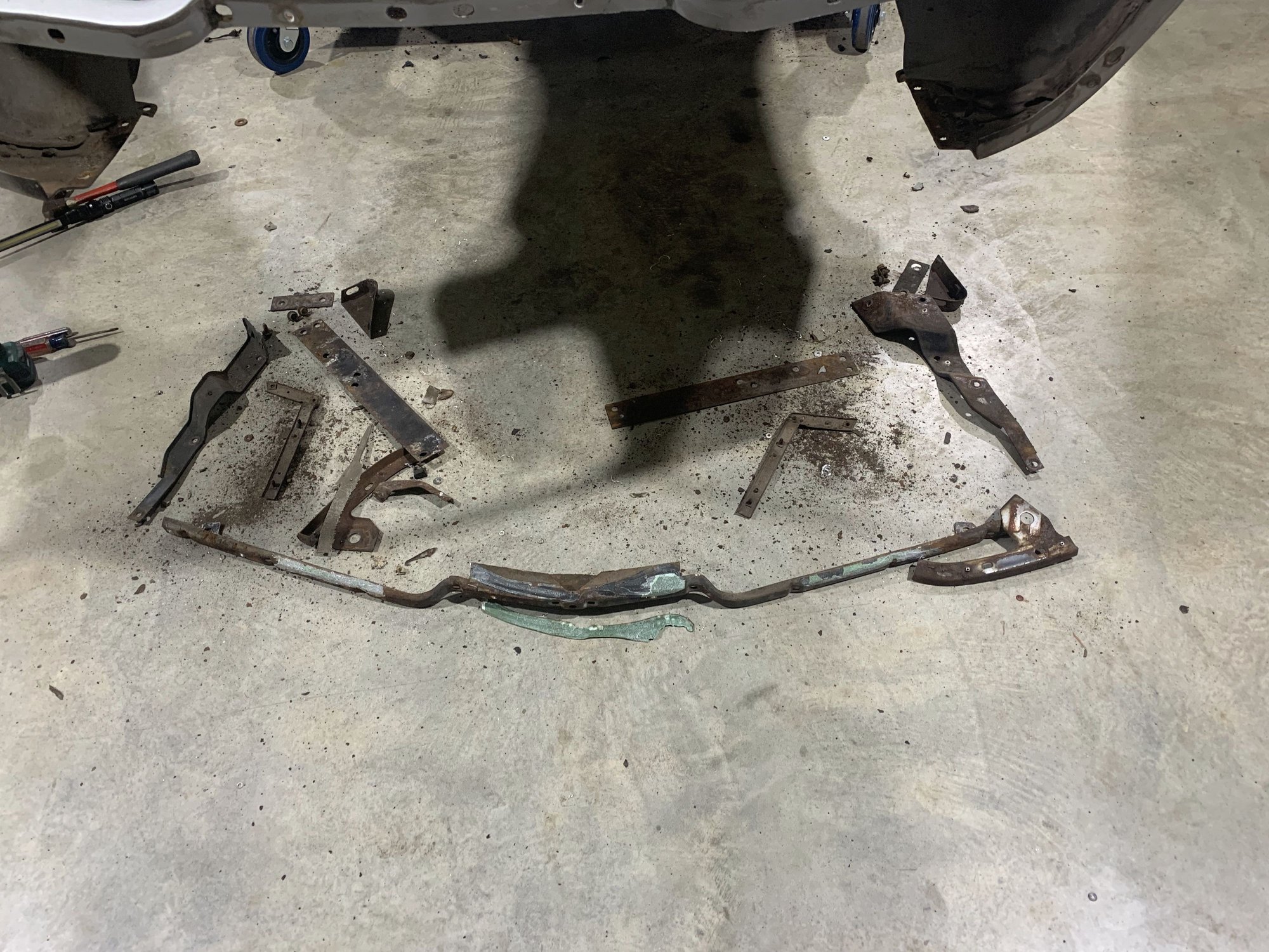

I have searched and I find info on the adhesive for the main support but not the upper bumper support. Why I am asking is because the adhesive that came off is still flexible unlike the panel bonding adhesive used everywhere else. Is it a different adhesive used on upper bumper support?

I’ve watched vids on front urethane cover removal and install. Some show the same hardware as yours, but not the goop. I don’t think its factory. Perhaps the bumper has been off before.

Thanks for the info. It seams that some have it and some don't. I am thinking I am going to use the same stuff that is used on the header bar. I have a few small cracks in the front of the nose and the bonding agent should help keep them from propagating. I am also currently replacing the floor pans which are bonded to the fiberglass in the front of the foot area. At least them I wouldn't be wasting as much of the product only using it on one area. Last I looked I think my local CarQuest has the SEM 39747 in stock. Its expensive!
