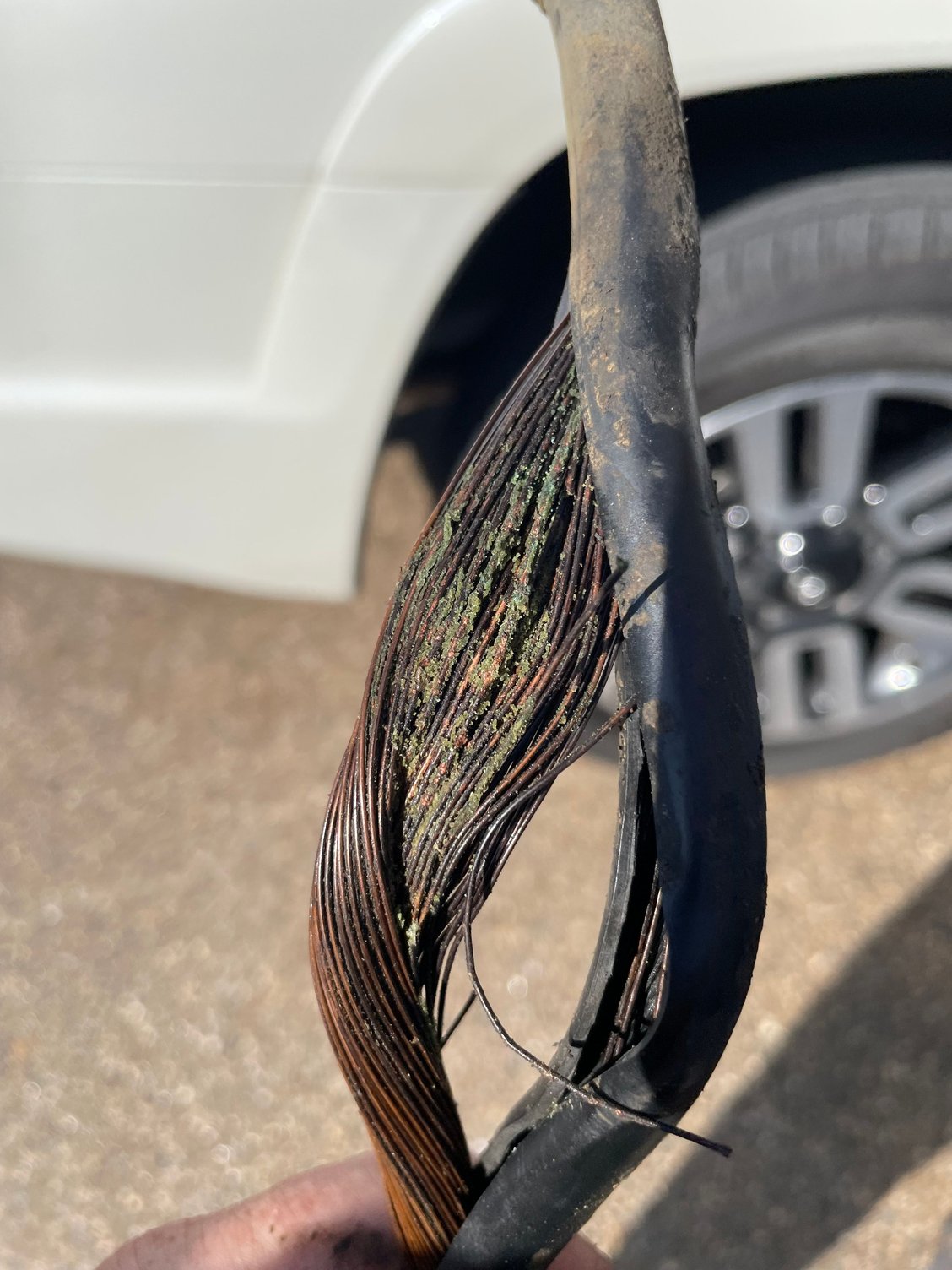

I was experiencing Heat Soak starter syndrome as well.......so I got me a new high priced high torque starter made by PowerMaster.... still had the problem. Was scratching my head and was pretty sure it must be the Ground from frame to starter after reading similar posts like this one.
So....I bought a new Frame to ground starter cable from Top Flight and also filed the metal surfaces where the cable attaches. For good measure I also wrapped my starter while I was under there.
Problem solved...several test drives up to temperature over the past couple days ....shut down.....start engine....drive a while....shut down.....ect....and it starts every time now.....
I cut open my old Ground cable today just to make myself feel better and I'm glad I did......
Take a look at the corrosion on the ground cable! JEEEZZZZ... Glad I changed it out.

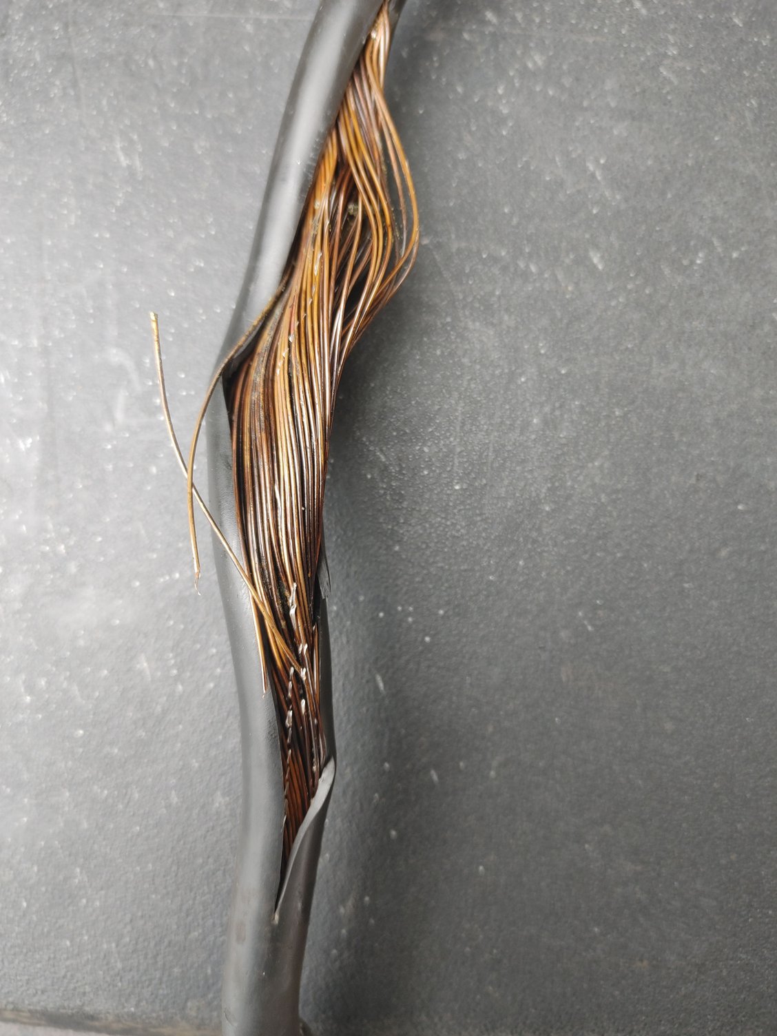

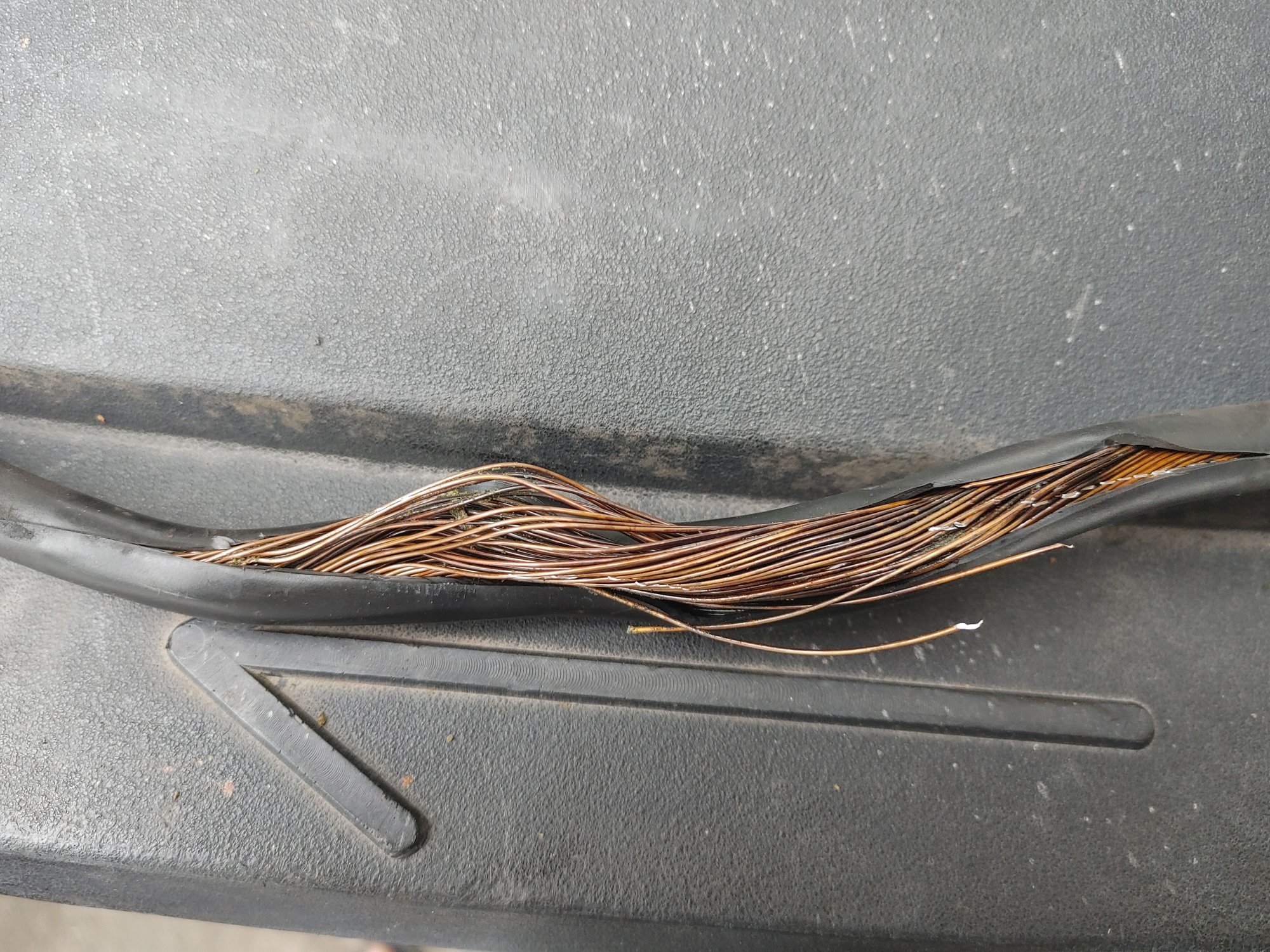

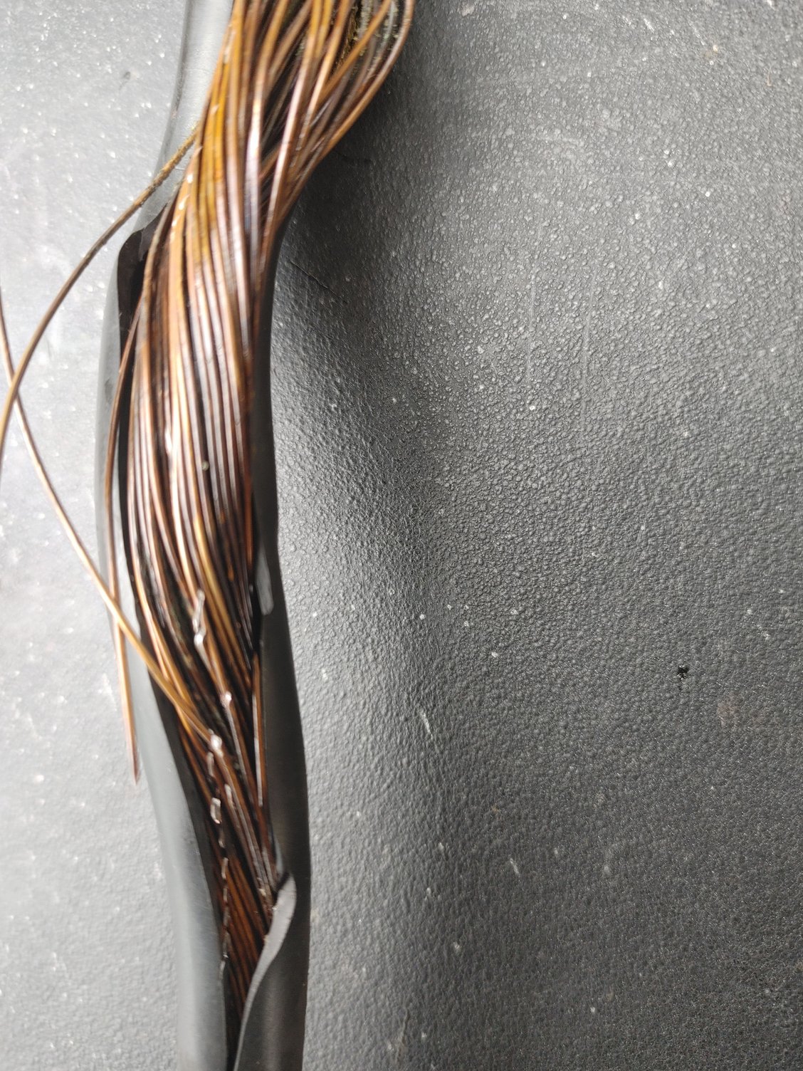

Not really sure if i have this problem solved it has rained just about evberyday since my inital post. i did however send the that Ebay starter back to the hell hole in climbed out of in China. I bucked up and bought the Summit Racing one for almost $200.00 also i changed the battery cable (negative engine ground). So far have not had any issues but we shall see. I cut open the cable for spits and giggles. it doesnt look terrible but is out of here regardless.
