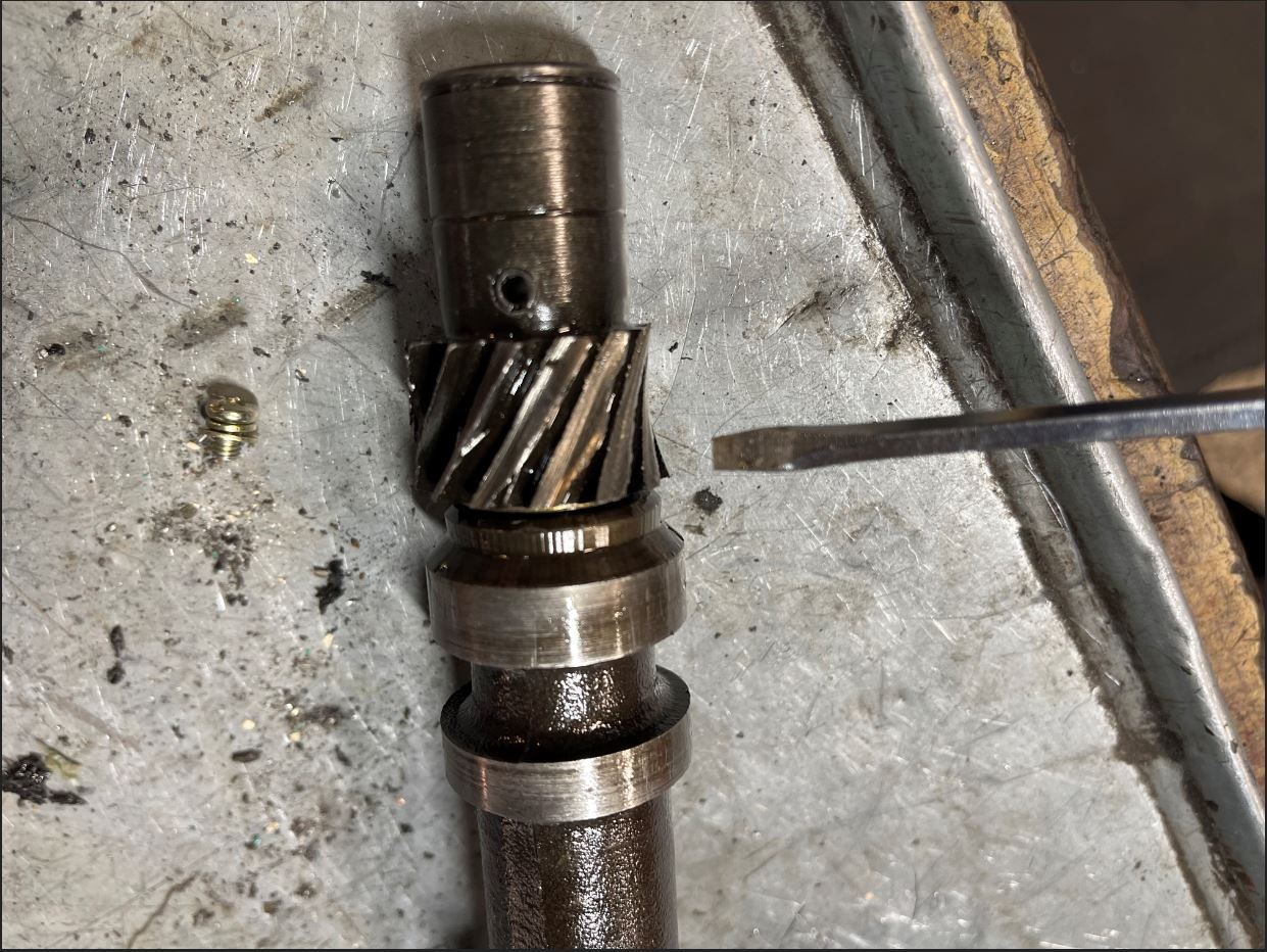

I have rebuilt my engine and added a cam. The cam has chewed up the gear on my distributor (original distributor to engine) twice now. First time I completely rebuilt the distributor and switched to a brass gear after reading it eliminated the problem. The distributor also had a pertronix kit added to it and an MSD rev limiter (6000rpm). Also, I still have a manual tach.

if that is a steel cam it may need a melonized gear. of course there are 2 distributor shaft sizes.

Yeah as others have pointed out you can't run a steel gear with a steel cam they have to be different materials. melonized or even composite gear would be better.. From what I've read brass wears out quickly... Even the brass tipped fuel rods have a limited lifespan on a street motor..(your fuel rod is another thing that may need to be addressed with the steel cam)

The composite gear works for any cam, and will last. Costly, but the last one you will ever buy. This.......https://www.summitracing.com/parts/cca-12200

A forum member here had the composite gear shear it's teeth off in use. The teeth are in shear vs the pump rod which is in compression.
So for the rod I'd say yes, and it's what I use myself after trying the brass tipped and having it start to mushroom in very short order.
The Gear...I don't know, not as comfortable running that just due to the shear action on it. So I personally run the melonized gear.

Thought I would share the pic of the sheering - this is the steel one.
