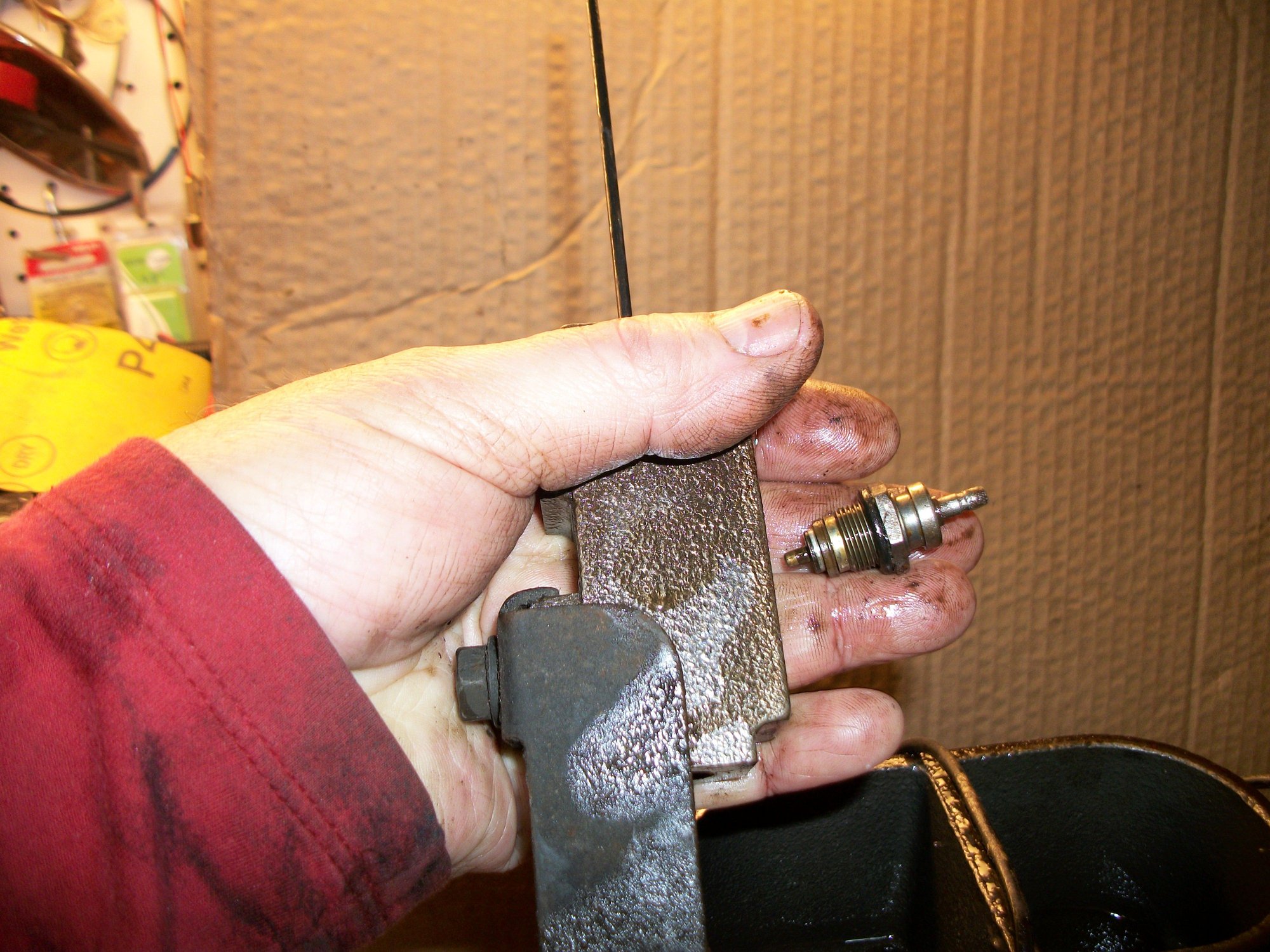

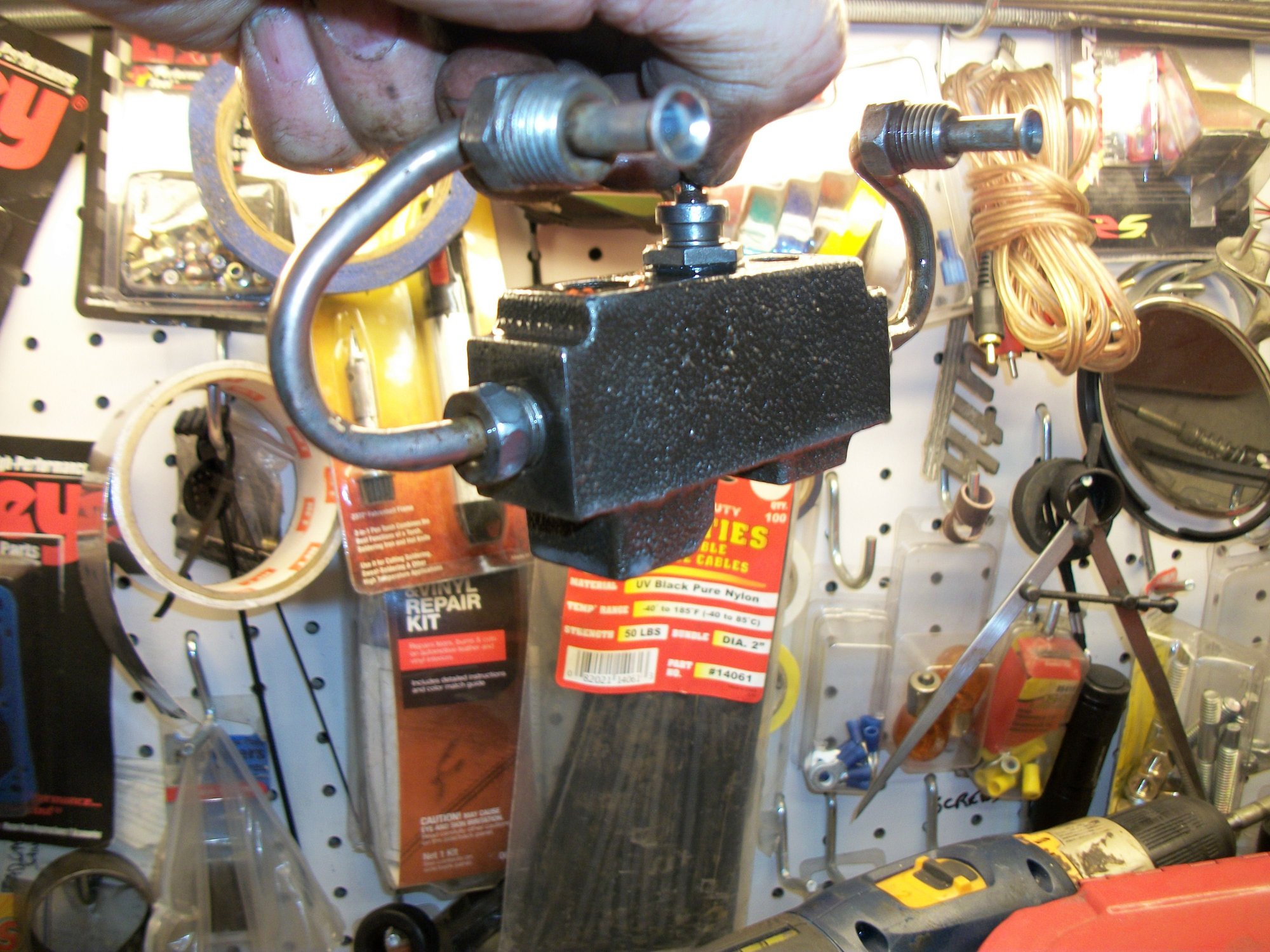

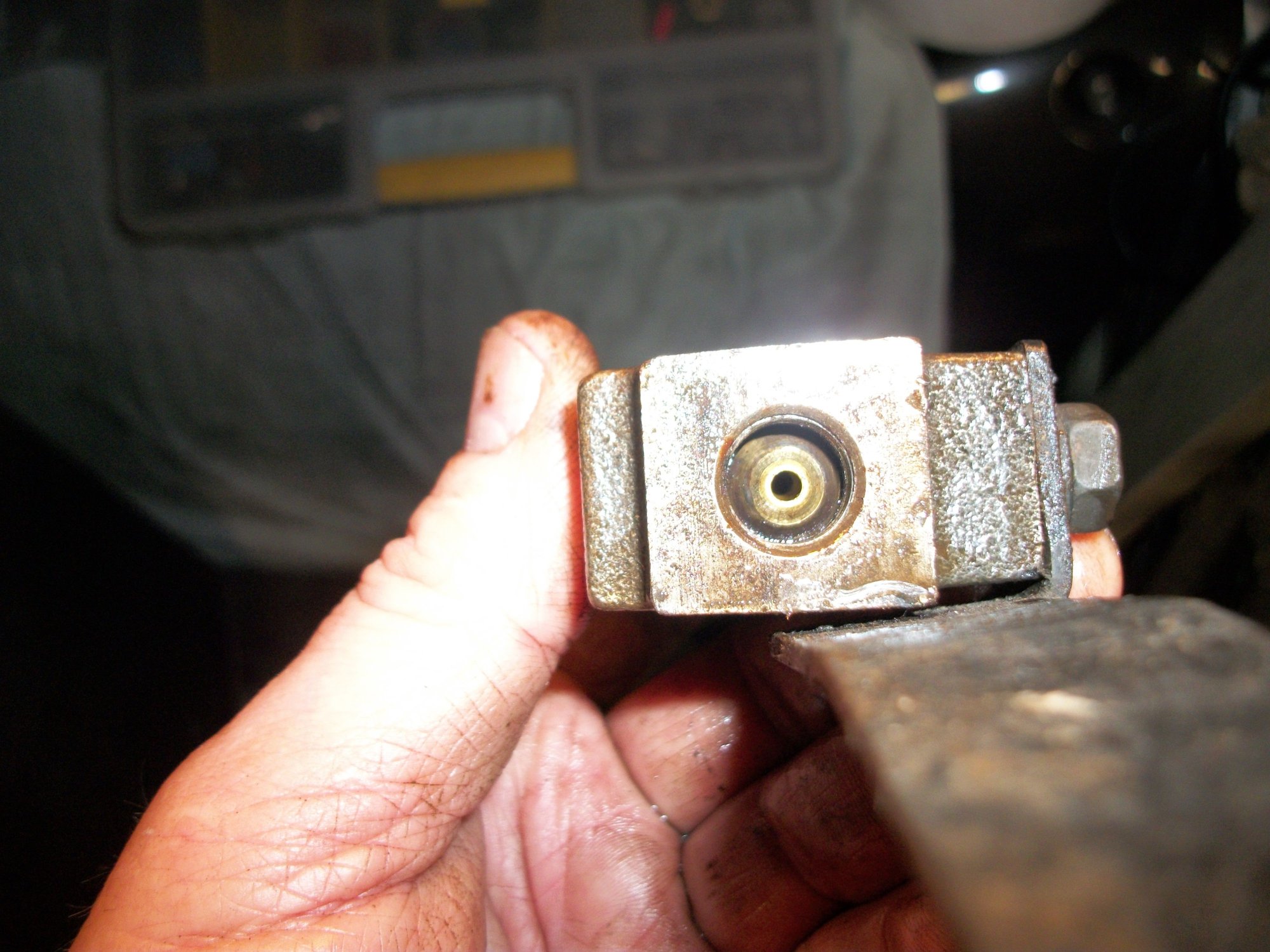

Cliff's Notes (Pics) Just for fun.......Distribution valve assembly.....
Switch that turns Brake Warning Lite On when there is pressure failure in the front brakes or the rear brakes....
Removable seat (same on other end of block)........
Symmetrical valve/piston...when it moves off-center the dash warning lite turns on...either the front brake subsystem is blocked OR the rear subsystem is blocked to prevent the master cylinder from losing fluid in both bowls......
It also will prevent you from bleeding the brake system completely when it is offcenter.
(What you see has been "cleaned"..the pieces were so gunked up it was hard to identify each piece or even see the o-rings).
The O-rings were like new and sealed well once I scotch-brited the bore.
I completely cleaned everything and recentered the piston/valve before reassembling the parts.
