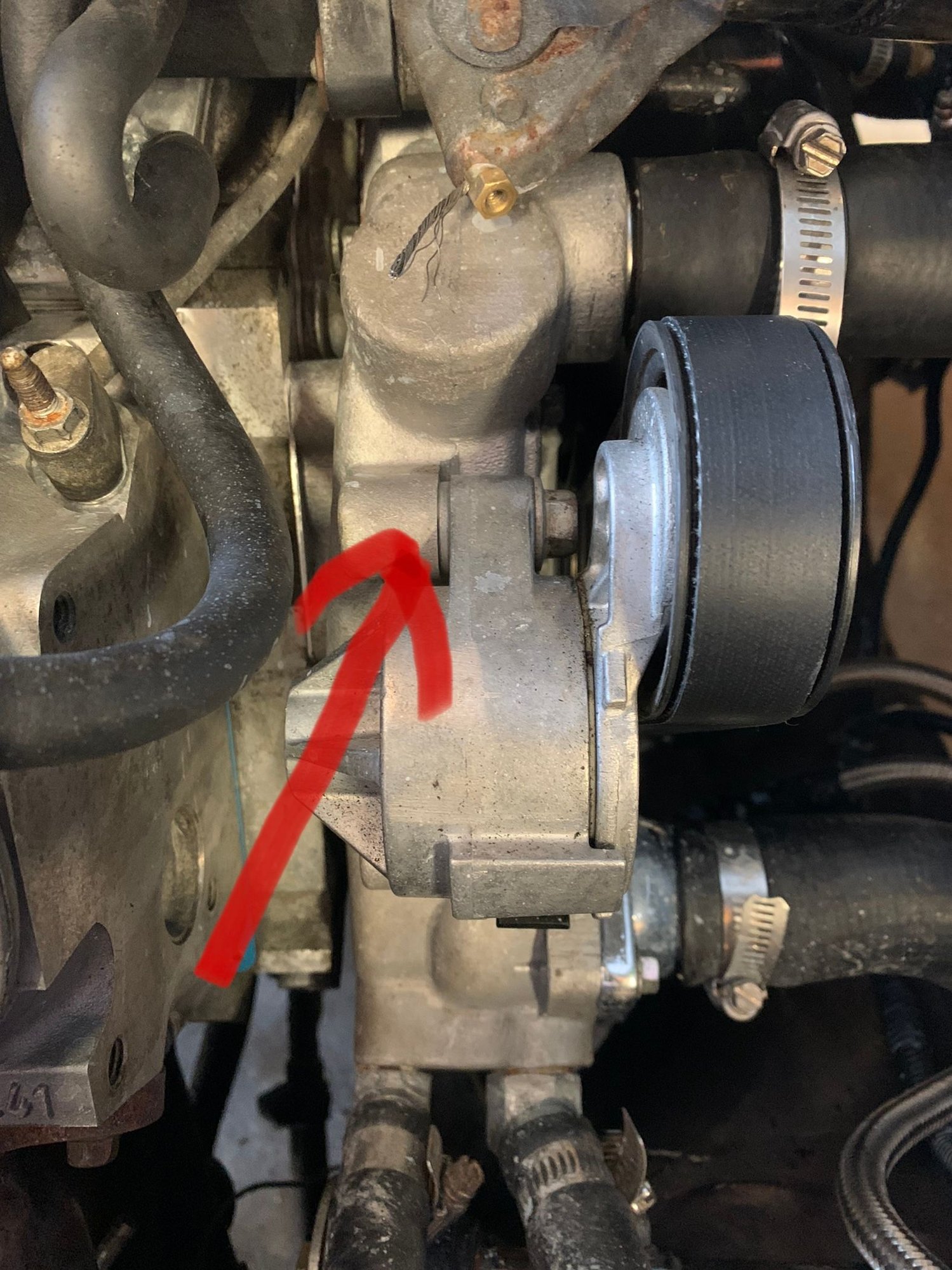

I had to make one more little adjustments for everything to lineup correctly and that is I had to shim the tensioner with a washer on both bolts to get it to line up correctly and how it looks pretty much perfect and there’s no squealing.
